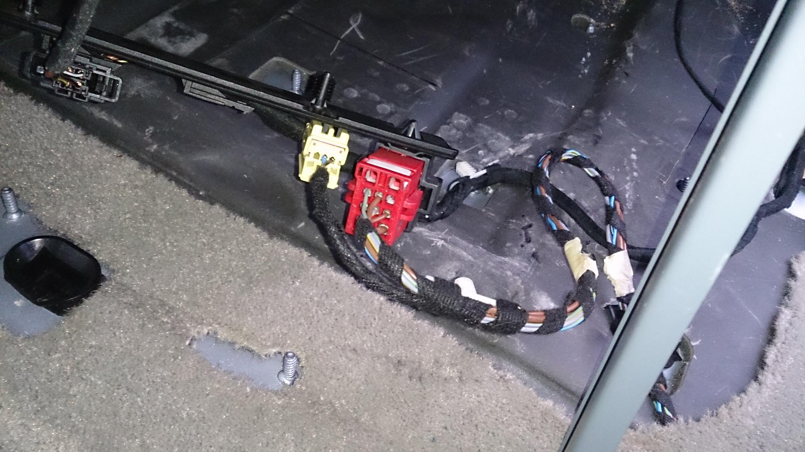

OK, pulled the seat up and I can see some connectors, can I disconnect any??
What are the chances airbag will blow in the back of my head as I am on my knees with open door looking under the seat??

2. It was a connector under the rear seat. It wasn't placed where it should originally so when I was cleaning rear screen I went with my knee on the seat and loosen something. It was one of them (see attached)
A bonus good news is that I found the problem with heated rear seats not working, not connected at all !!!
