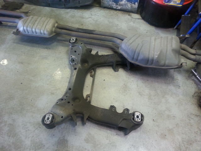

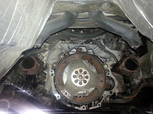

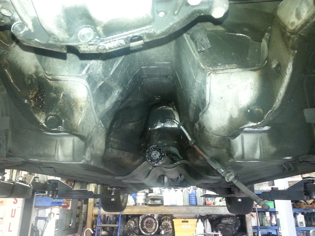

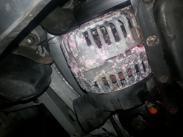

Further to my last post, you may recall that I elected to get my gearbox rebuilt by KSM in Carshalton. A chance conversation with a chap who lives next door to my beloved god-daughter in Horley resulted in us discussing my new steed, also known as a VW Bora which the garage have kindly lent me. He'd assumed that this was a 'new' car for me which put my nose out of joint somewhat so I indignantly replied that this was only temporary and the quattro gearbox had died a death on me, and that why he hadn't seen my Audi recently. Anyroadup, long story short etc. but he then recommended 'this place in Carshalton' and that his mate comes all the way down from Cheshunt, Herts to get his gearbox rebuilt and swears by their excellent knowledge and service. It turned out that they are one and the same garage, which was good to hear.
On the subject of the rebuild, my hub/drum had ripped the top lip/edge part of the metal about 1/3 of the circumference. He advised me that the crown wheel surfaces were slightly rough but should be OK for a while yet. That part alone would have been £600 or so from ZF. I needed a replacement driver's side engine mount because the one on the car looked as though it had been 'looked at' shall we say. One of the bolt threads was stripped, and the other one had been 'heli-coiled' so I ordered another one from the forum sponsors - nice work Carl!
Gearbox is all out and in bits on what I called their post-mortem bench. Thousands of O-ring/seals and clutch bands and other voodoo magic parts. Exhaust is off the car, along with the starter motor and other bits. It afforded me the rare opportunity to see those blinkin' drains either side of the gearbox as well as the ability to see where everything goes with regard to the rear silencer and drive/prop shaft. I spent about an hour there asking loads of questions and taking pictures.
I will attach the photos with basic titles/descriptions.

The chaps at the garage seem very knowledgeable and border on the anal - his comment about the crown wheel rough surface seemed a bit excessive at the time - but upon physically touching the surface, you knew he was on the ball. Not really anything visible to the naked eye but attention to detail is important. Gearbox casing was 'washed' so it stops all the grunt from getting everywhere. I was very impressed with that part because I thought I'd got a new gearbox casing if I'm honest.
He'd had the misfortune of having to rebuild an R8's box in the last month or so and willingly admitted it was a 'bit of a ****' (rhymes with twit) which made me laugh, but then I felt happier that mine was simply labelled more of a pain in the backside rather than a nightmare. The guarantee was only 12,000 miles or 1 year but my inner senses tell me that I won't be going back there apart from a transmission fluid change in a couple of years time. Hopefully. If all is well that ends well, I will certainly be giving these chaps the thumbs up from me. If other people do consider using KSM for gearbox rebuilds, then I'll be happy to have simply started the ball rolling, so to speak. Looking forward to the end of the week for some V8 luxury...
