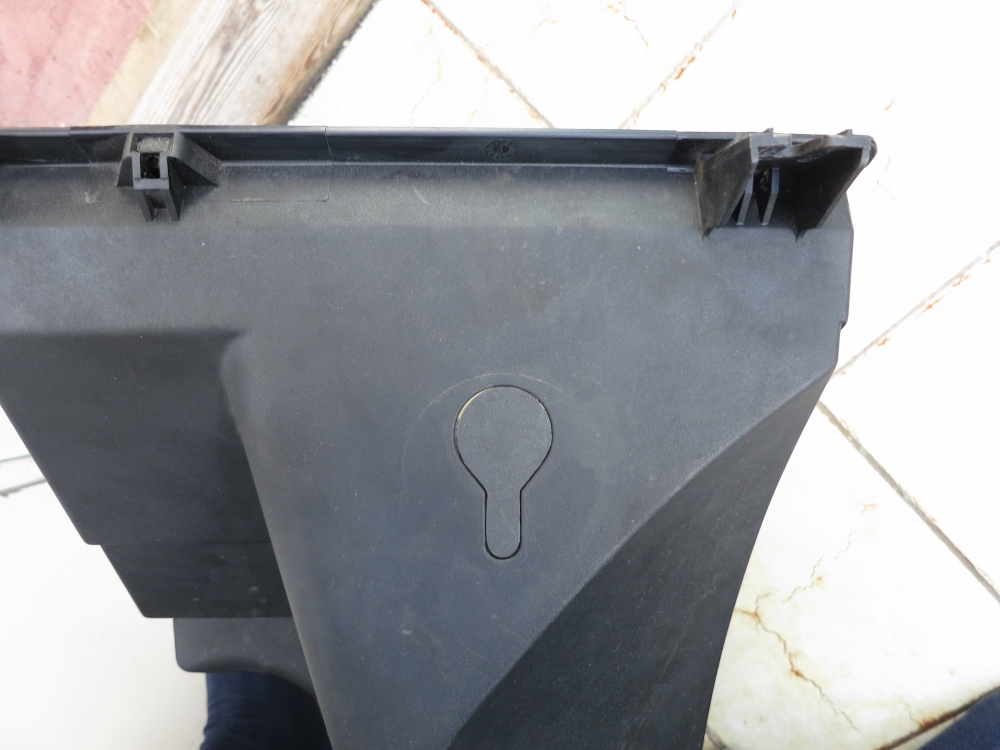

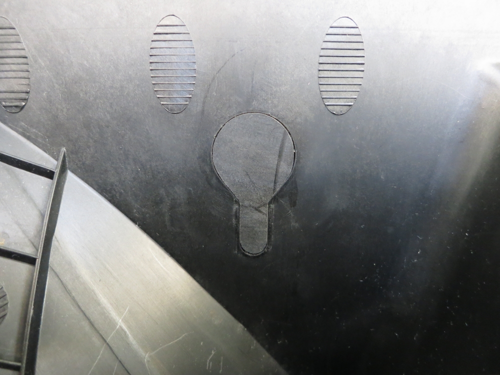

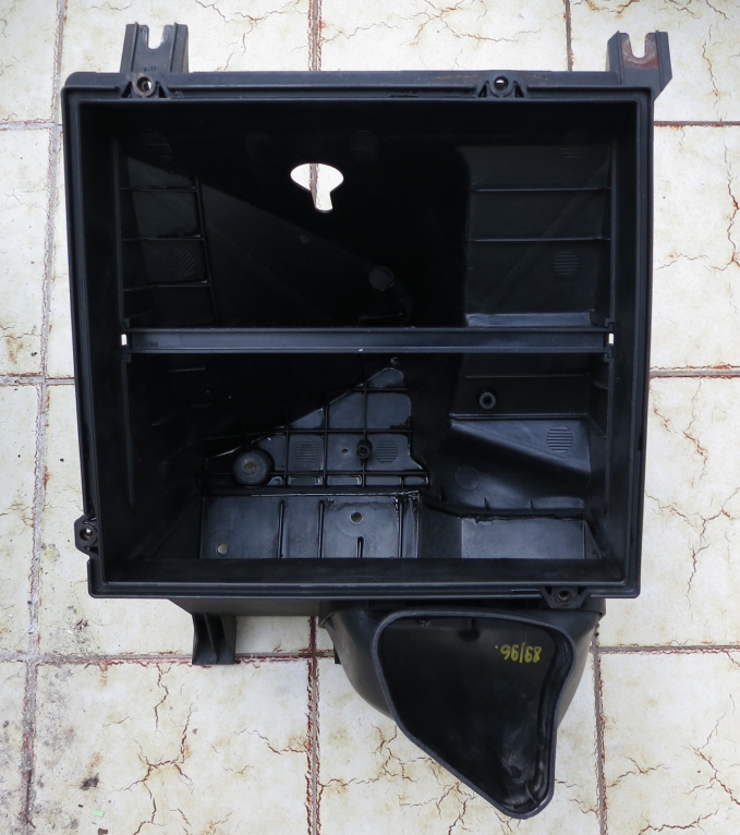

To complete the SAI delete, I thought I should close the holes in the airbox left by the air pump motor and hose. To avoid sucking in warm engine bay air.

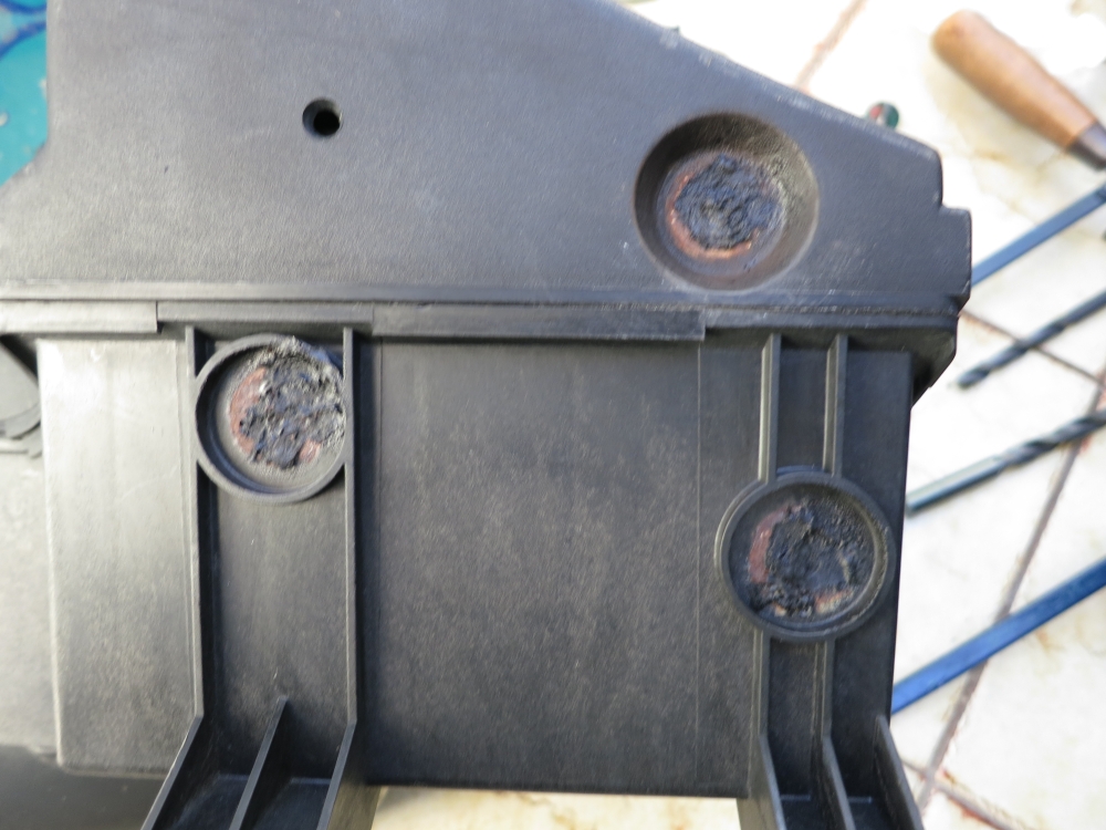

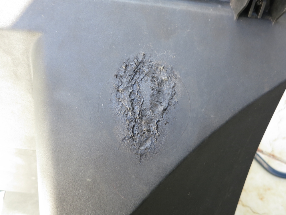

I decided, rather than glue, I would have a go at plastic welding. Well it didn't quite turn out as I hoped, it was very messy, probably because the nozzle is not meant for such small welds. Anyway the holes are closed thats the main thing.
Washed air box
dry fitting before weld
very messy weld
mounting hole welds
looks neater from inside
