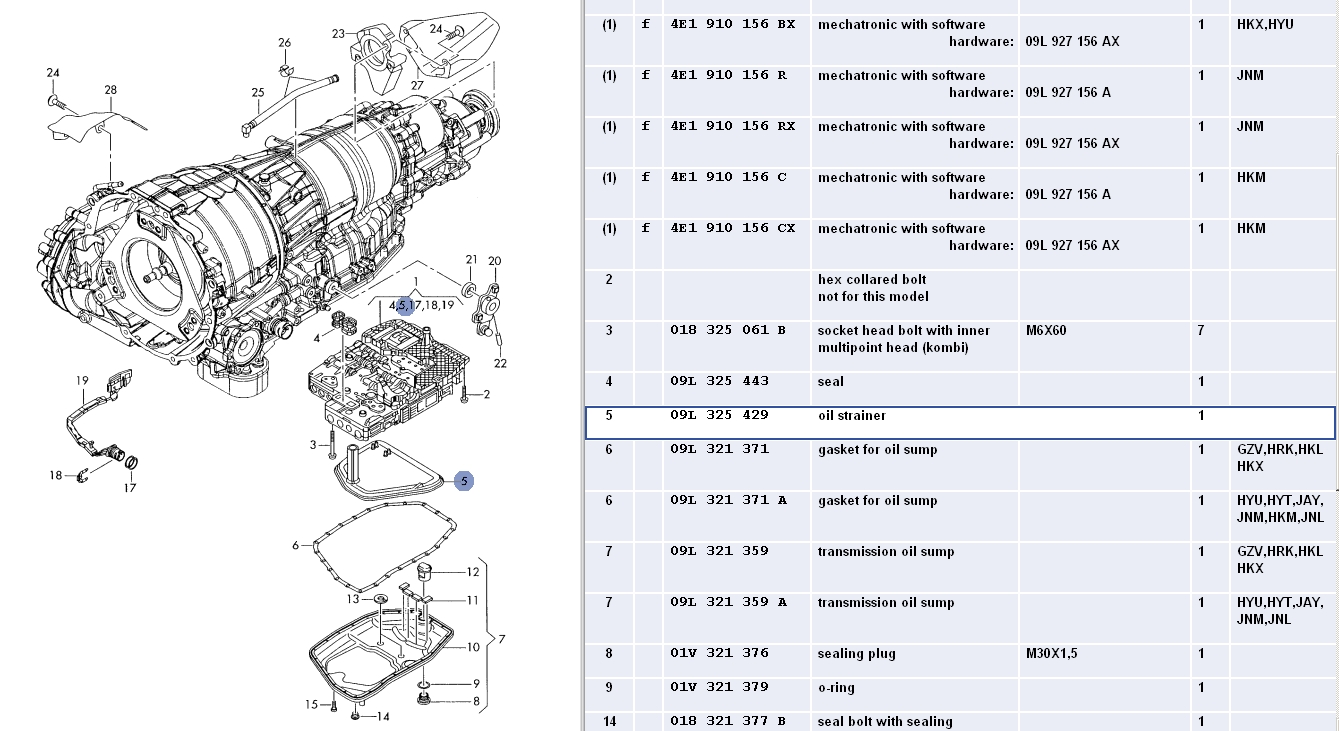

Gearbox is complete but they said they can't do the filter because its part of the oil pan.
So they did the oil flush and refill.
Anyone else heard of this or had the same done?

Old 2nd May 2014, 01:43 PM
Even if it was they could change it together with the pan.

Here is the diagram of D3 gearbox showing filter item 5, cost from dealer just under £40

...and thats another reason to go for a long trip and have it done properly, once and properly. You havent wasted money completely, but most of it I think.
For this price I'm thinking what oil they used?? Do you know??
