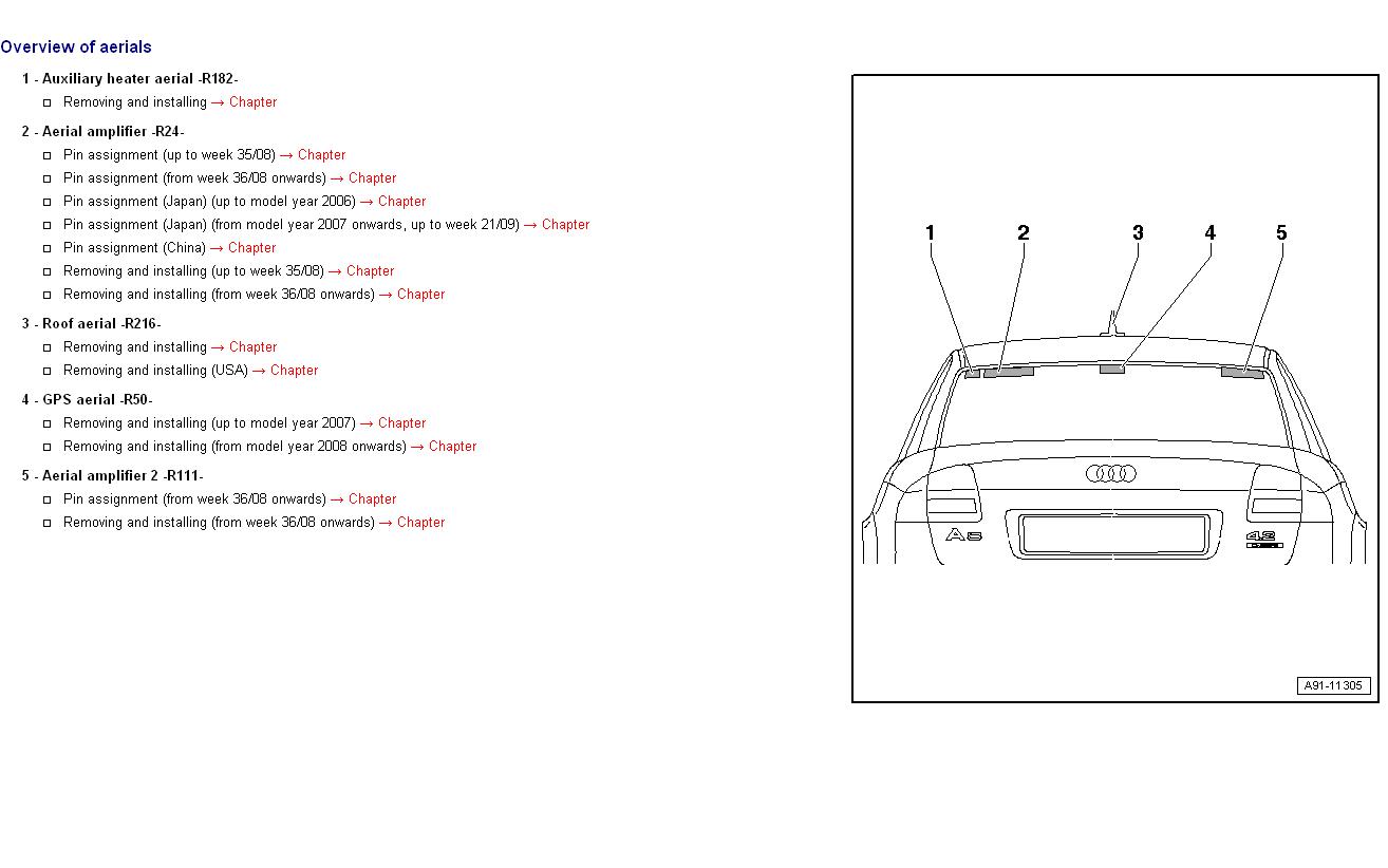

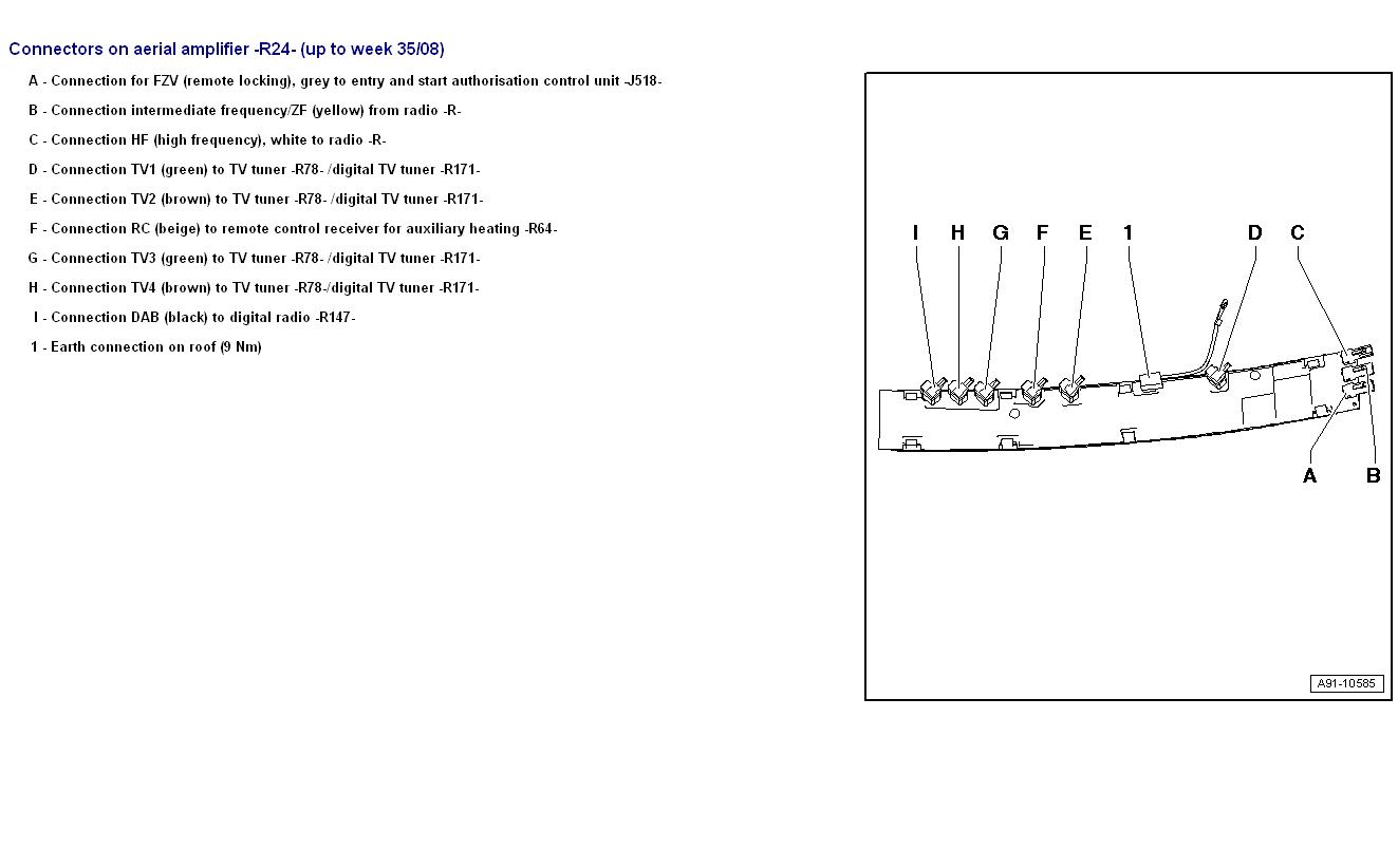

[center]
06 3.0TDI Quattro:
Options:
  #34
Old 5th April 2014, 09:26 PM
ID:	7702   Click image for larger version

the GPS is in the rear glass?
Interesting.
[center]
06 3.0TDI Quattro:
Options:
  #36
Old 5th April 2014, 09:52 PM
Posts: 8,545
No, that mostly shows where the amplifiers are, not the actual aerials.
GPS aerial is the small sharks fin on the roof.
