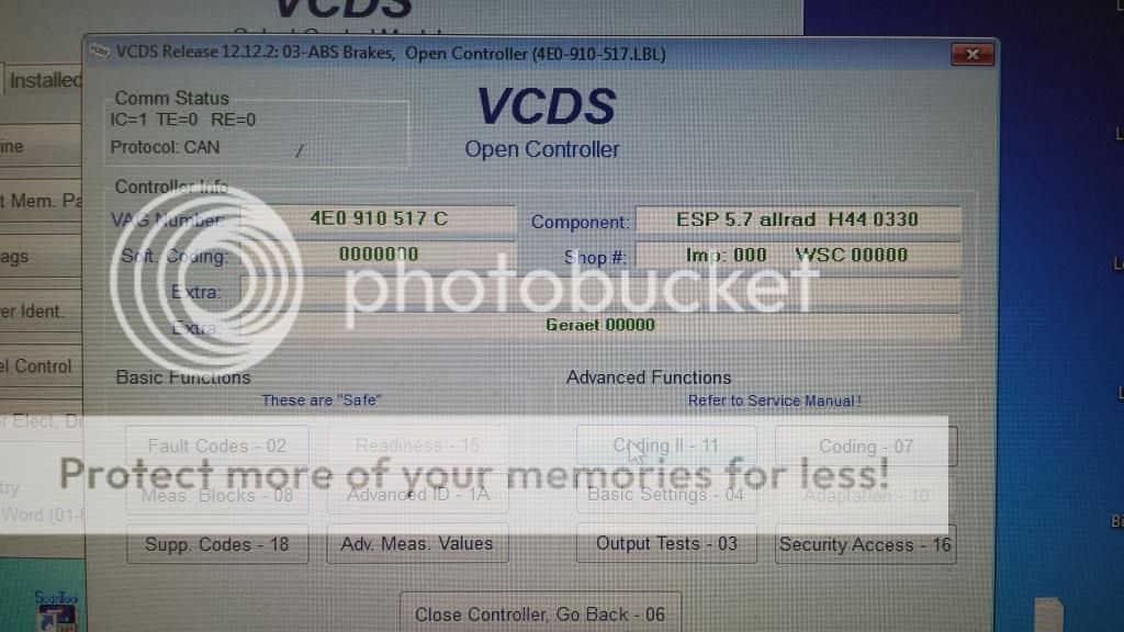

Ok so the BD ..plugged in now displays as a C not a BD...
But it dose say BD top line and C bottom line ... just cant log in because I have to guess what car it is
Yes sorry no idea where E came from I dont have that at all

Did we say a C works and was later replaced by the CC
Old 23rd June 2014, 06:31 PM
Bottom number is the Software version NOT the part number, if you look middle 3 numbers are different, 910 instead of 614.
Old 23rd June 2014, 06:36 PM
Your software should be 4E0 910 517 A (VAG Number)
If you go to advance ID you should get the part number (BD for example) which is 4E0 614 517 x or xx

Yes and indeed it had come up in advanced id as a BD unit
4E0 614 517 BD
4E0 910 517 C

Im struggling hear ...4 units later and im no closer to home ..
It let me log in under a LWB W12 .. re coded it and now its only taking coding .0007637 and thats a W12 .. if I try my lwb 4.2 i get an error message saying out of range

Well, yeah, it's a bit of a struggle due to wrong PNs being installed, but heads up, we will get there
Hold on, so you logged in to W12 LWB, coded it so what's wrong with it??
Do you get any errors??
Any lights on the dash??
So it does accept coding or not if you said you recoded it??
