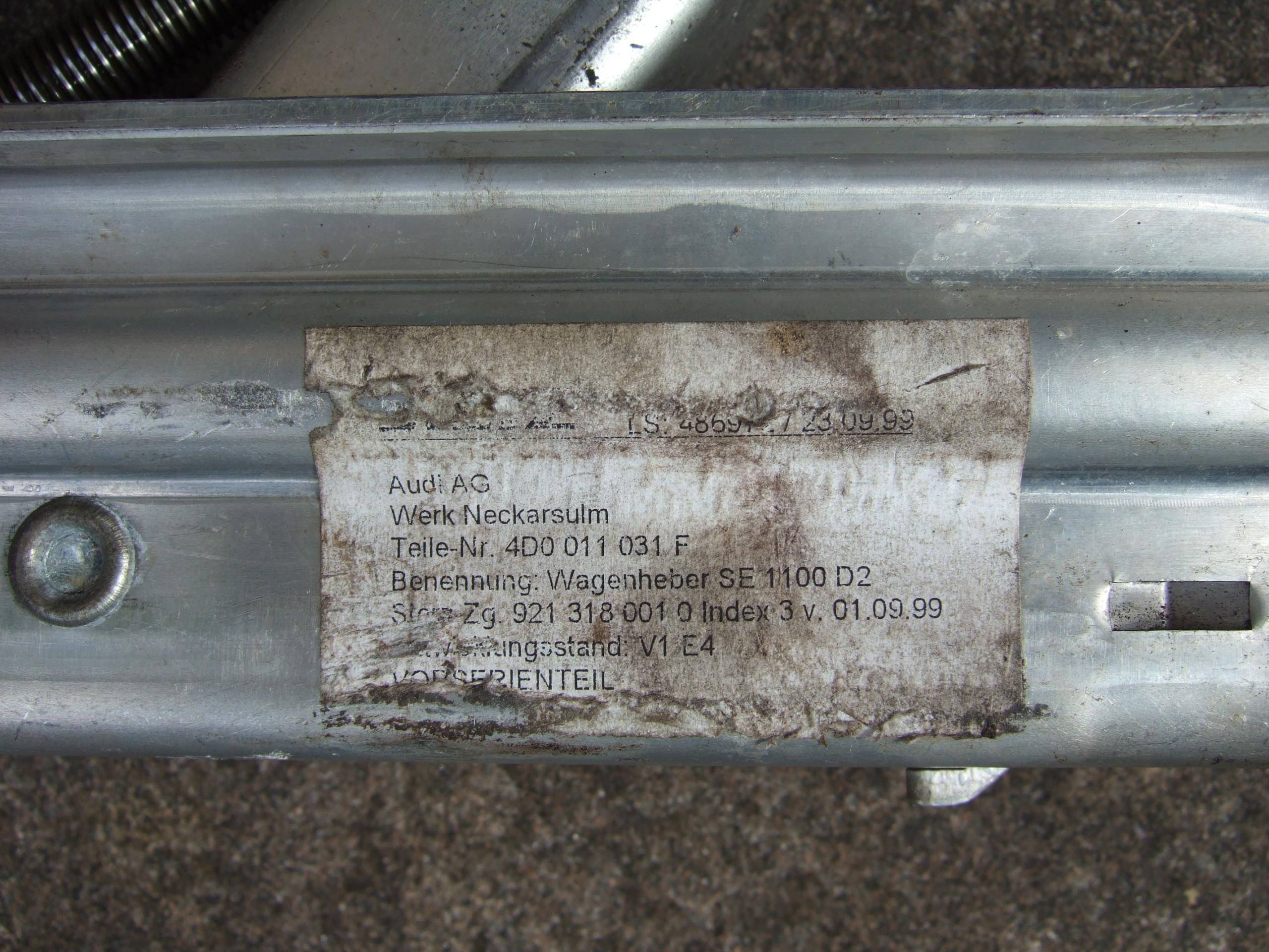

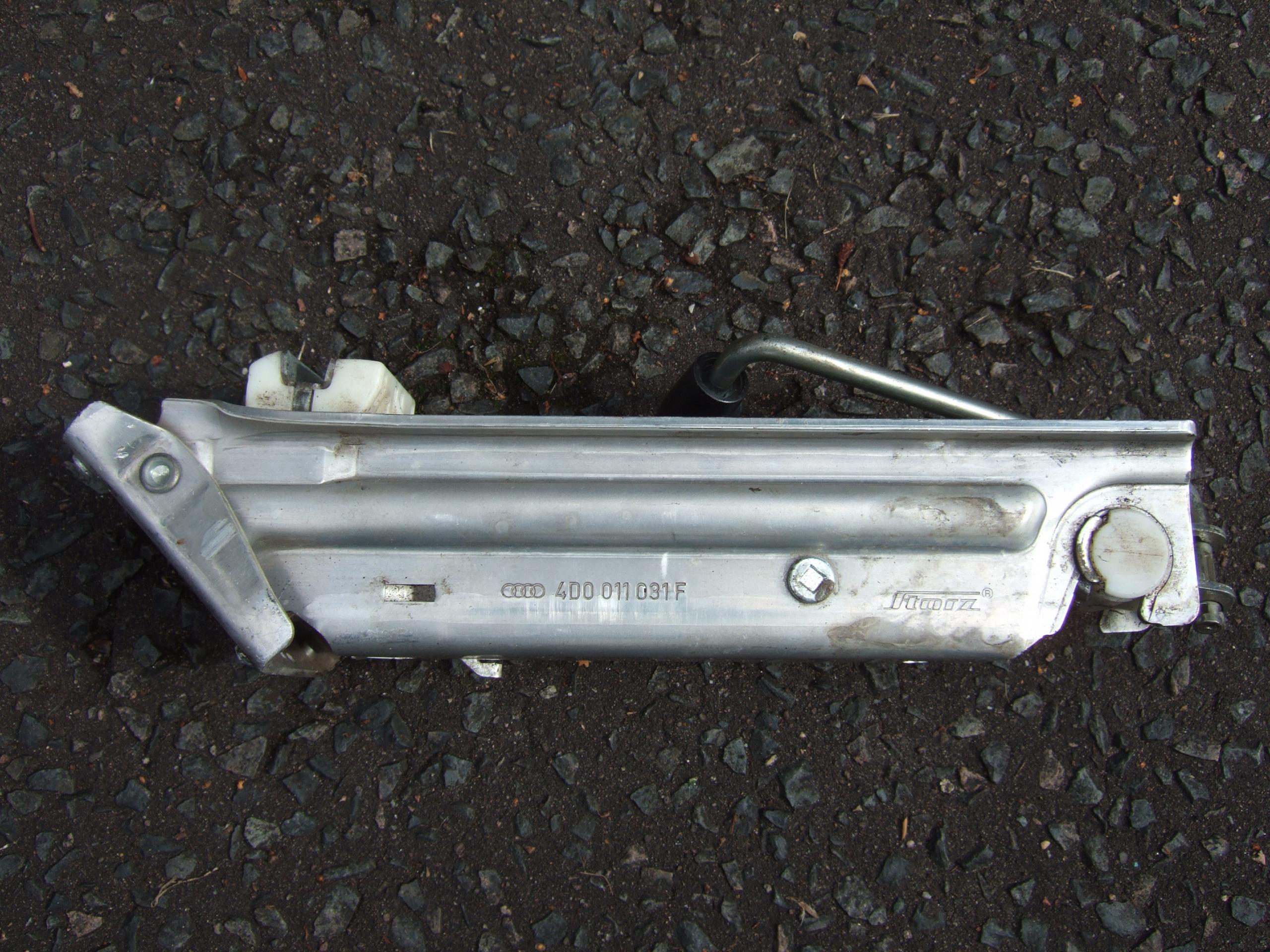

Was just looking at that thread again too. Adrian E posted:
"Looking on ETKA there are 4 part numbers for jacks, depending on year and spec, as follows:
Up to chassis number 4D-x-005 950 is 4D0 011 031C
From 4D-x-005 951 is 4D0 011 031D
There are then 2 alternatives for the heavier cars. Jack listed for the 3.3 diesel and 6.0 W12 is 4D0 011 031F
Jack for armoured model is 4D0 011 021B

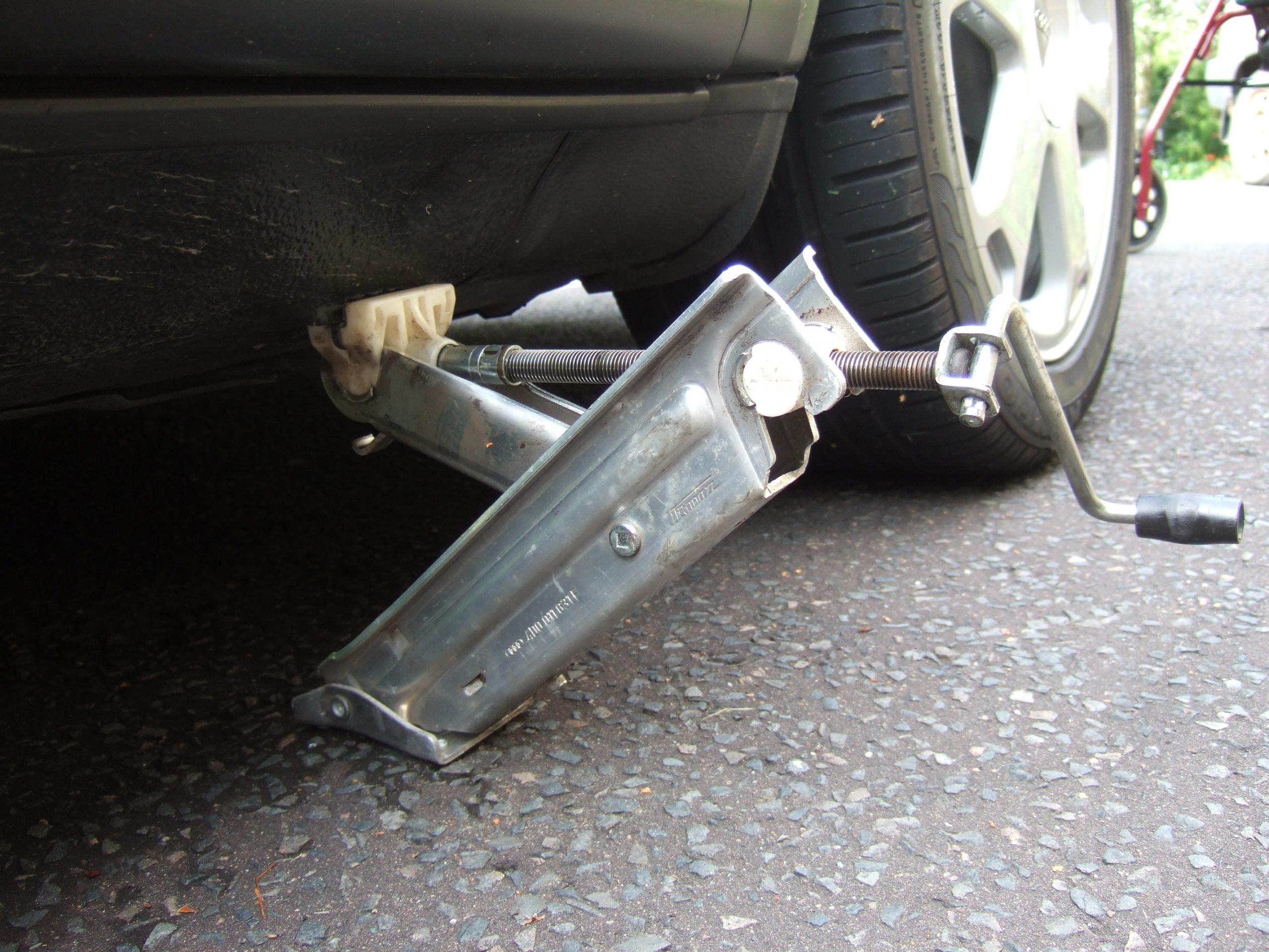

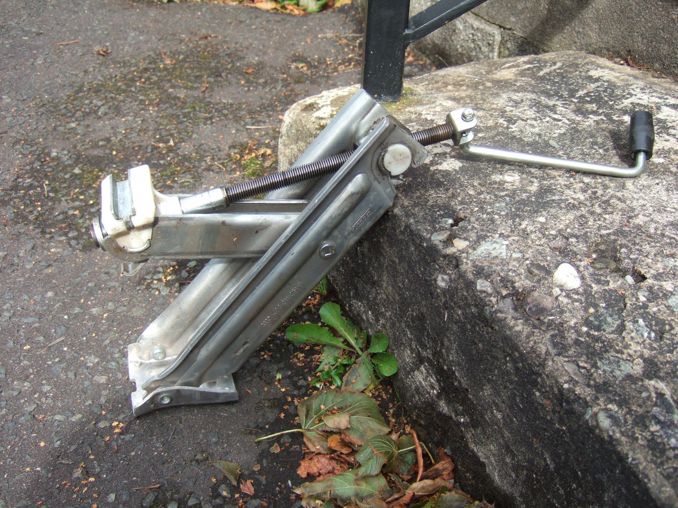

The 3.3 diesel/W12 jack (4D0 011 031F) i have got is straighter and just heavier gauge metal. Unfortunately I havent got any shots of the (unbent) standard jack but I will post some of the 031F asap.

Here's pictures of the 031F version for diesel/W12 D2s. I consigned my standard jack to the bin so you'll have to wait for The Laird to post piccies of one of those.
