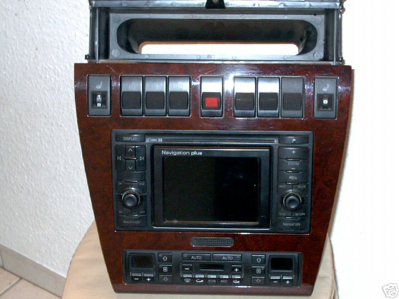

Sorry, I should have been more specific - I was referring to faclift cars... The RNS-C was fitted to about the first years worth of facelift cars, before the RNS-D came along.
A squarer double-din version (no sloping sides) of the RNS-C was fitted to some very late pre facelift models.... (pic attached)
