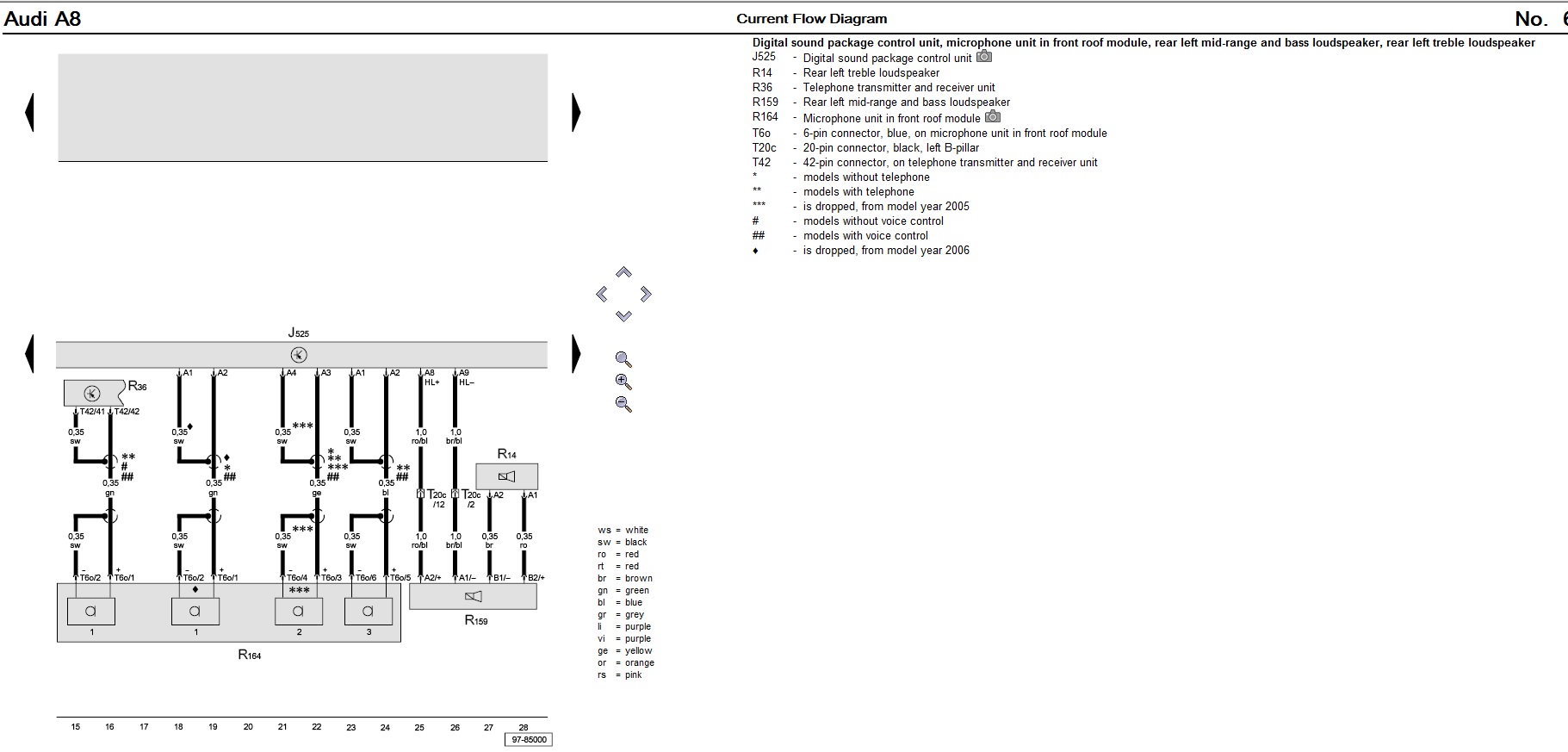

Old 24th October 2014, 03:50 PM
This looks like it although plug colour is wrong, guess you can double check by popping speaker with battery

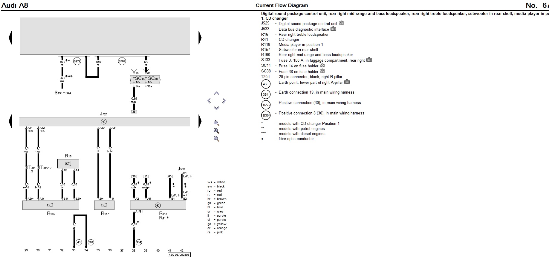

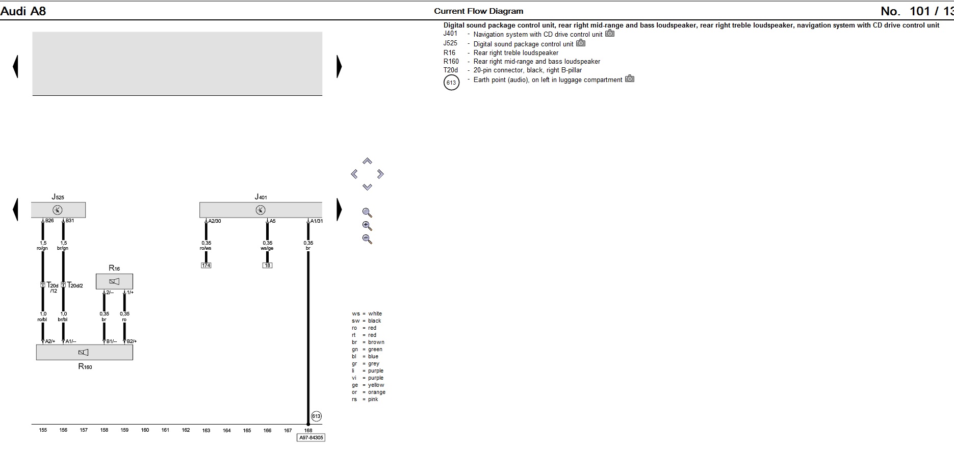

Old 24th October 2014, 04:20 PM
See attached
