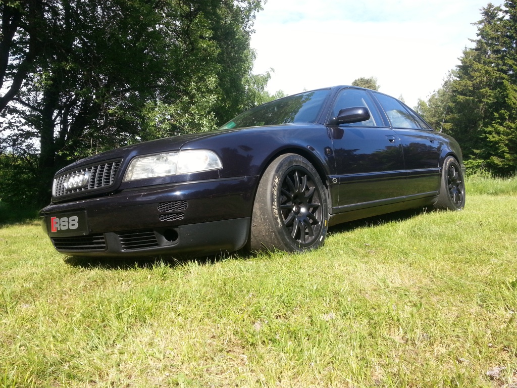

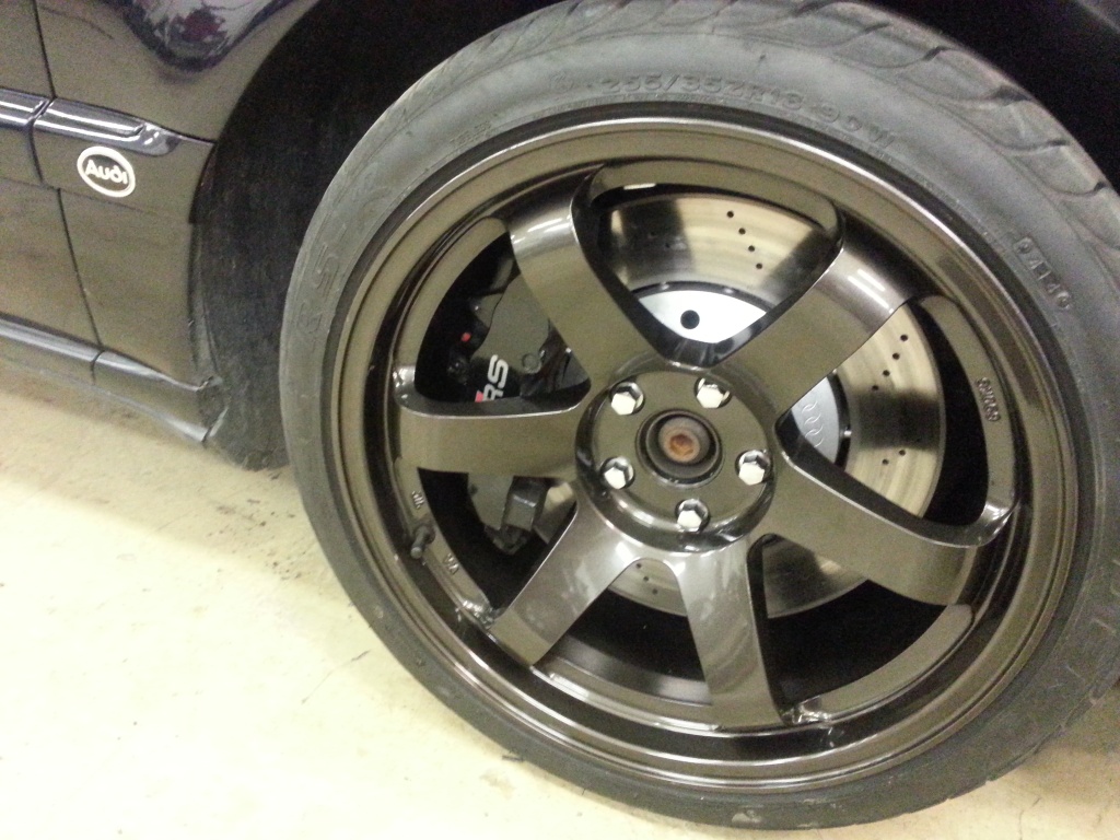

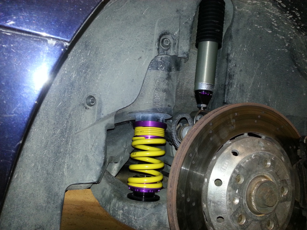

But I also have:
Custom built KW Competition 2-way
RS6 brakes,
Density Line lower controls arms and adjustable upper control arms with spherical bearings in front and home modified rear lower control arm with spherical bearings and aluminum rear sub frame,
LSD diff in a rear RS6 housing.
and more.
And of course my RS6 V8 biturbo engine that helps me to have fun

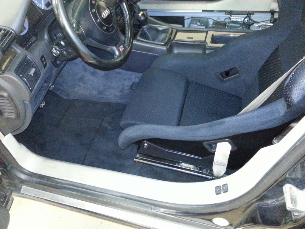

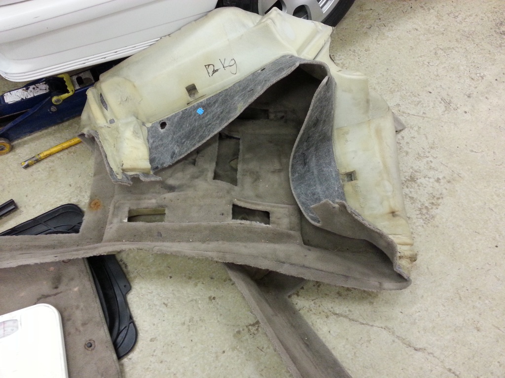

I bet you saved a lot of weight with racing front seats, just out of curiosity do you know the weight of your racing seats?
I know the S8 standard Recaros weigh 34kg each which is a lot.
Also I think the rear seats weigh 30kg so that's a lot you saved there too.
Impressive!
Old 3rd January 2015, 05:55 PM
RallyQuattro RallyQuattro is offline
Join Date: May 2012
Location: Sweden
Posts: 80
RS4 ?
I think they were at around 10 kg each with mounting brackets
The big thick floor mat weighs 12kg
Now I just have a thin "speaker fabric" on the floor to cover all cables.
