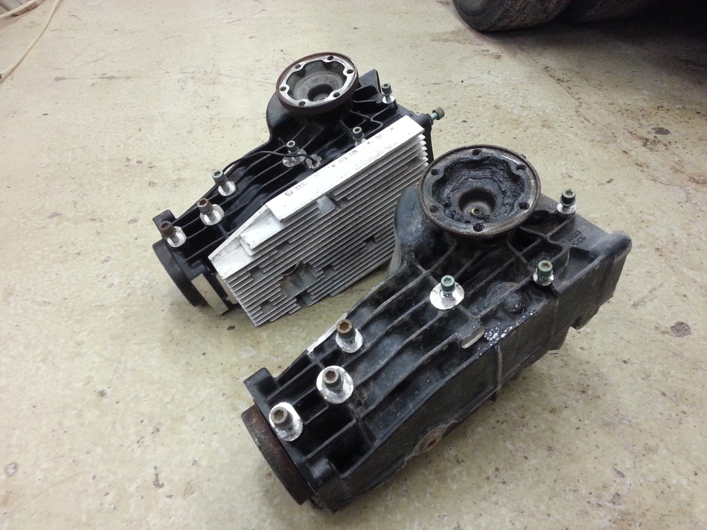

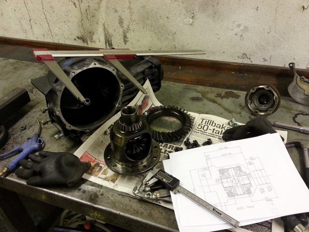

Also really interesting you installed a RS4 LSD rear diff, was that difficult to do or is it a more or less direct bolt in to S8 subframe?
That's one thing I would really like to do also.
  #40
Old 4th January 2015, 11:03 AM
RallyQuattro RallyQuattro is offline
Join Date: May 2012
Location: Sweden
Posts: 80
Why do you write RS4 every time?
RS4 and RS6 are two completely different cars
RS6 rear diff with mounts fits directly.
But there is nothing special inside RS6, It have the same open diff as A8/S8 the only difference is the cooling plate on the underside.
What I have done is I have bought an LSD and fit it inside my RS6 diff, but that you can do also in your A8/S8 diff
I have also installed a temp sensor on my RS6 diff.
