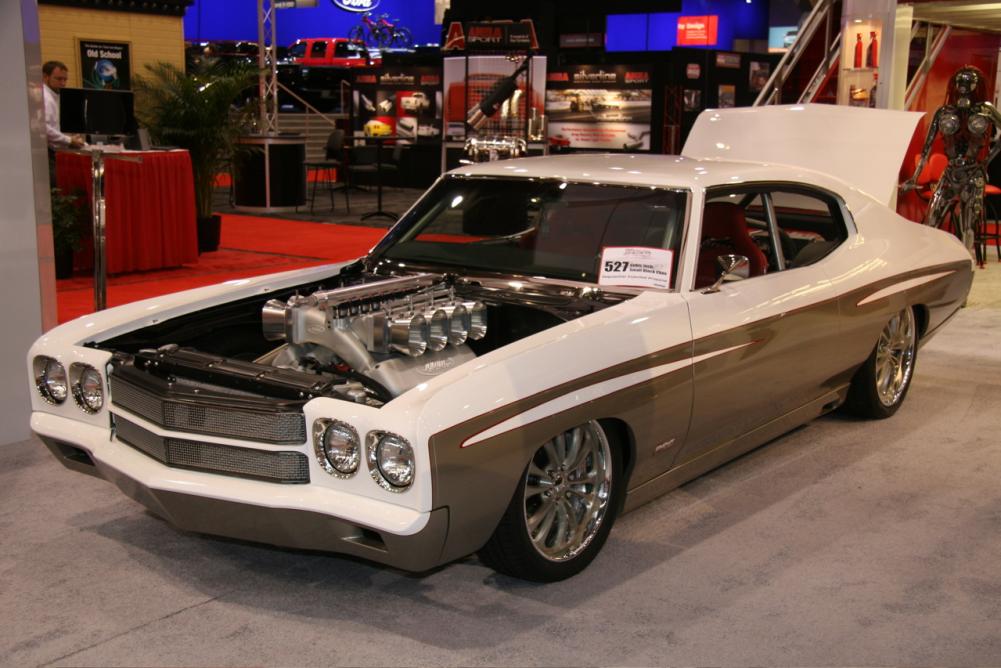

hey mike, as i know you prefer gas/lpg over petrol and are looking for more power, look at this intake manifold setup made in new zealand. it's producing 1000hp on propane. compression ratio is 13.5 to 1.
and if you want to lower your compression for a supercharger, 034motorsport has 9.1 pistons for our 077 4.2's on the shelf, although a bit steep at £1300. john
