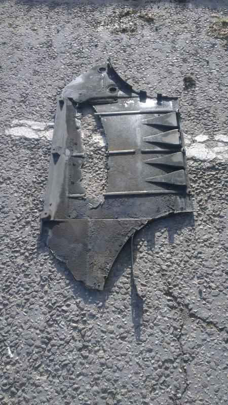

Looked to the front and noticed the engine tray was hanging down with a massive hole in it.
I guess that's where the bangs was coming from as the road ripped holes out of the tray.
I got what little tools I had out of the boot and proceeded trying to remove what remained of the tray.
Luckly the front was already down and the 4 on the side in the arch.
This left the 2 at the back.
Unable to get under the car, I put it in to lift mode.
With the final bolts removed I pulled the tray out.

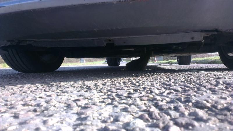

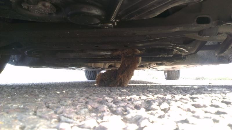

Had a quick look underneath to make sure nothing else is hanging down and clip the bumper flap back up, I was presented with this.
Wondered what it was. Could it be the damper from the tray as that is gone?
Nope.
It was road kill.
The fallen tray has scooped up road kill and shoved it between the gearbox and the metal beams under it.
I had no gloves on me, so no way I'm removing it. I thought I'd just drive down the road and hope it shoots out the back.

I found out what happened.
The metal clips that you bolt in to rusted out. The pins in the clip that the bolt uses was gone and caused the bolt to fall out and out the tray to fall on the floor.
Make sure you check your tray bolts and clips.

You forgot to mention the outcome of the roadkill, was it gone or just ground down a bit?
Old 2nd February 2015, 11:14 AM
ScottD3's Avatar
ScottD3 ScottD3 is offline
Location: Plymouth
Posts: 1,888
There was no sign of any ex-animal on the underside of my car when I got it on the ramp.
