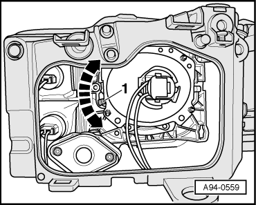

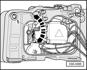

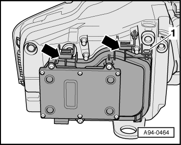

There are two ways, depending which headlights are installed in your '8.
Manual adjustment. Remove the cover and see if there is a leaver. Move this leaver to its opposite position. This will remove the 'kick up' from your beam pattern.
Remove cover
For Xenon
For Halogen
Second method, if there is no leaver, is by using VCDS (or a visit to the Dealer/Indy) to enable tourist mode.
http://wiki.ross-tech.com/wiki/index...8Xenon_Plus%29
or
http://wiki.ross-tech.com/wiki/index...ptive_Light%29
Edit: BE VERY CAREFUL DUE TO HIGH VOLTAGE!!
In the service manual Audi even suggests to disconnect battery ground.

Excellent post Matty. Much appreciated.
