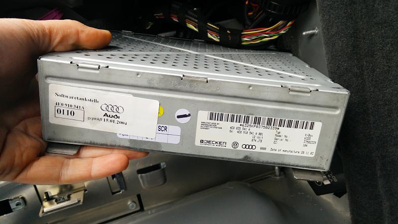

KBox Radio - 4E0 035 541 A

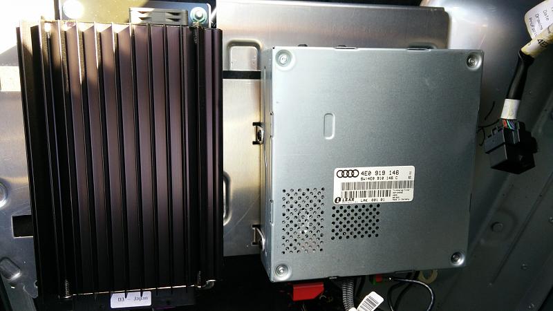

TV Module - 4E0 919 146
Amp module - couldnt see a PN but is labelled "D3 Japan"

The only real issue I foresee is going to be component protection.
Apart from the TV tuner and AMI all the other bits of the MMI have CP and will require a friendly main dealer or a local independent who has hookup to Audi HQ to remove it.
Without removal then things either do not work at all, or have limited functionality. For example, only one audio channel from the Bose amp, the CD changer will only play for a very short while before stopping etc.
I guess you could get away with replacing the tuner module and the Nav box, both have CP which would need removing.

This is a very interesting conversion. The radio and nav unit have the same hardware code as European versions (although the revision suffix is missing from the Nav unit from your description). I'm sure the software version may differ from our European cars. You should invest in VCDS to scan your car fully so we know exactly what you have installed. It may be a case of coding each module to tell it what region it is in, but that is just a guess for now. And as Mannyo said, let's hope CP don't kick in.
ID:	10211   Click image for larger version
ID:	10212   Click image for larger version
ID:	10213   Click image for larger version
