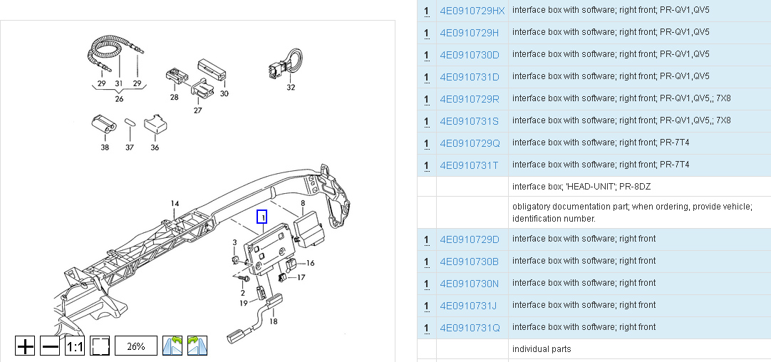

Just throwing out some questions here, is the MMI Interfacebox country/region specific? And if mattsimis has bricked his unit it's not a bad thing because he would need to swap this to a European part? There are many different units available depending on TV parking camera etc... I noticed from your photo you have 4E0 910 729 D. It's listed half way down below the 8DZ code which indicates your J523 is Japan region specific.
The PR codes are:
QV1 = TV reception
QV5 = TV reception and digital radio reception
7X8 = Park distance control, front and rear with rear view camera
7T4 = Navigation system for China
8DZ = Radio "HIGH" Japan
Also, it is worth researching if there are differences with his Module J533 to a european car?
Edit: in my research I couldn't find anything that correlates to region, only equipment such as ACC.
I can't stress how useful it is to have a full VCDS scan so we can compare your car to ours, it's a pity your car isn't scanning correctly.
Used analogue radio and navigation units are fairly cheap here and no doubt these will need to be replaced, and maybe some other units within the MOST loop (J533 & J523???). I am sure our sponsors can do a tidy package for you.
