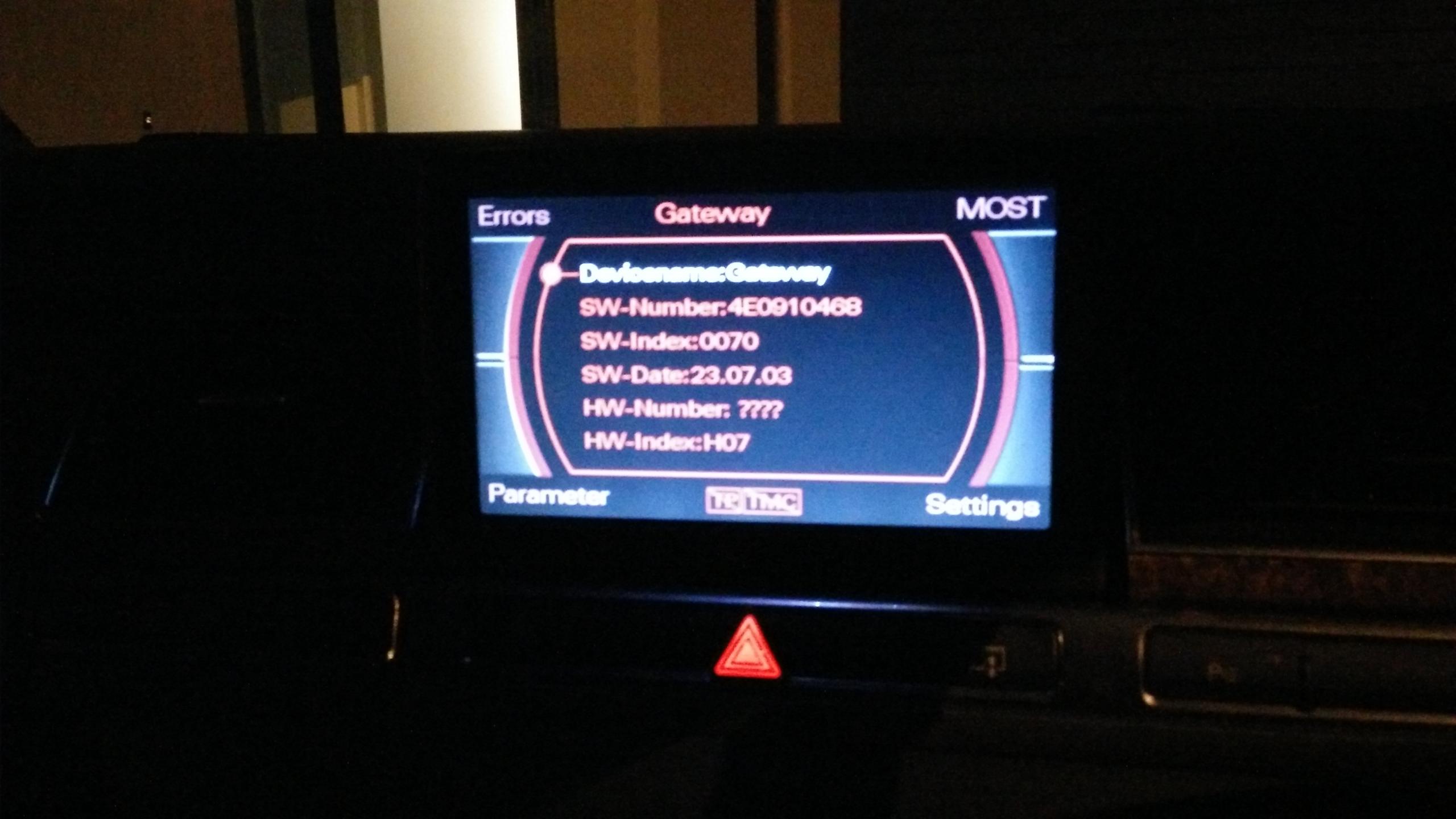

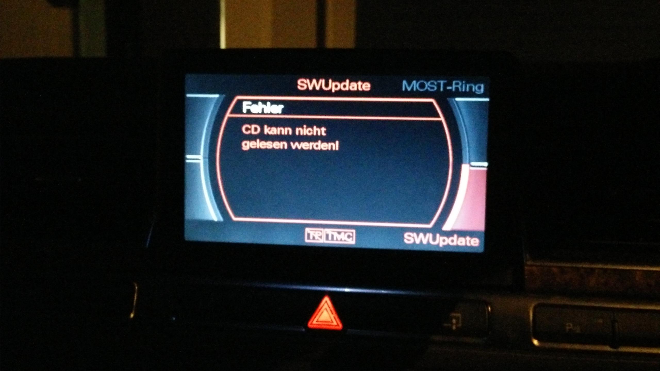

So managed to get the 1100 firmware from Adrian working (thx!) and recovered it somewhat. Now it boots in German and goes straight to SWUpdate. Unfortunately it cannot read the CD (drive) any longer, its not the CDR's, it doesnt even try to access the device. I suspect some recording in VCDS is needed to get it moving along the firmware update train again..?

  #34
Old 5th March 2015, 11:17 AM
Yeah that's a bonus, have you tried the region ignore stuff again?

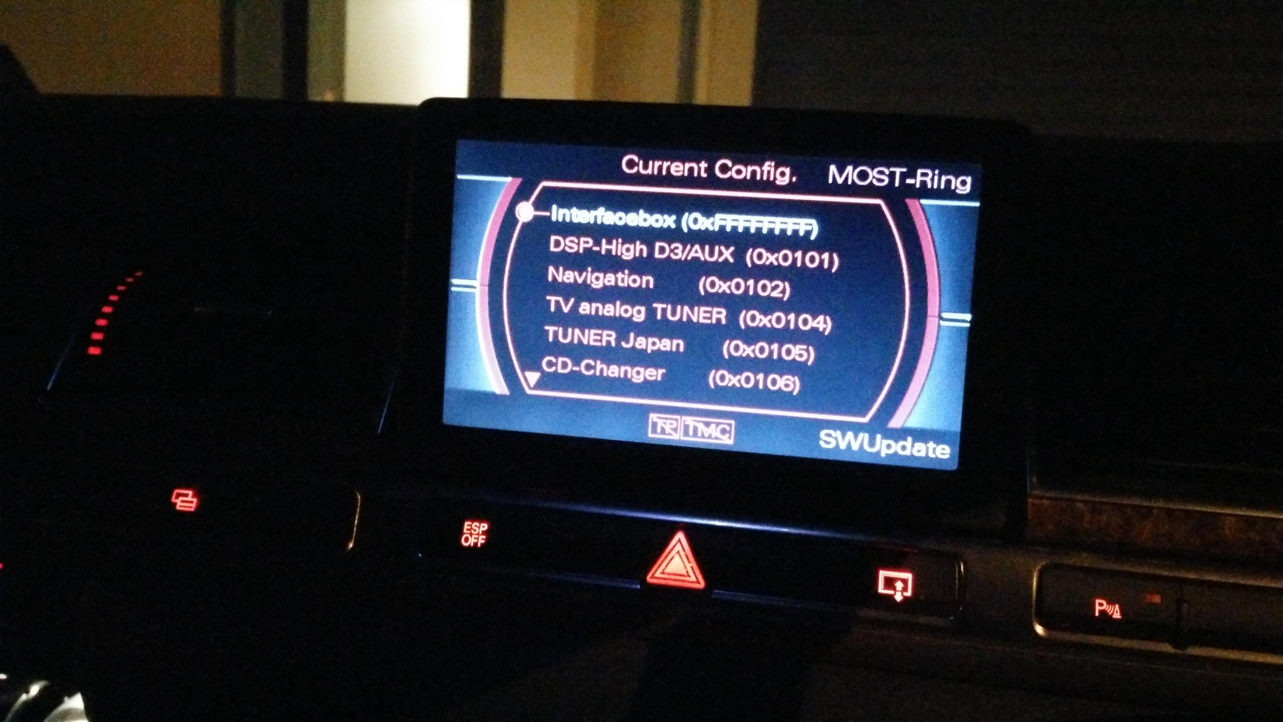

Hmm... from my own photos I can see the interface box coding (assuming thats whats in the brackets) is now wrong (surely should be like it was originally). Ill look up whats normal looking for an A8..
EDIT: Can anyone confirm what they have beside "Interfacebox", eg do you have 0x0100 like I used to?

  #36
Old 5th March 2015, 10:05 PM
Here's mine
  #37
Old 5th March 2015, 10:08 PM
Do another full autoscan and post the results so we can see what's changed.

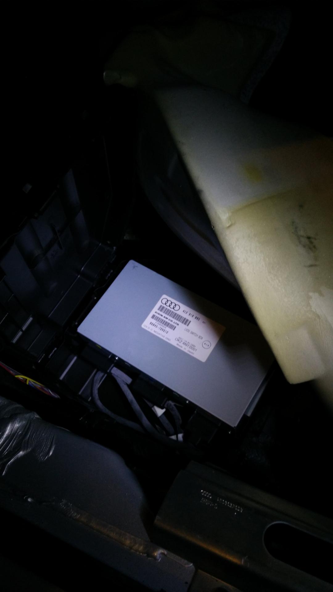

I had a theory that perhaps the CD Changer needs to be media device 1 to work for the FW update, mine is 2 (MD Player is device 1). Frustratingly I cant get my Radio removal keys to work in it so taking it out to disconnect one unit is proving hard.
Also I found the LVDS box under the passenger footwell in a plastic box. It has 3 multipin cables connected to it. One is LCD control, one is HU and one is marked Nav. Removing either of the first 2 disabled the MMI screen (which is now popping up when the car is alarmed and shut annoyingly).
Dug all the way back through the glove box to the MMI control unit.. which seems likely Ill need to change, photos attached.
