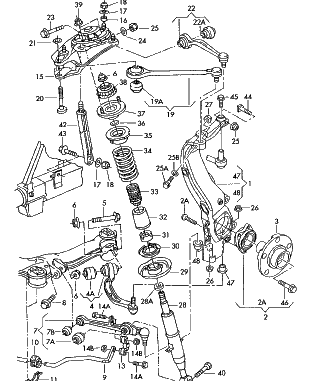

Just to be clear, assuming I've got the right diagram here, which ones are we talking about?:
Old 7th March 2015, 07:06 PM
Join Date: Dec 2012
Posts: 337
10 and 8. If it aint broke dont fix it sort of thing.
The pinch bolt is 25a in the diagram. IF you have an S8 it will have ALu upright (for weight saving) and you will not have a problem removing it. Only an issue with the steel ones.

Old 8th March 2015, 06:04 AM
I would disagree with this, aluminium ones are less likely to be corroded but if they are corroded it will be a lot harder to get them out then from steel hubs.
You can always use heat to try and free them up or drill them out if that does not help, no need to replace the whole hub.
Old 8th March 2015, 09:33 AM
Posts: 1,669
Mine is aluminium and is 3.0 TDI - I thought all D3 had aluminium.
They were very stuck in due to galvanic corrosion of the dissimilar metals + salt.
Most of the bolt's length is plain (not threaded) shank and after shearing the head off, I was able to knock it in a fair way with an air chisel. I then drilled most of it out which made it reed shape. The air chisel moving it made enough threads stick out the end where the nut was - to enable a big washer and two good new nuts to be put on with lots of grease. What I could then do was to righten the two nuts against the washer - this pulled the rest of the bolt out. Aluminium didn't seem damaged. Don't heat the aluminium with a torch like you would steel as it may melt or weaken it.
This must have taken a few days though as I was searching google, going to work and buying tools and new nuts etc. If I had the facilities of a commercial workshop at the first sign of stubbornness, I would remove the whole strut but in doing so you may as well change all upper and lower.
But not having these, if I was to do it myself again, I would use the drill much earlier on as that was the turning point of it budging.
New parts and bolts were slavered in waxoyl type spray.
Drilling with a hand drill is a nightmare in situ and honestly going down the drilling route that will leave you with your sanity would require it to be done with a bench drill of sorts and removing the strut. The point about replacing it can be an issue if its stuck fast or damage has occurred in the frustration of trying to remove the bolt - 1st hand experience as have sold them for this reason.
There is a special VAG tool for doing these bolts. The other workshop tool out there is like wrapping a flexible kettle element around the top of the hub, which heats it to huge temperature and expands the outer casing and breaks the bond. I have not used one or seen it in action but have heard they are effective from one source, obviously same idea as heat which is the 1st thing to try imo.
