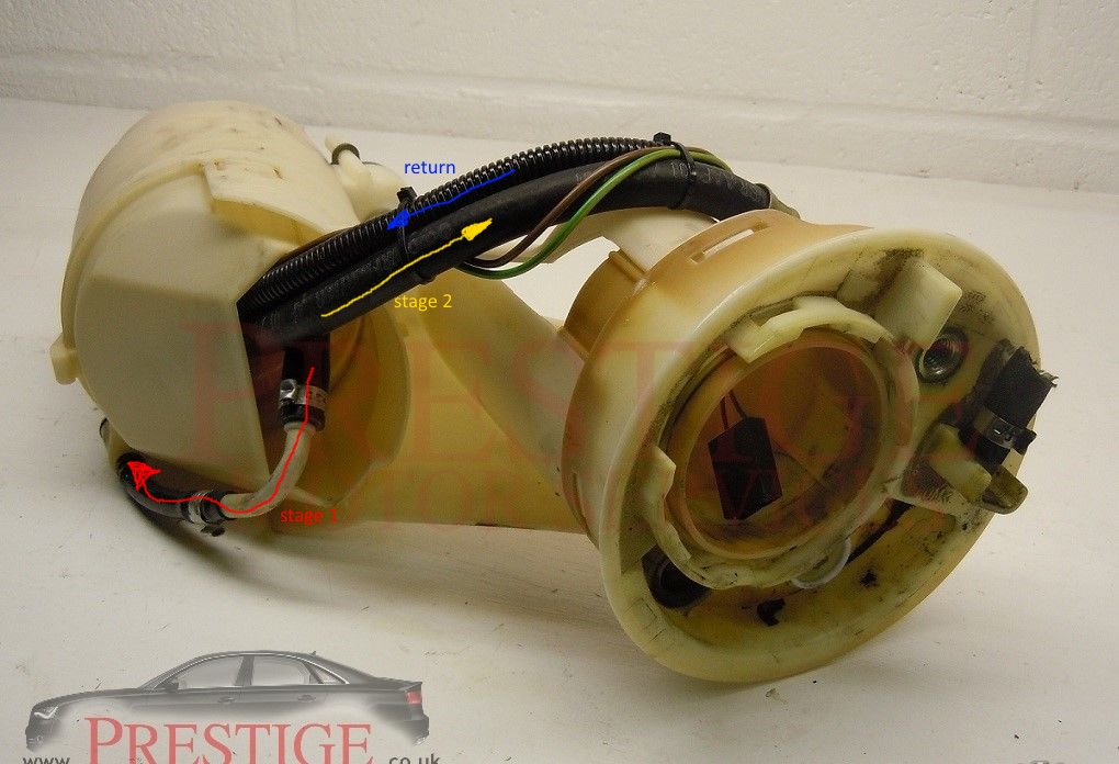

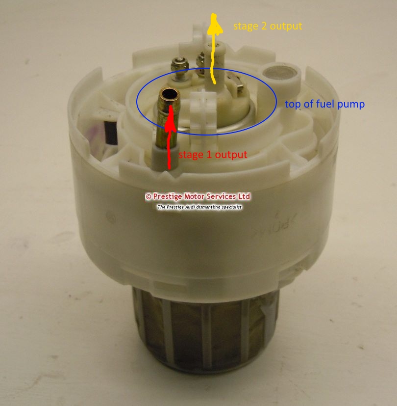

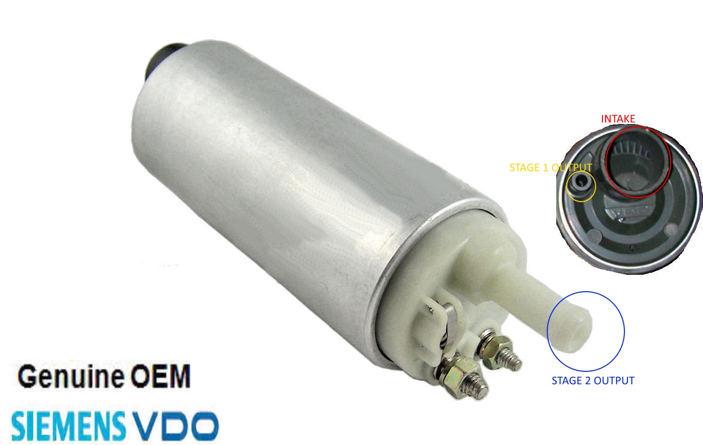

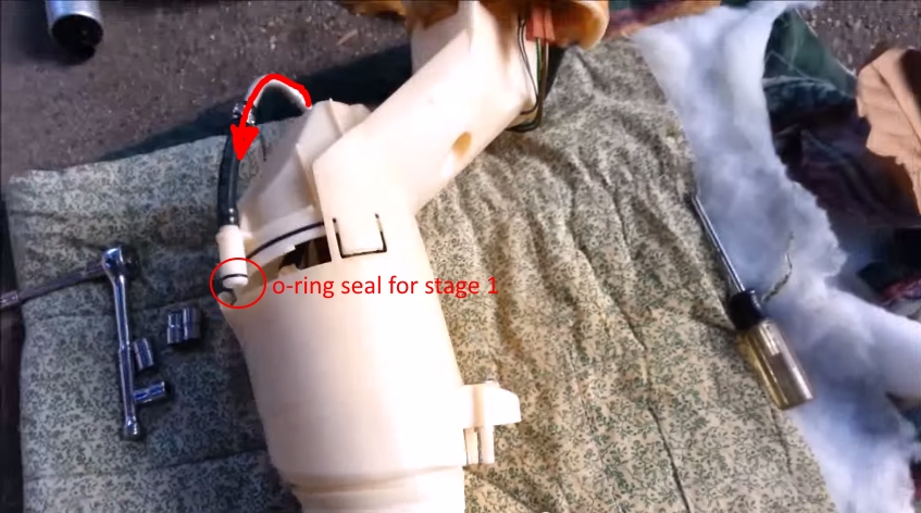

It's been a while since I last worked on fuel pump but if I remember correctly it is as marked up in pictures below. Stage 1 output from the pump takes fuel from baffle housing and deliver fuel to suction jet pumps which pick up fuel from lower parts of fuel tank and dump it in baffle housing, stage 2 takes fuel from baffle housing and delivers it to the engine. So if the the engine was working for the while there was fuel in the baffle housing but it stopped working because it ran out of fuel in baffle housing. It could be because stage 1 output from the pump is not working or if the fuel from stage 1 output was not going to the fuel jet pumps. Maybe there was just not enough fuel to get the fuel jet pumps working properly before it ran out. If you put some fuel in the tank it goes straight in the baffle housing so garage can put small amount in like 0.5-1l in the tank and see if it will work and keep working after that amount is used.
There is o-ring where the pipes join for stage 1 circuit, I guess it might have gone but don't see why.

The fuel level has certainly been lower than this before. However, the garage believe that there is not much in the tank and that there was nothing being delivered at the return line near the engine but felt air coming through. They are going to get 20L and see if that gets things working. I have been reading the Service Manual on the fuel system (from the Tech Dump) and now understand the system better - I think. The reason i thought there were 2 pumps is the reference to Stage 1 and 2 and the fact that the picture you show of the pump is not the same as the one shown on our sponsors page and also different to that shown in a Youtube "how-to".
  #58
Old 3rd April 2015, 02:10 PM
It's the same thing, pictures from the sponsors e-bay shop, the item in picture 2 is inside of the unit in picture 1

aaahhhh! I was confused by the white plastic surround and the filter (?) unit on the bottom. I now see that the body of the pump is on the inside of those. (Lightbulb moment!)
