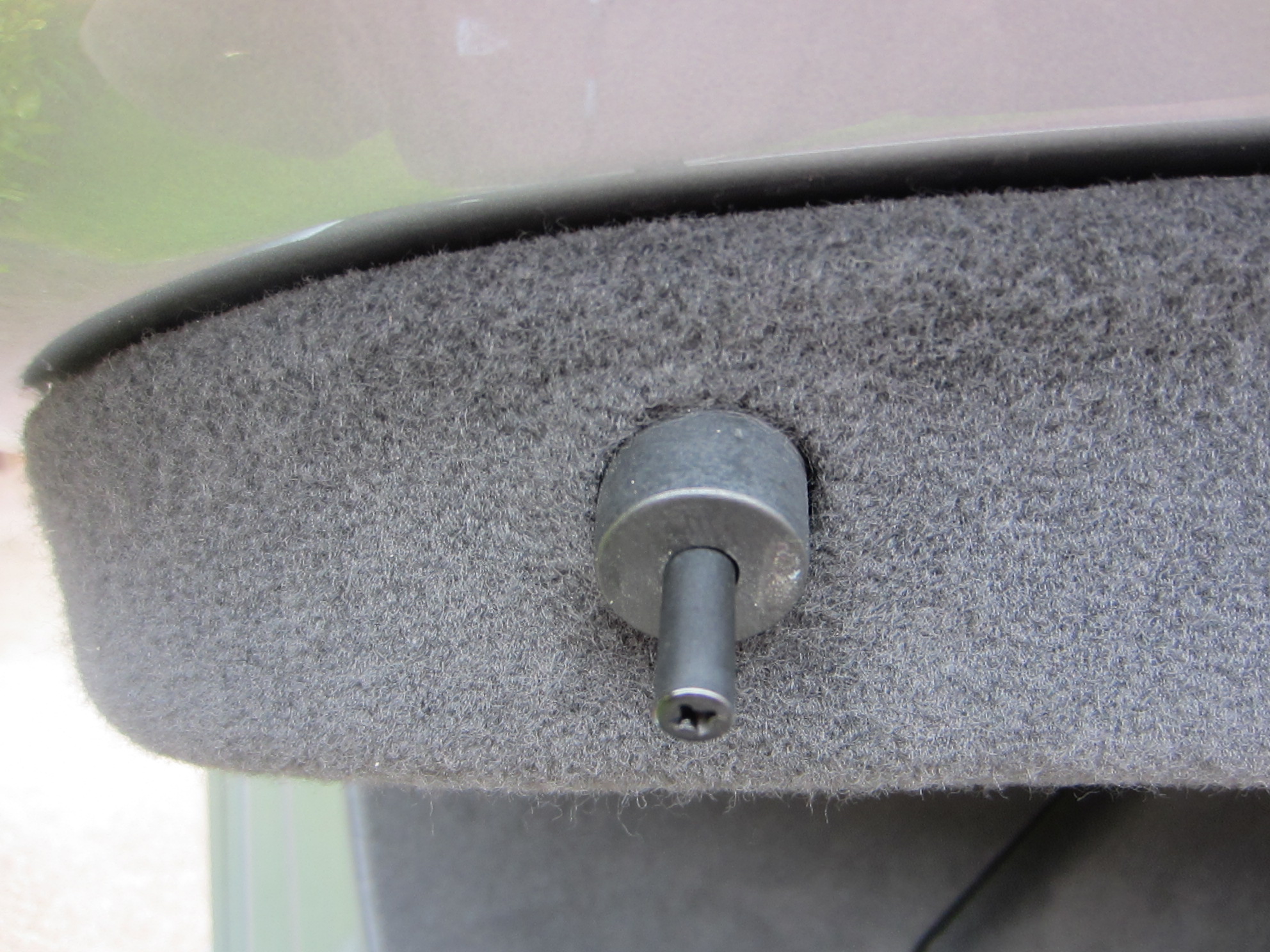

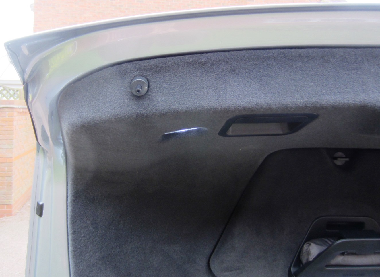

One of these fitted on each side of the boot lid by dealer as a fix.
ID:	10749   Click image for larger version
