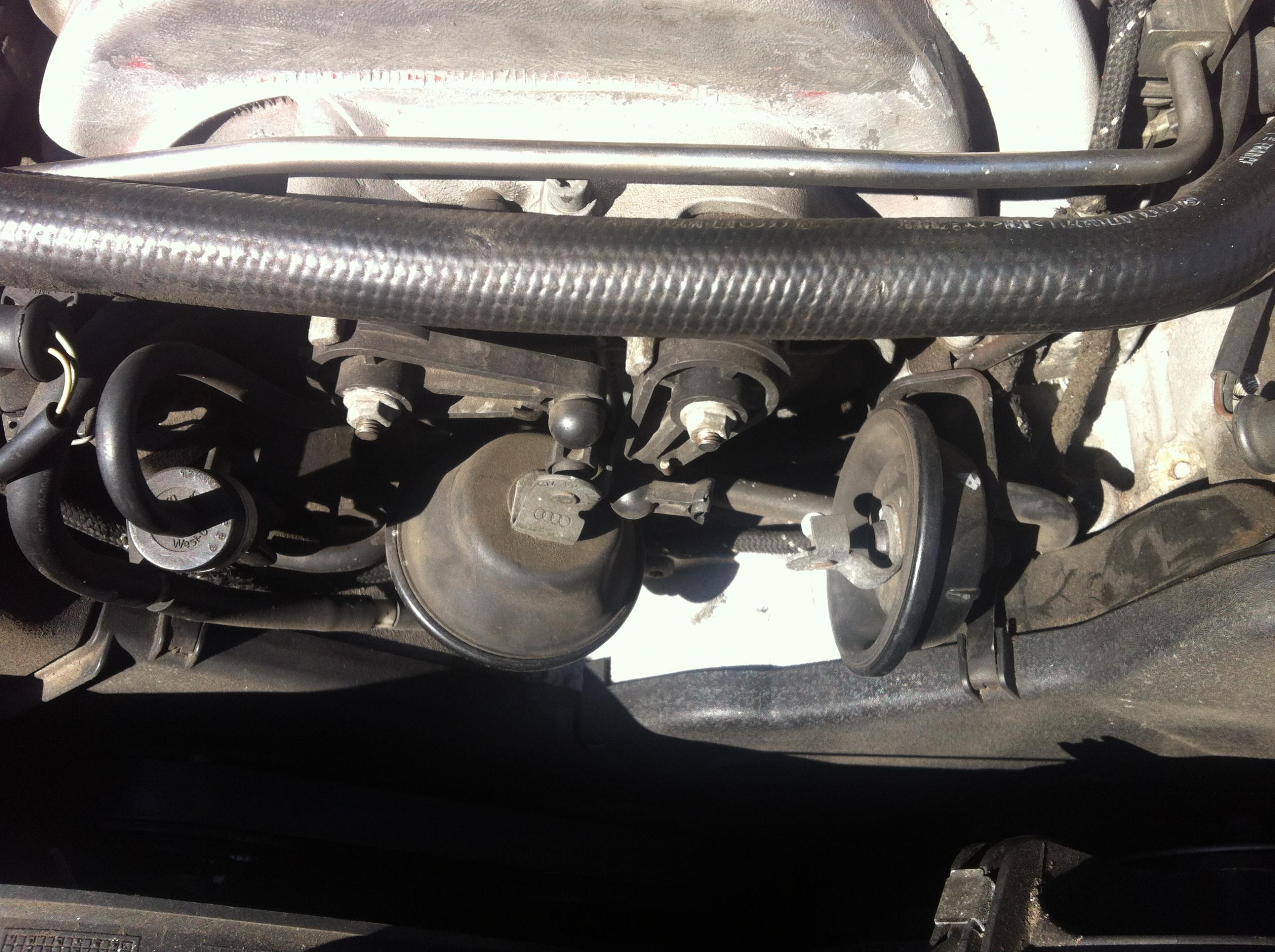

Did a VCDS scan and, apart from an alarm code (I set if off accidentally yesterday) and an intermittent fault on the rear headlight level sensor (which I knew about), nothing.
So I took the 'vanity cover' off and discovered this (see attached photo).
Could have been worse, I suppose. I'll see if I can free the flap and get a new link in the week.
Edit: the diaphragm moves freely; is there something else I should check for the cause of the broken link?

I would expect that broken link to affect performance either at lower or higher end of the acceleration band depending on which one Jim, but not by the amount you're indicating in your initial post. But best to get it sorted and see if that cures it before anything else I guess

Yes, I think the higher end performance, 3K rpm plus wasn't all it should be. The arm attached to the diaphragm was a bit stiff, but it freed up easily enough. Should it be dismantled and lubricated, or should I just replace the arm now it's free?
Oh, and what's it called (or does anyone have a part number)?

In an ideal world you need to get the ends of the flaps in the manifold de-gunked and that will help them to stay free again for longer. There is a procedure for this on audi pages - I'll look for the link for you.
I had James (Mkoneman) do this to my D2 before I went to Germany in it and it drove so much better afterwards and has been fine ever since
