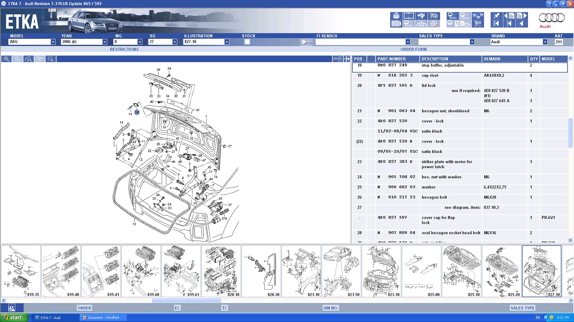

Old 18th June 2015, 07:10 PM
8H0 827 249 for A8 from ETKA or 4F5 like from this link http://www.partsvp.com/products/BUFF...%252dB%29.html
I've got them and they look like they were fitted originally not afterwards.
ETKA screenshot attached
Buffer as they call it is attached by two rivets to the boot lid, item 19, buffer item 18
