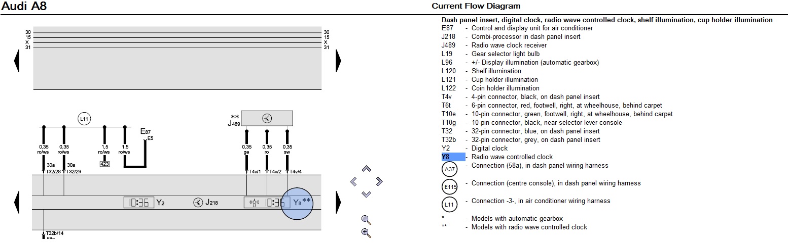

Anyway, diagram for D2, Yellow wire I believe is earth?
Today was the first 24h since fitting it so I would expect it to pick the signal by now, or I'm just super inpatient ??
