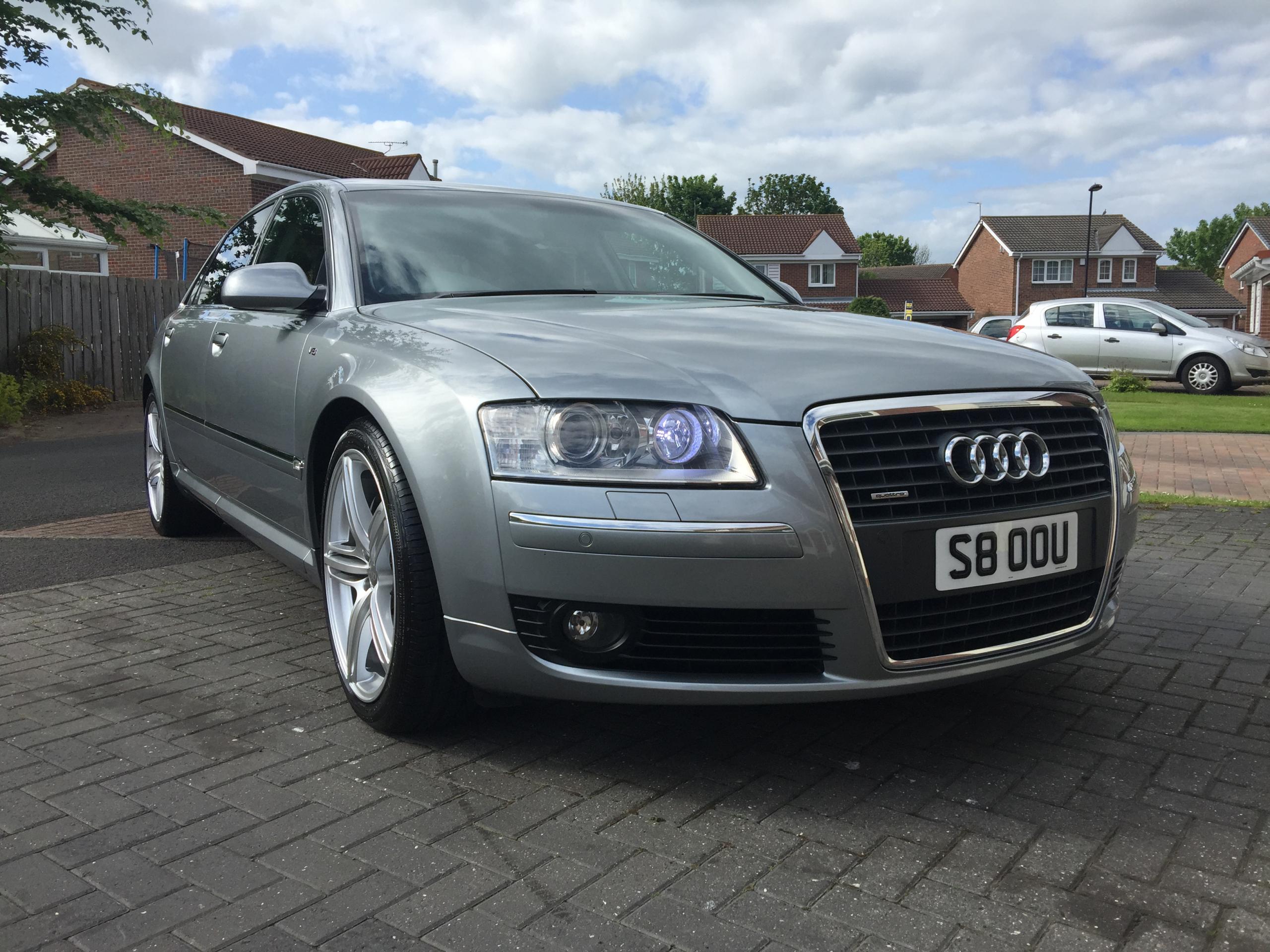

Spent Monday getting her back to glory. Hope you enjoy the photos

Ouch! Even my pocket hurt at that tale. And a lot of the cash was spent unnecessarily.

Sorry to hear all that....but it does look good now. You'll just have to take the Mrs on a holiday in the car. (not staying anywhere, just in the car ).
