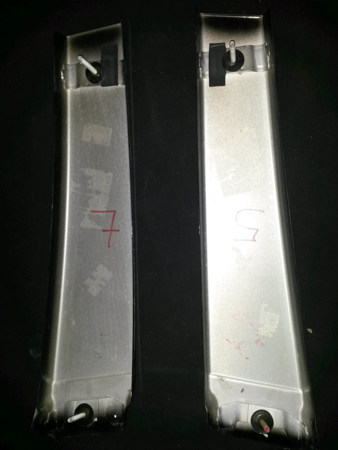

Turns out they're screwed on from inside:
Name:	2015-07-23 17.54.53 (Large).jpg
ID:	11402 Click image for larger version
Name:	2015-07-23 17.55.06 (Large).jpg
Old 23rd July 2015, 07:10 PM
You need to remove the inner b pillar trim. To remove it you need to remove front and rear door sill trims. To remove rear door sills you need to remove rear seat. It is doable. But will take some time. The good thing is that you will not need to remove a and c pillar trims!

Thanks
I should've mentioned, the job's done. The photo is of my old trims.
I actually managed to get them replaced without removing anything though .... 'coz I got someone else to do it for me
