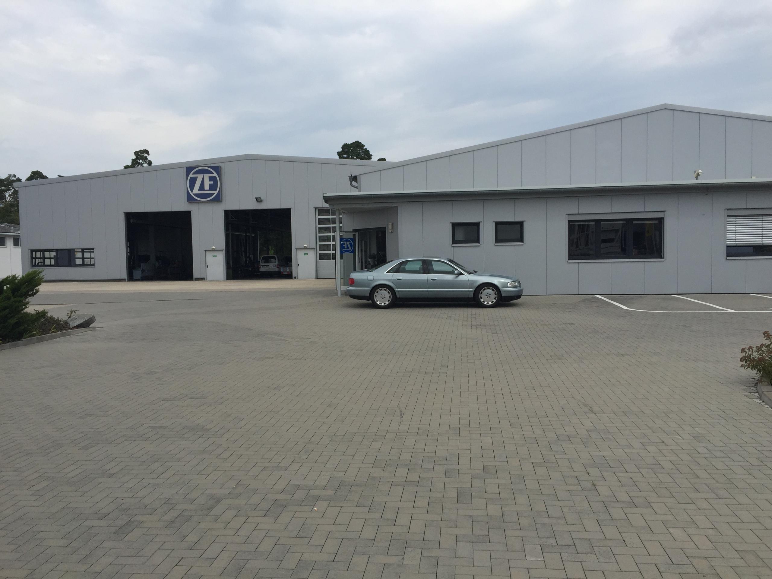

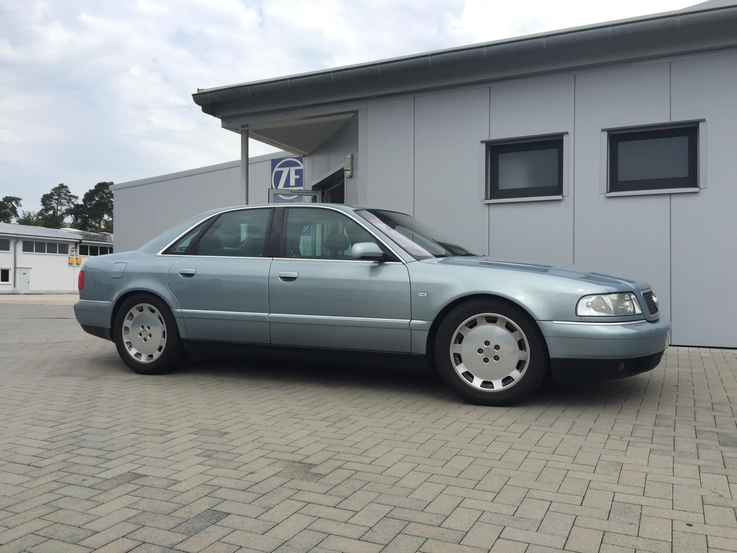

After the German meet went to ZF Darmstadt and changed the oil temperature sensor with harness.
