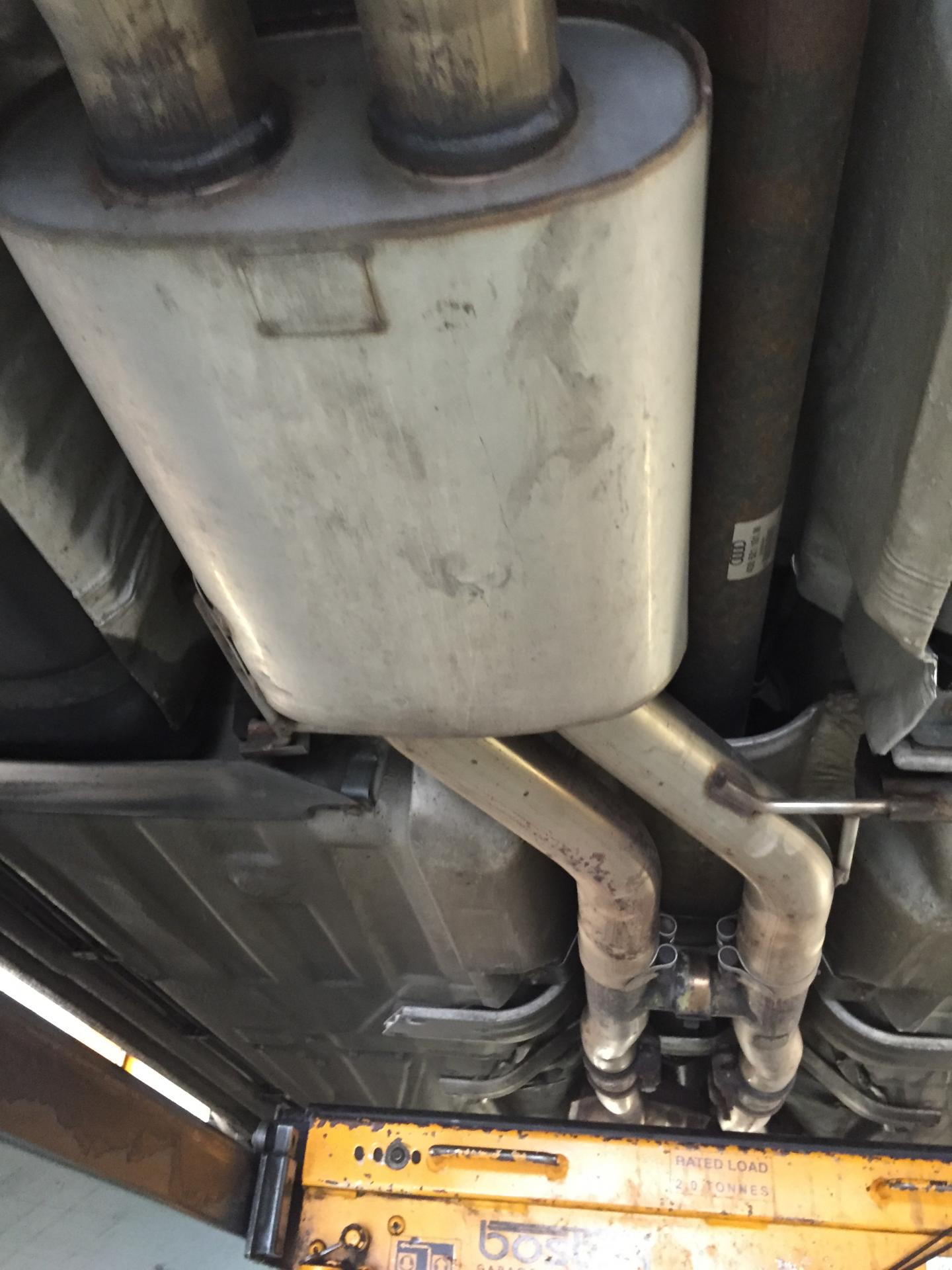

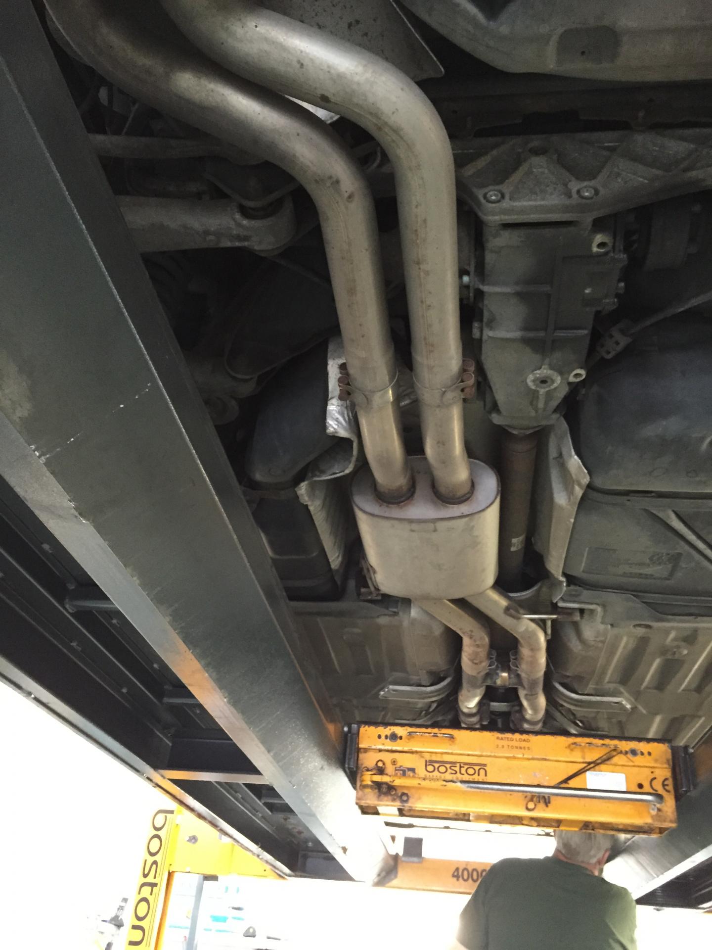

Mine will be up on a ramp tomorrow getting its MOT so will try and grab a pic of the system
Need to check out if a rear diff seal needs doing yet so will be having a look!
As promised here's some photos of mine for info
I suspect the final 2 pics show where the join is to the OEM exhaust as the link section is looking considerably more corroded than the rest! If that fails I guess I'll be looking at some sort of X pipe section to replace it.
System has been on the car since August 2010
ETA - looking at the receipt for the exhaust again I think that section with the link pipe between banks is part of the Milltek system, as there's part numbers listed for LH and RH inter pipes, a centre section and a rear section. It's not leaking but it doesn't look great....

It certainly looks a lot wider than the stock H-pipe so probably better?
Less restricted communication between banks?
