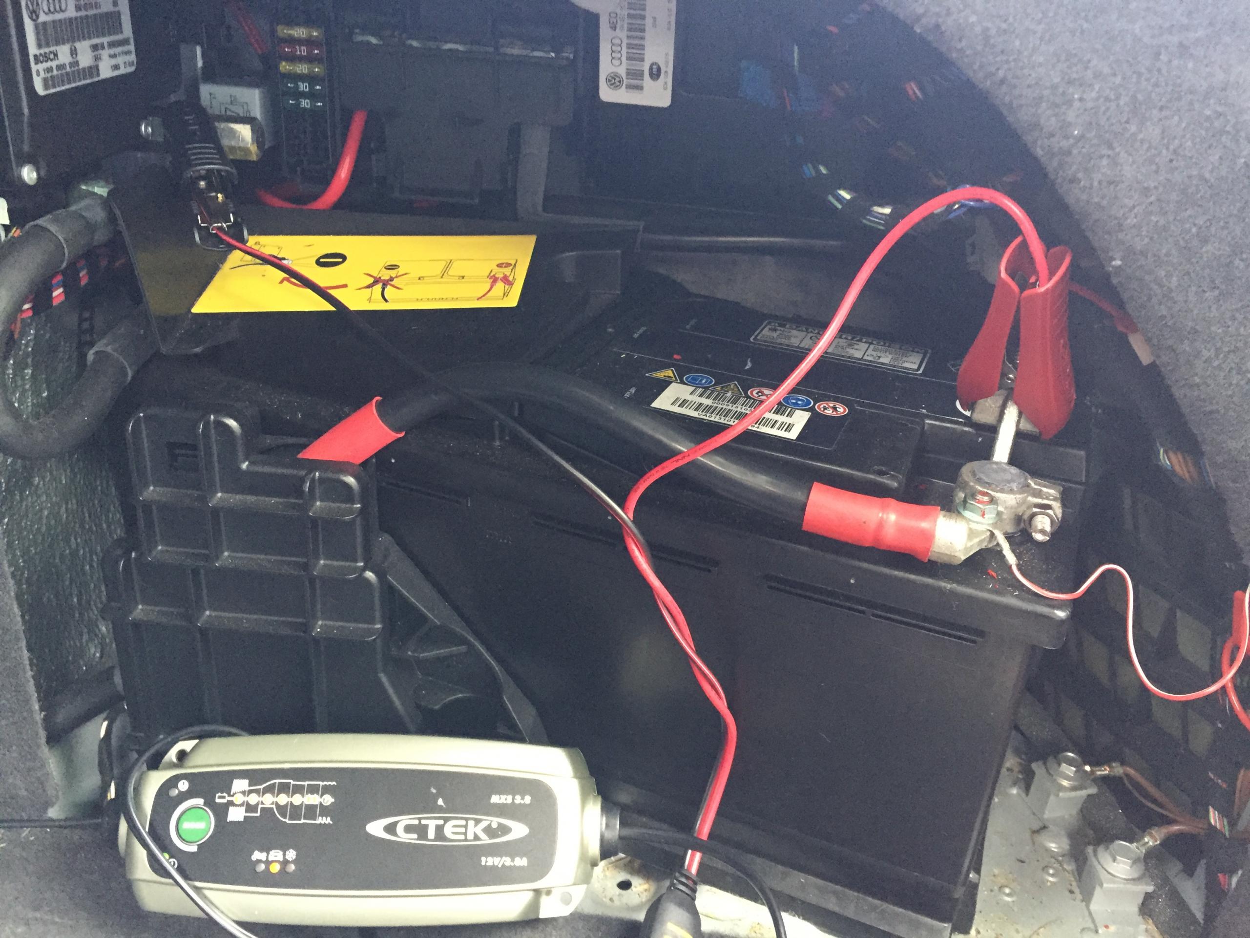

I left the ctek charging overnight and its now up to '6' so hopefully it should fire up now. I'm going to leave it to complete the full cycle, shouldn't be much longer and I'll post the results.. I've attached a couple of shots of the ctek doing its thing!

I left the battery charging overnight again and it didn't get to the final stage, step 7 on the ctek.
I attached the Mondeo jump leads as well as the ctek and attempted to start. I opened the door and could see the red mileage digits and interior lights came on. Everything seemed to be working inside the 8, I put the key in and turned once, no ignition lights, turned again to attempt to start and nothing, and I mean nothing, not a peep from the engine.
Not sure where to go from here, is there any point buying a new battery - (I checked the battery level from the 'car menu' before starting and it was at 1 bar on the gauge even thought the CTEK was at '6' which intheory should be full) or do I need to look at the starter

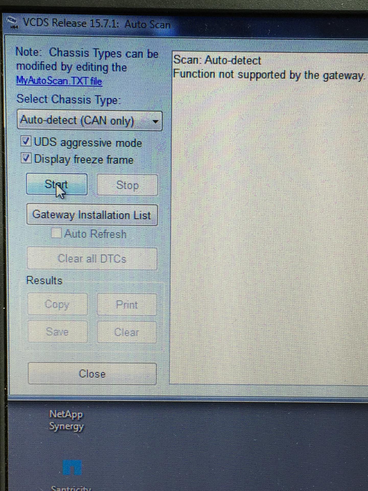

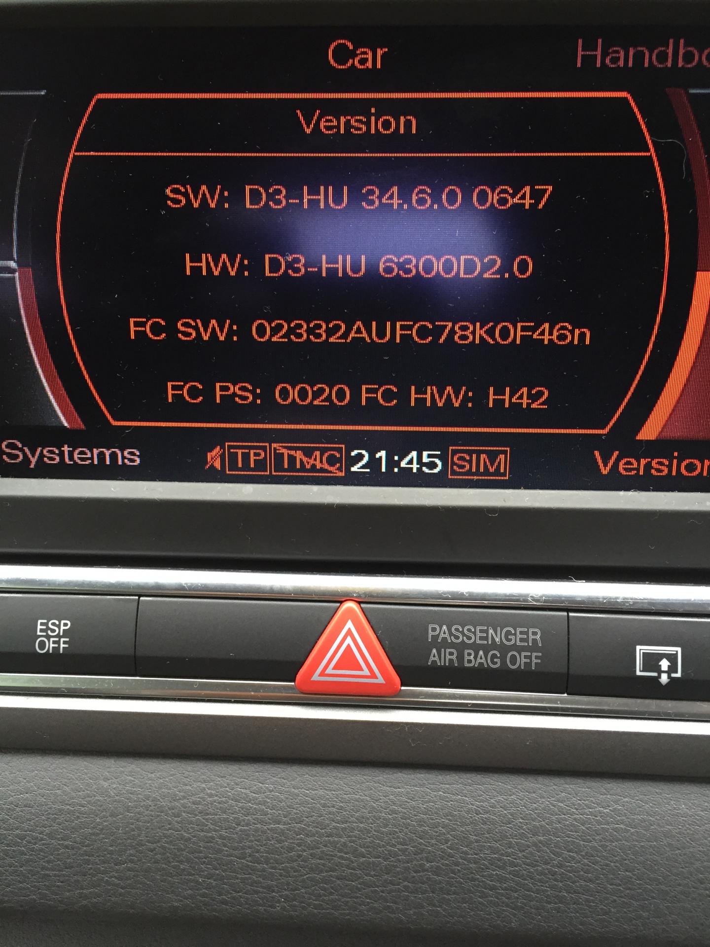

I have just done a bit more testing after the latest failed start - I left it on the Mondeo jump leads on and after the start reduced the CTEK down to '3' it quickly got back up to '6' and I thought I'd check the battery level on the 'car' menu again and was surprised to see it at 100%.
I then attached my VCDS cable and done a 'AutoScan' which revealed some interesting results - attached. Since clearing all DTC's I have been unable to run another scan, I get an error saying 'function not supported' which I suspect is low voltage issue...
