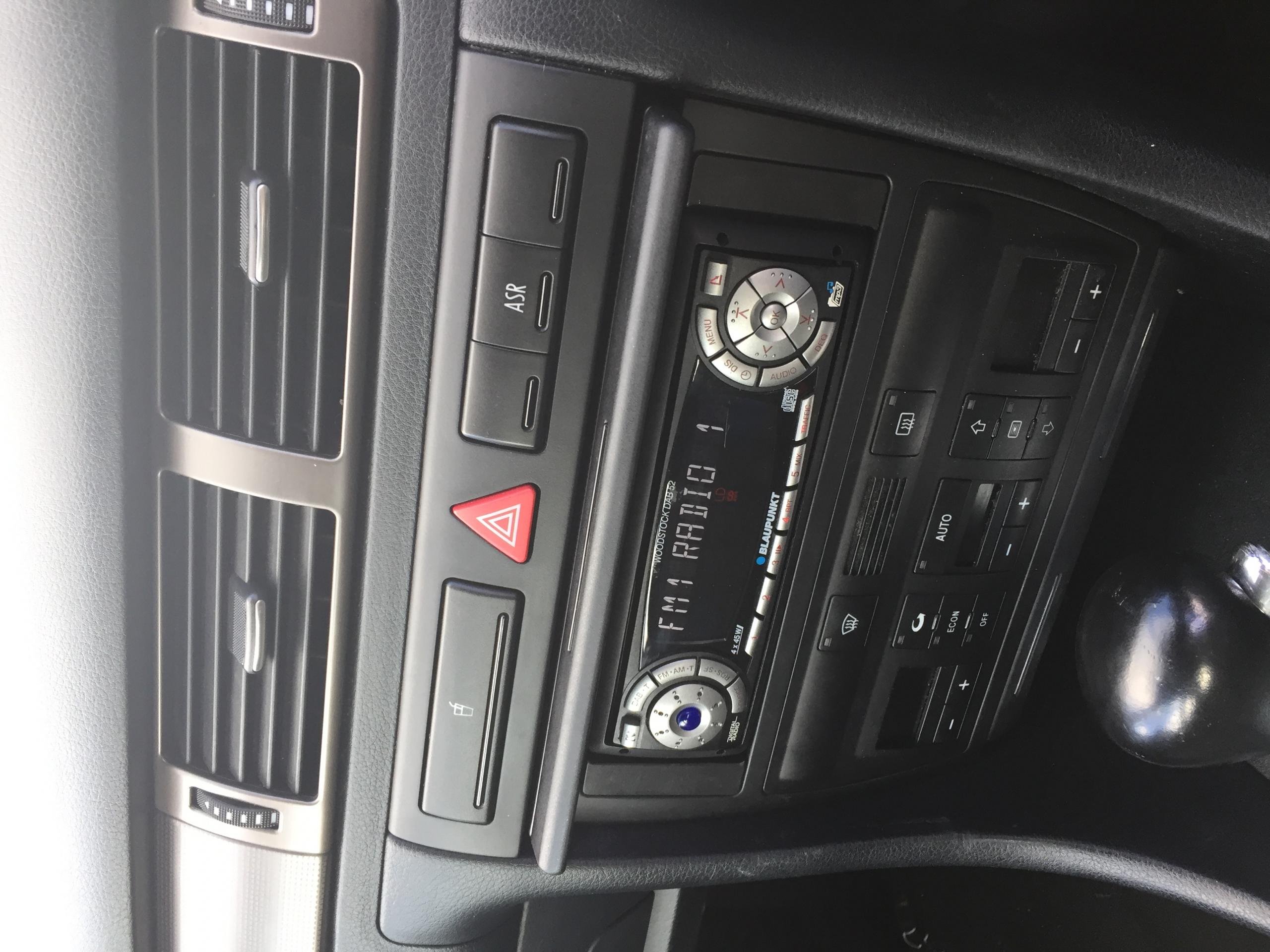

Still not got the code for the radio from Audi, so I took up plan B and installed my old Blaupunkt Woodstock DAB52. As the factory Concert was also made by Blaupunkt the Woodstock had all the same connections so it's installed and also powers the factory amp thats driving the rear speakers. Result is perfect audio from all the speakers, I don't think the rear speakers have worked for sometime but the sound is much improved. Only issue was the power to the unit, as VAG have the red/yellow reversed from standard but have that sorted as well.
