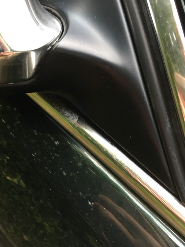

Old 4th October 2017, 03:32 PM
I think it's made from polished aluminium with a lacquer coating on top, and water is penetrating between. So any surface treatment is doomed to failure.
I had a little experiment today and now think there are two problems, one of which is sort of fixable.
I've seen comments about people polishing the trim with just WD40 and have tried that myself. It works in some areas but not others.
Thinking about it, where it works the damage must be mainly on the surface, so I tried a test area with a thin layer of lacquer topcoat, having cleaned it thoroughly first and it worked quite well. It's the small shiny area in front of the mirror pivot in the first picture below. That trim on the drivers door is only slightly milky.
I think a fair bit of the trim on my car is just affected by surface degradation, so I plan to treat all of it, in stages, with clear lacquer.
I know some bits (notably the trim under my offside headlight) will not be improved much by that, but I'll give it all a go eventually, I don't have enough lacquer on hand at present to do anything other than small tests.
The second picture shows that headlight trim, it was all milky but I treated the centre and right areas. The right improved a lot but the centre highlighted the deeper damage that is shown by the obvious milky streaks.
