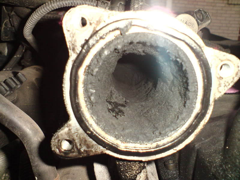

There was a fair bit of carbon but I would not call it bad at all, I would expect power loss was not more than 10%. Some TDI's have a lot more buildup including 2.5 that I have on our A6. I was considering doing our A6 but took the pipes off and they were slightly better than yours so I decided it did not need doing it. As far as the oil in the intake goes i would not try to reduce it because oil contains cleaning additives and solvents, and on direct injection engine you do not have any fuel in intake so oil needs to do all the cleaning. Obviously if you do not have EGR and no oil than there will be nothing to form carbon buildup. But there is always going to be some oil that will burn on if in small quantities but if you have relatively lot of oil going in there it will clean it as well. I think that might be the reason why our 2.5TDI in A6 have a lot less carbon buildup than others I have seen online even if it has done nearly 200k miles now. It has old style oil separator and while many recommend to replace it with newer style I have left the old one.
On another note on D2 40V engines there is PCV valve/oil separator to reduce amount of oil entering intake and they suffer from seized intake manifold flaps and broken arms as a result of that, on 32V there is nothing there so you have plenty of oil going in intake and I have not heard of any flaps seizing on 32V engines.
Either way you want some cleaning agent going through the intake be it fuel or oil and some on new VW engines have dual injection indirect+direct so you get clean engine and great power/emissions/fuel economy. I could be an idea to add small fuel injector in the intake.
Sorry to hear about misfire after the work done, just an idea but I had injectors cleaned while my engine was in bits and one failed pretty much straight after it. I was getting intermittent both misfire and electrical open circuit codes for one cylinder. I think ultrasonic cleaning have shaked loose solder joint inside one of injectors.
Couple of pictures of bad carbon buildup, not mine, sourced from the web:
