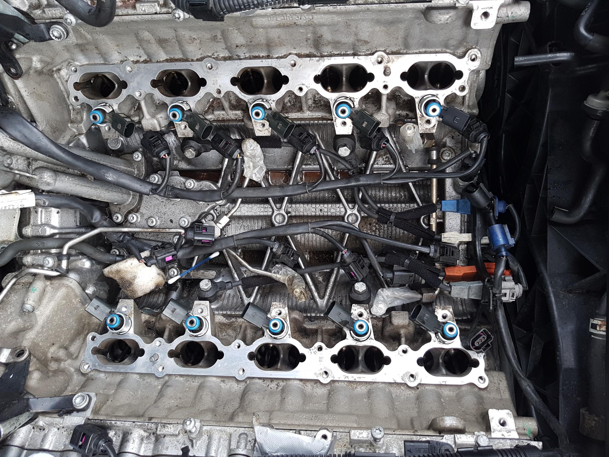

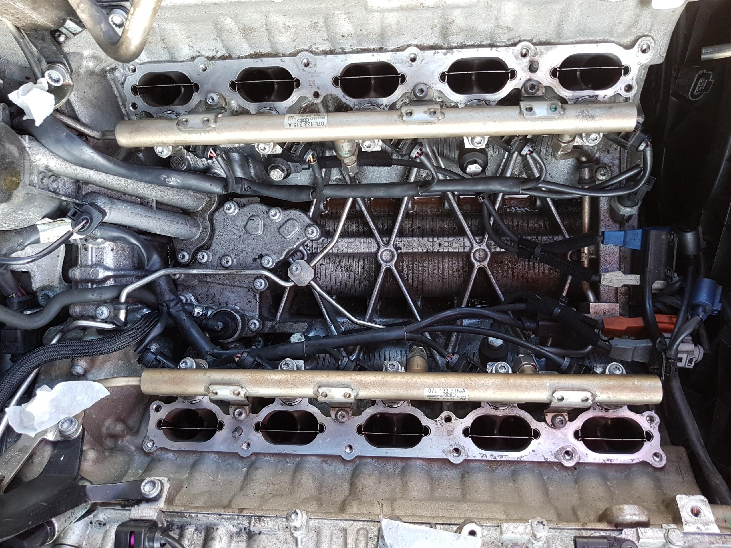

So we began the whole process by removing the manifold which with Marcins prior experience didn't take too long at all because he knew where the hidden screws were at and how to go about getting them off.
Once the Manifold was out I thought it would make sense to have the injectors pulled and dropped off at a ASNU service centre which for me was Clive Atthowe Tuning, these chaps knew their trade well and if anyone is interested in tuning, rolling road, injector testing etc are well worth a visit.
Removing the injectors is quite easy and just required the rails removing and then rotating and pulling up on each injector to remove it.

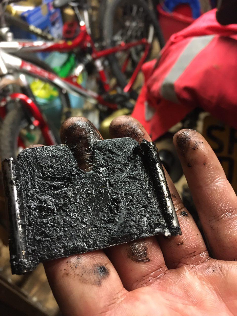

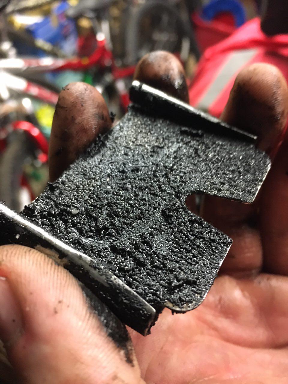

We dropped them off and carried on with the carbon clean, first out of the inlet tracts is the plates which sit in there. they looked like this
They were thrown into a tub with degreaser and left to soak over night after most of the gunk had been scraped off
All ten were more or less the same and I was surprised at the build up considering how clean my inlet manifold was compared to Marcins if you remember the Flaps inspection video i posted a while back.

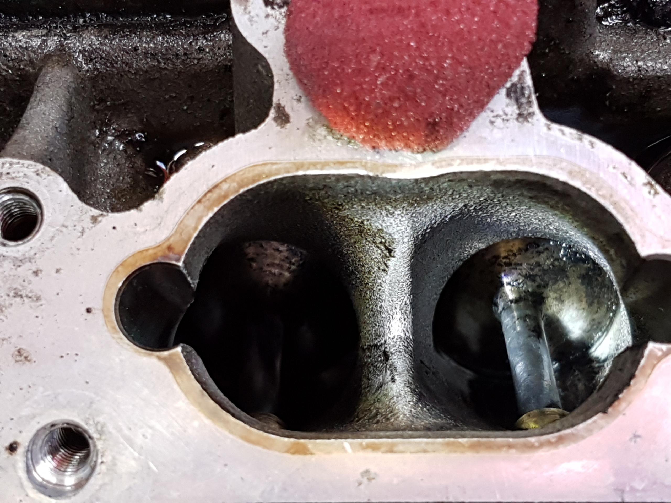

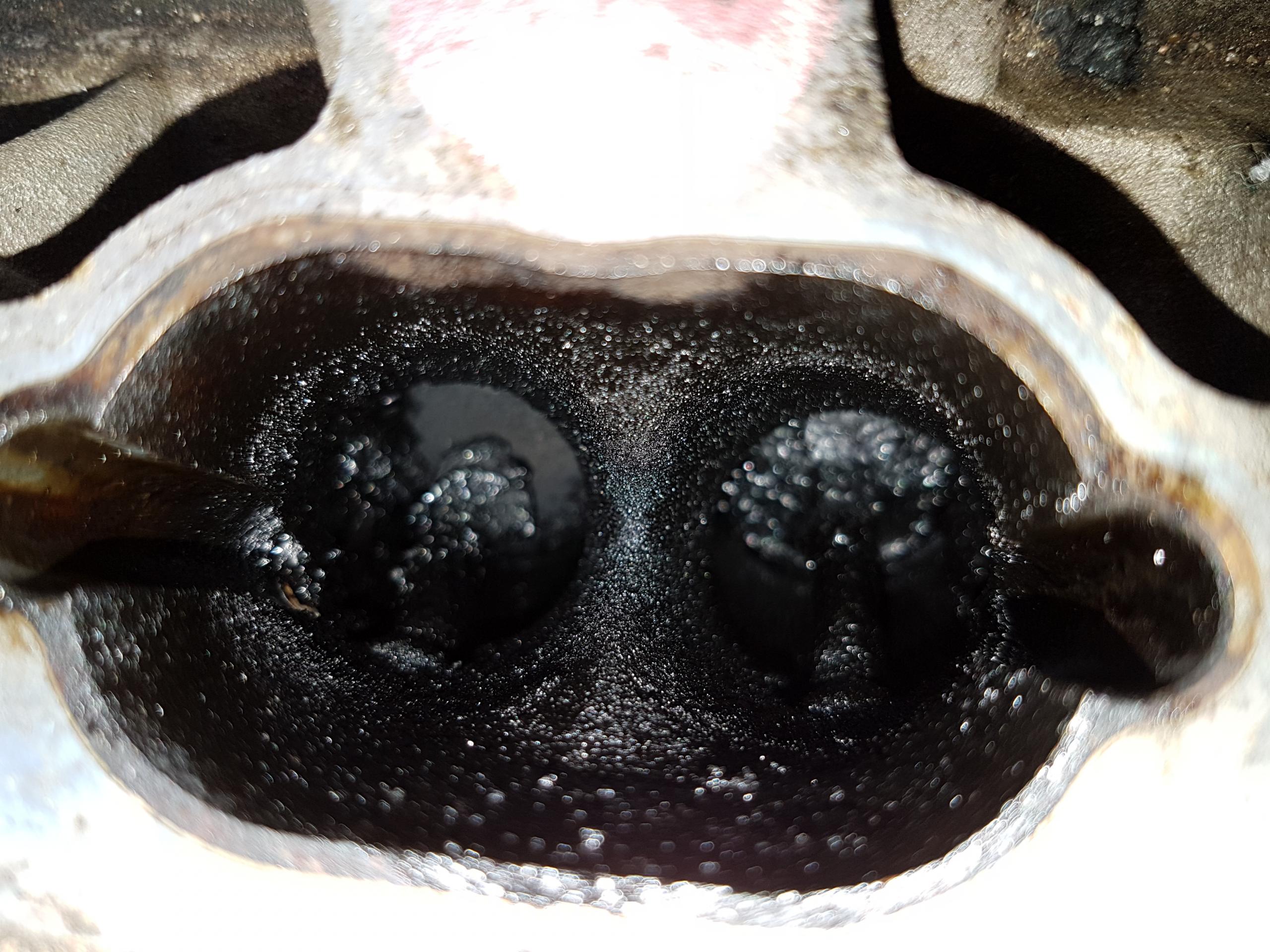

Onwards with cleaning we tackled a bank each to speed things up and all 10 tracts and valves were gunked up, some worse than others but all manky.
I didnt take pictures off all of them as there was no point.
Sorry for the massive pics.
The picture of the cleaned tract and valve is after the bulk of the cleaning, now it looks like its still bad but its actually quite small valves in these engines and the specs of carbon are very small, once you get them like that its scotchbrite and degreaser and lots of poking and scrubbing to clean them up a bit more but they really don't get too much better TBH.
Blasting would be the only way to get them spotless.

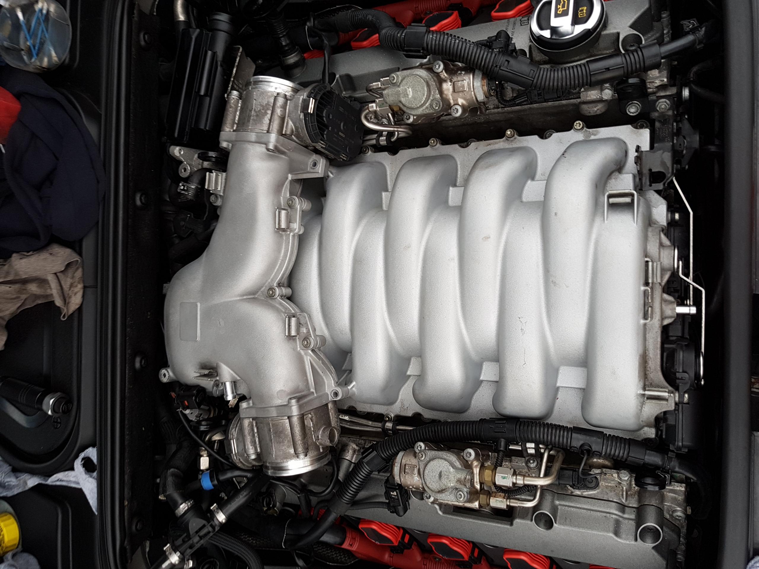

Once we got them back home it was just a case of assembly, it all went smoothly other than dropping a few things down into engine bay which required rooting around with the borescope inspection camera, and me forgetting to tighten an inaccessible fuel rail pipe.
Once it was all back together this became obvious with petrol ****ing out on application of ignition
Luckily i managed to get away with removing the T piece with the throttle bodies on, a few other bits of pipework and I chopped up a spanner to allow the tightening of the fuel rail pipe.
I don't think i could have coped with removing the whole manifold to tighten one pipe.
Once it was all back together the second time it was time to fire it up and give it a good blast along to the road to clear it out.
