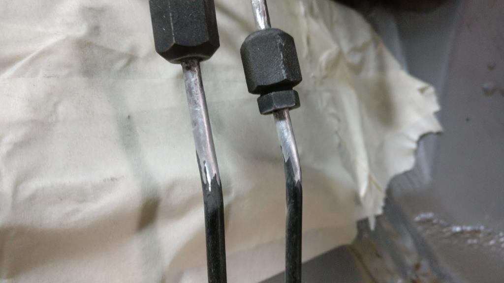

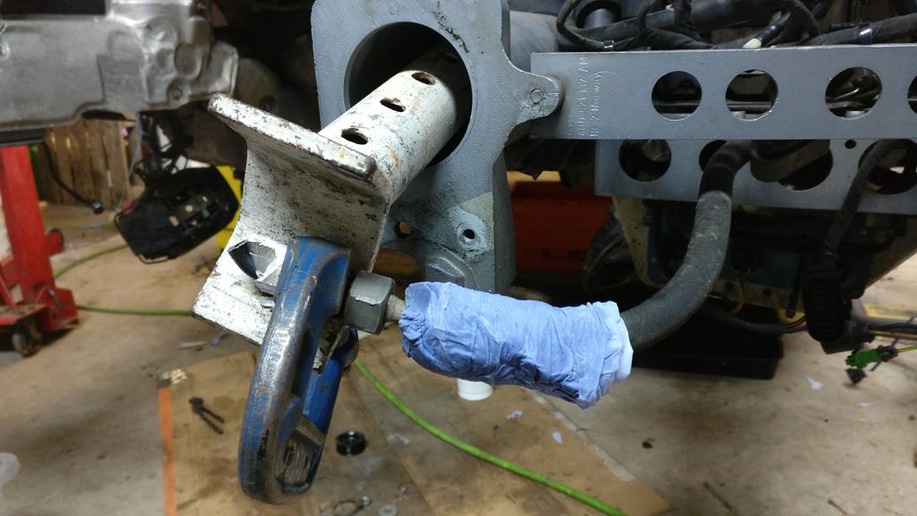

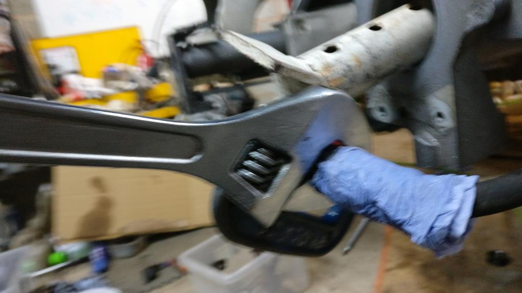

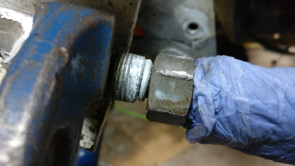

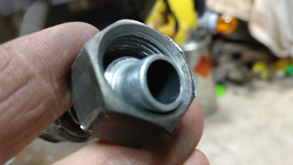

A long day today with lots done. First job was to recover the other AC hose connector. The first one I did in the bench vice but this one is still attached to the car so needs something of a contrivance to hold it still. The stump of the condenser is clamped to a large axle stand which is tucked in to the chassis leg. There's a wet lump of paper towel wrapped round it so I can heat the nut up with the mapp gas without melting the hose
it takes some heaving to crack the nut loose even after it's heated up

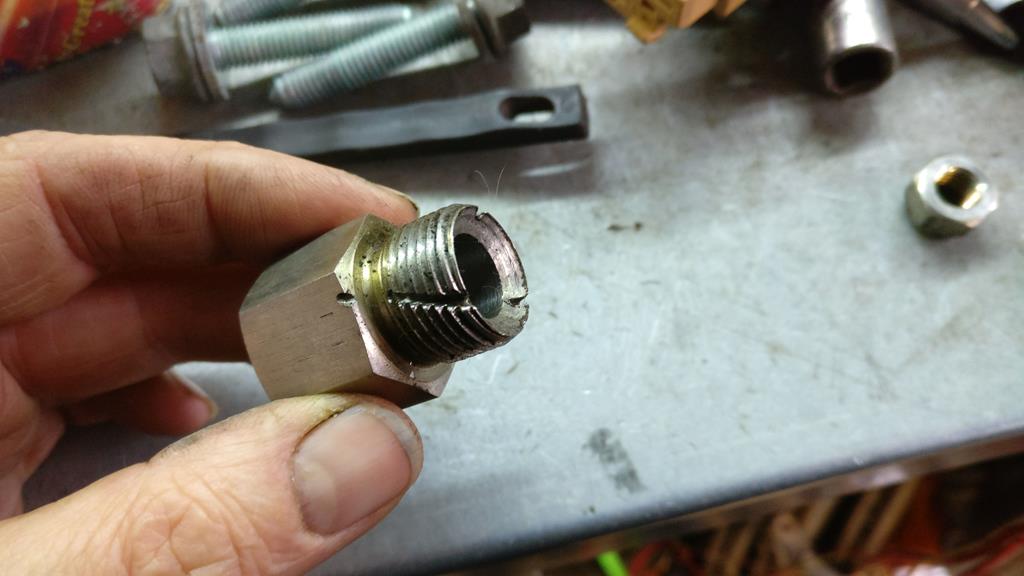

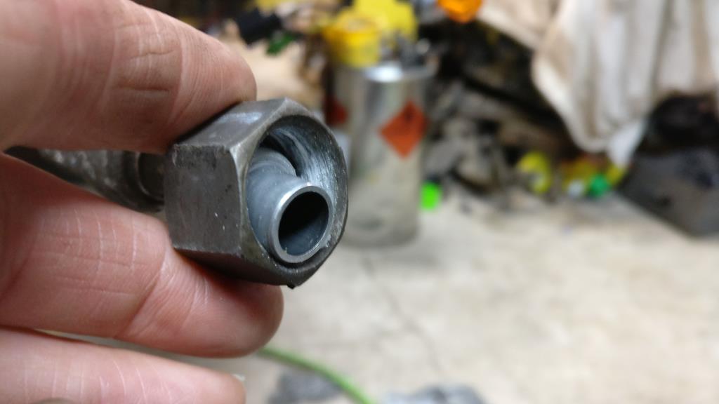

The nut is some super-hard grade anodised aluminium and takes the threads from the condenser with it as it comes off. It takes so much force to break it loose that even the hard aluminium is distorted a bit
Properly mush in here with the galled up thread from the condenser still stuck in the threads of the nut

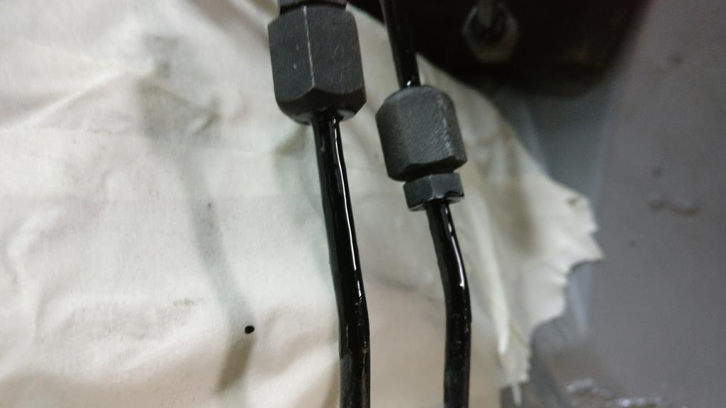

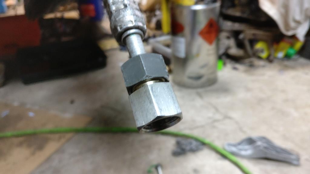

I made a die set from a couple of steel thread couplers with slots cut in with the grinder. These are progressively wound further and further in to the nuts a little bit at a time and clean up the threads as they go
I keep going until I can thread the coupler in completely by hand
Internal threads cleaned up

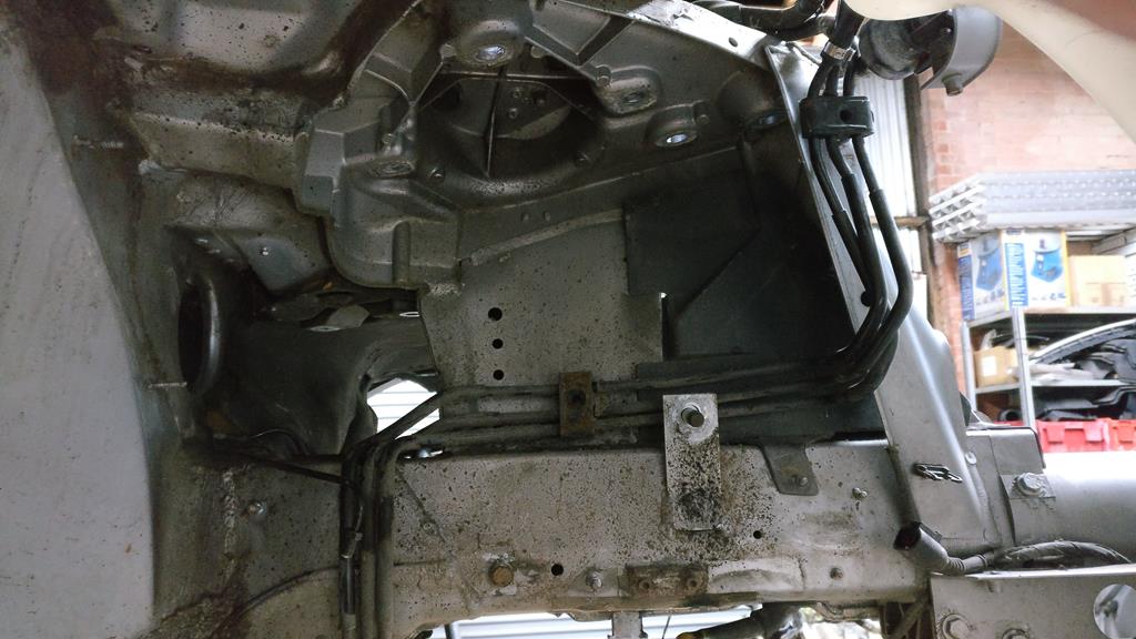

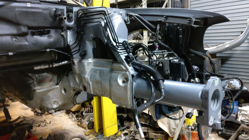

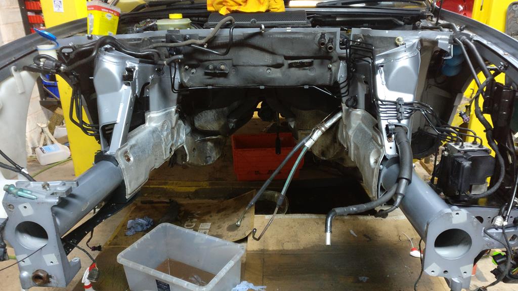

On to the arches. Left side first
Better
Left engine bay also cleaned

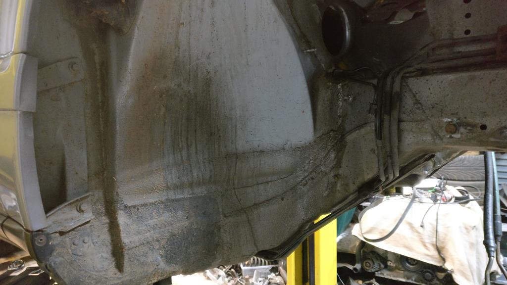

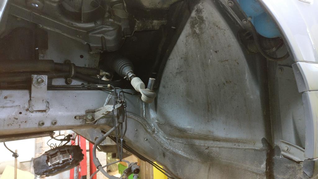

Driver's side arch

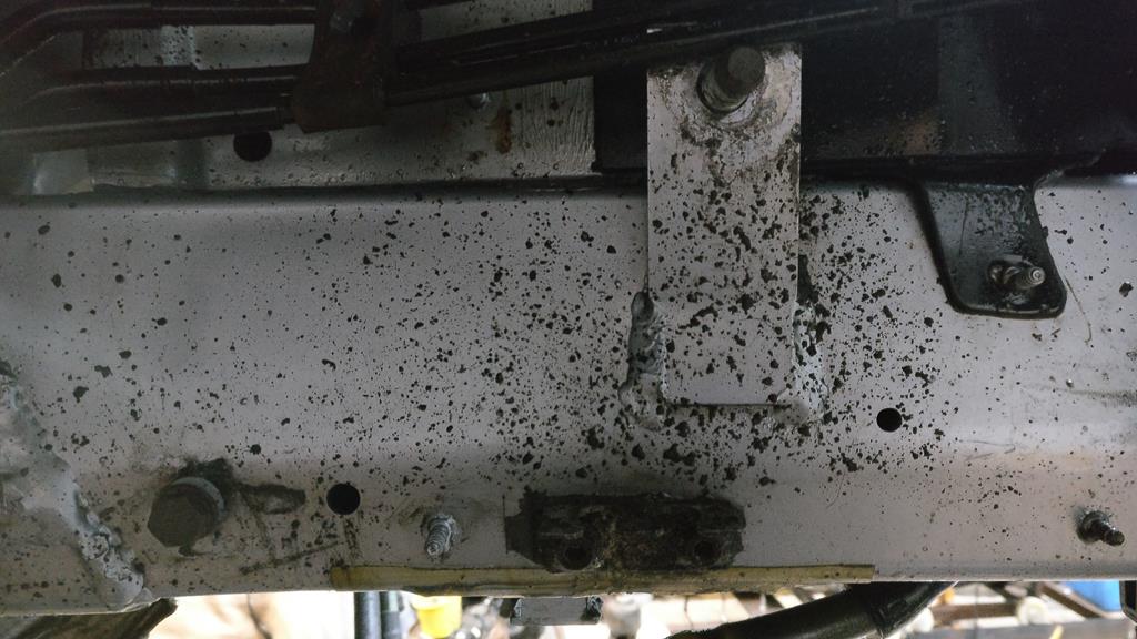

The fuel pipe clamp was rusted to dust

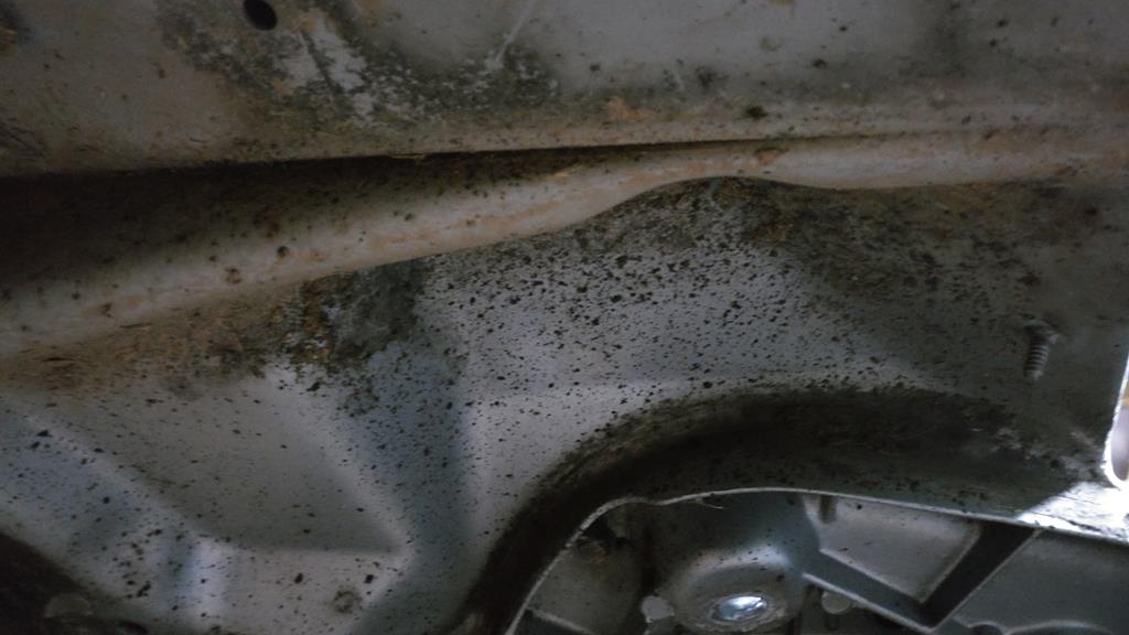

Apply all purpose cleaner and agitate, then rinse off with water

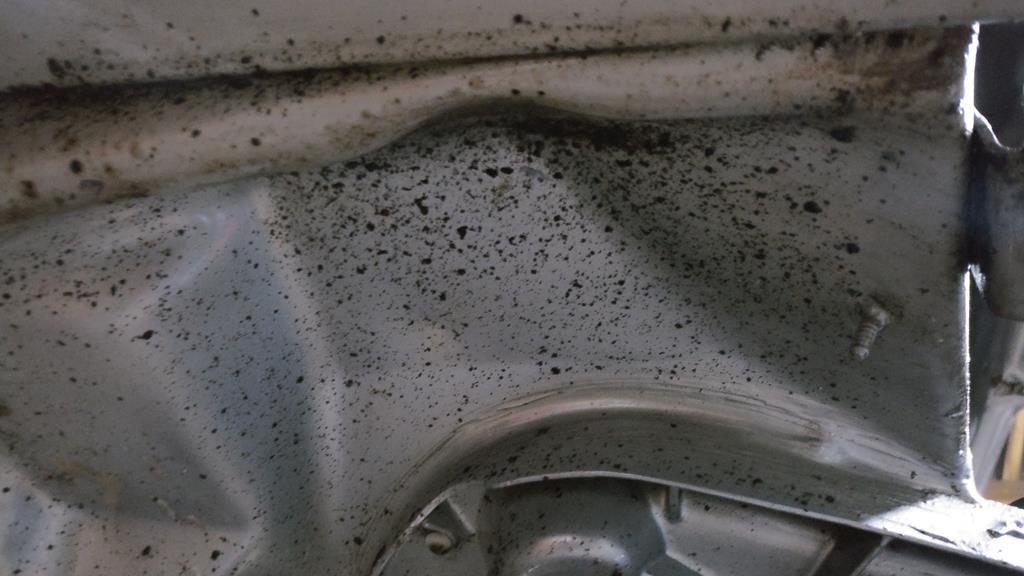

Amazing tar contamination. I've never seen one this bad before
the left side had a lot of tar, but nothing like as much as this
Cleaned up with Gtechniq tar remover
and the other side of the bay also done. I'll treat all this with sealant tomorrow

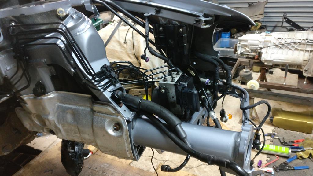

Standard acrylic spray paint. The manifold doesn't get particularly hot since its mostly full of incoming cold air, and the only heat sources are conduction through the mounting flange and general heat of the engine bay. It doesn't get any hotter that the bodywork in direct sunlight - 60-70c probably.

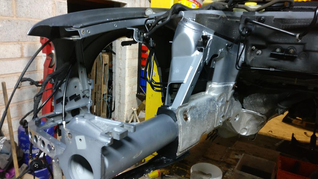

  #256
Old 14th February 2022, 10:40 AM
It'd stay that clean for about ten minutes round here!
The blue pod is a vacuum reservoir for the inlet manifold. There's usually one on the other side as well but it was removed to make access for dent removal a little while back. I wonder what the term is for storing a vacuum, since you can't really store an absence of something? Anyway, they store an absence of air for if the ecu wants to activate the manifold after or during high throttle openings when the engine isn't naturally making much vacuum

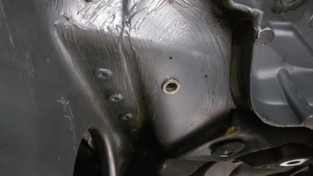

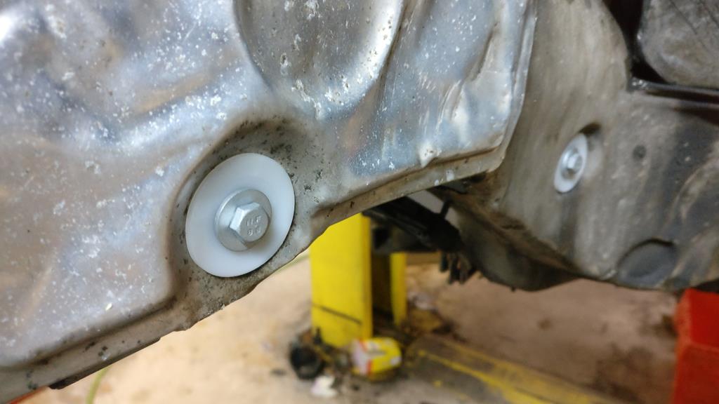

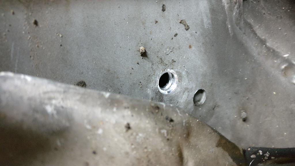

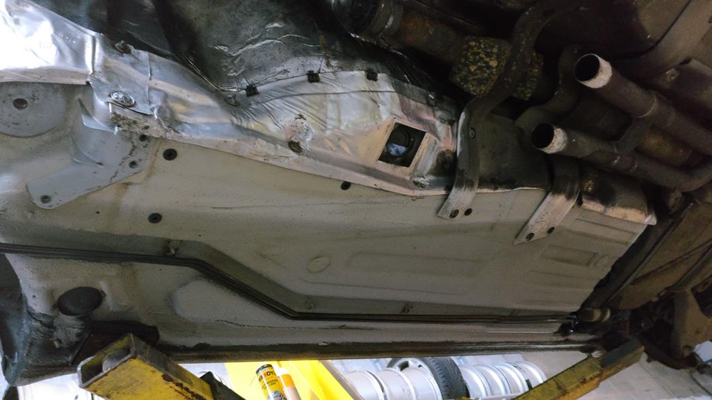

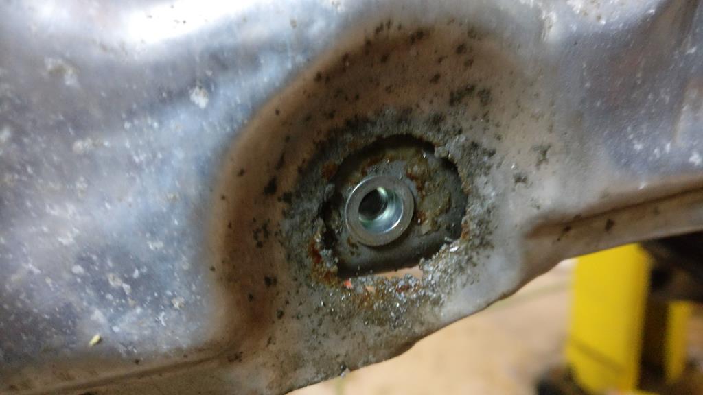

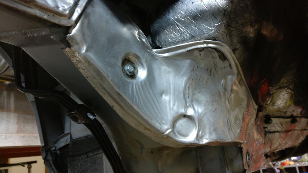

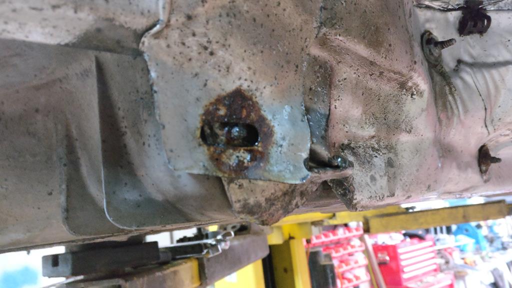

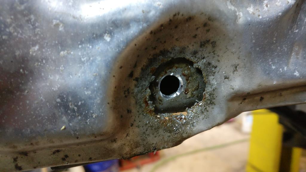

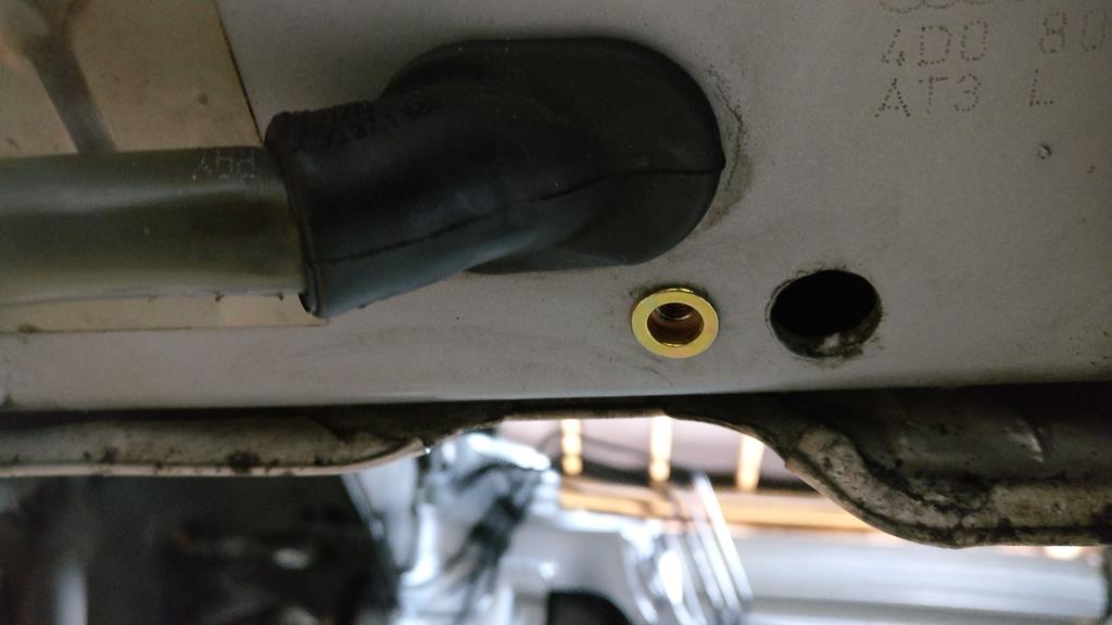

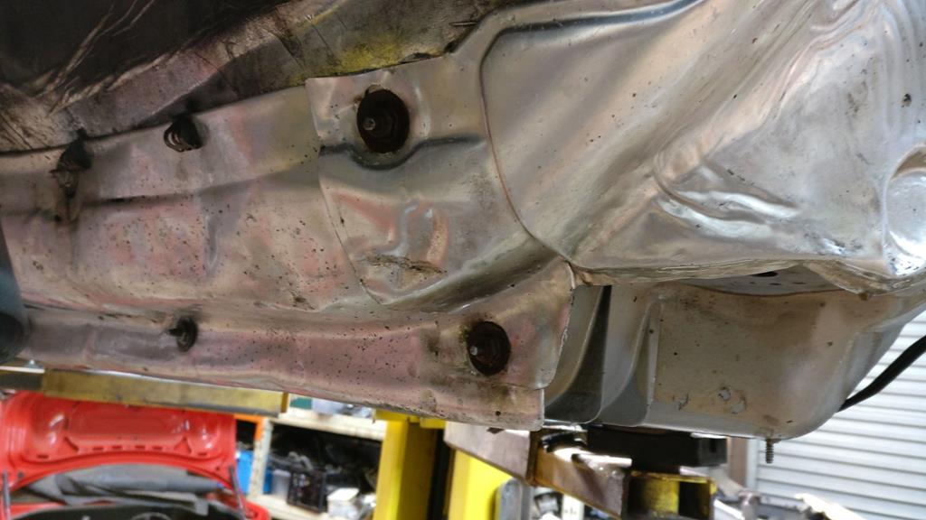

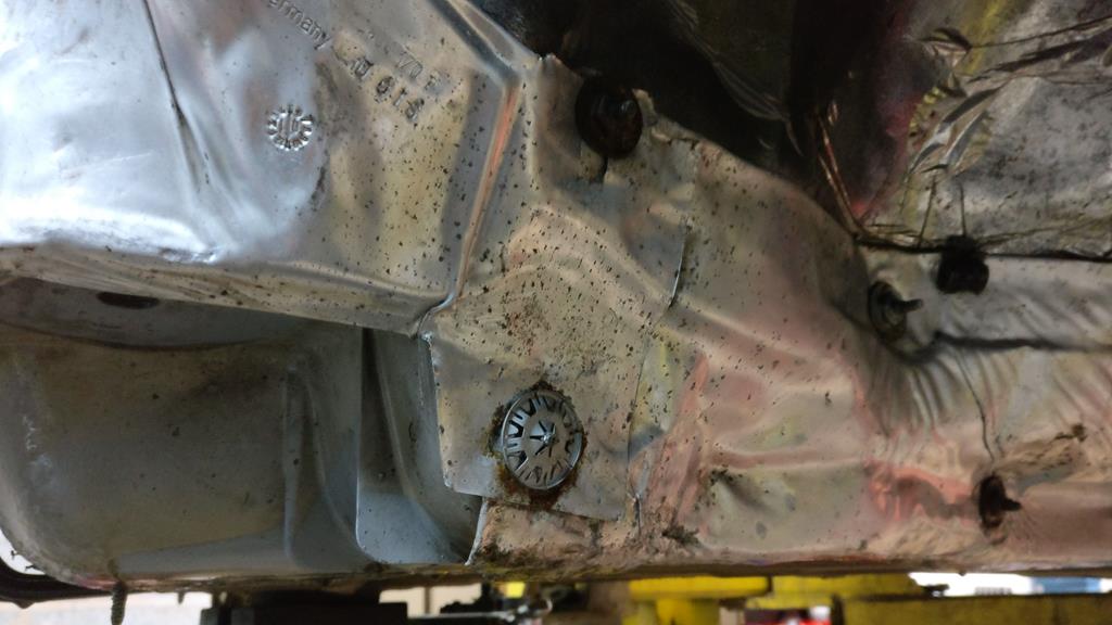

Rivnut time. Two studs on the heat shields are missing - one corroded away, and one broken off when the gearbox was refurbished, as they always seem to be.
Grind a divot in the stump

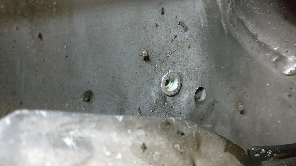

Pilot drill then drill to size for an M6 rivnut
Rivnuts inserted
Temporarily bolted in place while I wait for the new fasteners to arrive

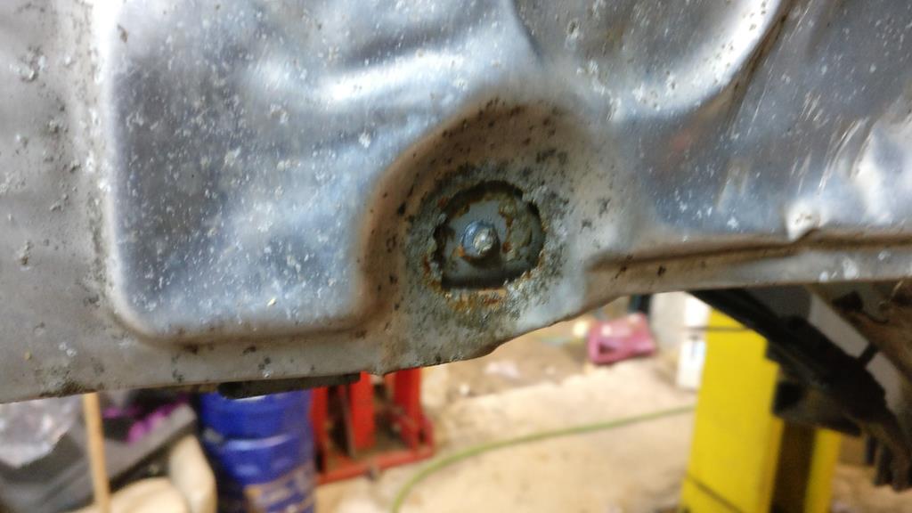

Another one above the steering rack. This is normally a stud, but with the tie rods attached it is impossible to remove the rack with it in place so I convert it to a rivnut
and another one in the usual spot to hold the starter cables

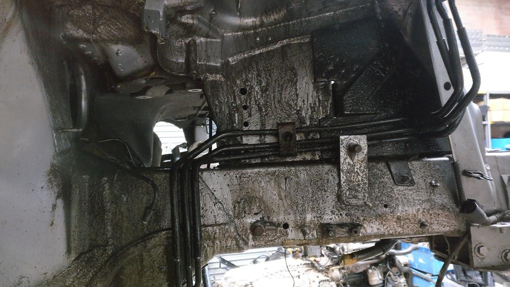

This disgraceful mess was also done when the gearbox was removed
it should look like this
better
cleaned up

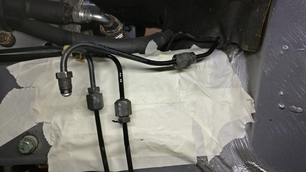

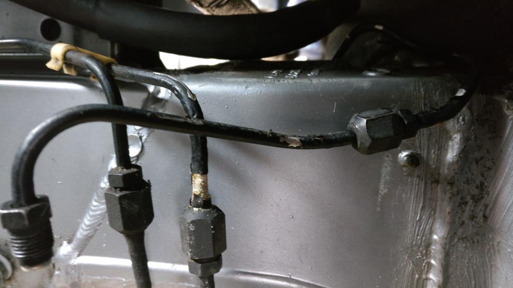

The brake pipes on the left are quite crusty. This looks bad, but its just salt from the galvansing underneath the plastic. The steel pipes are still perfectly sound
Scrape off all the salt and loose plastic coating
the clean up with scotchbrite on the rotary tool
and paint with rustoleum using a cotton bud as a tiny paint roller
Good as new

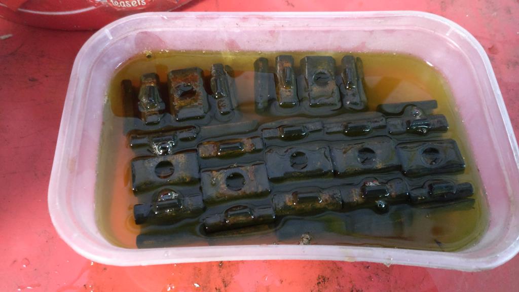

The fuel pipe clips will sit overnight in Evaporust

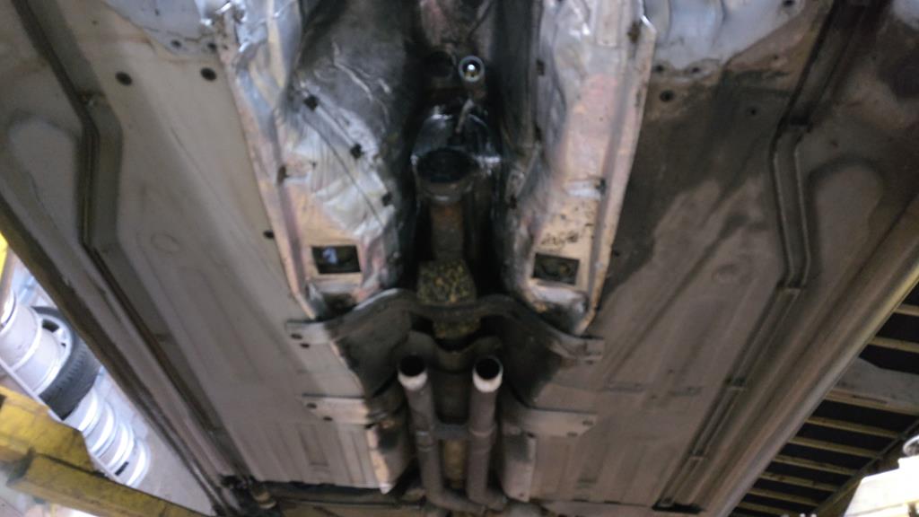

There is now You had to poke the OCD tiger

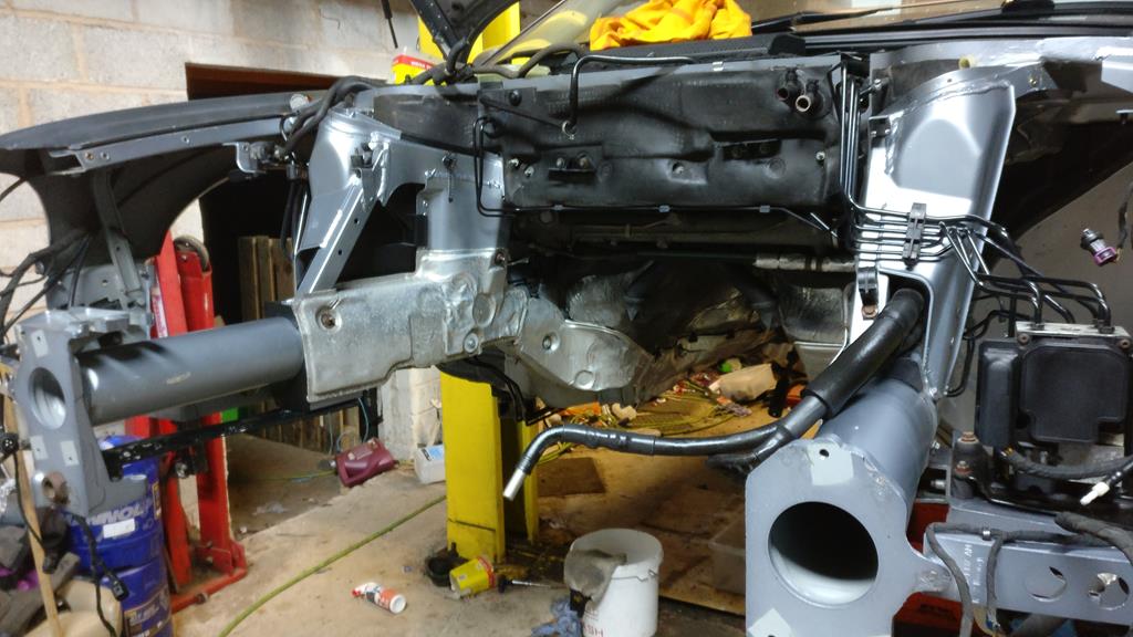

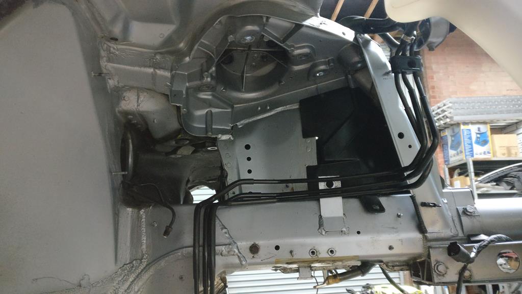

Yeah, I cleaned the floorpan

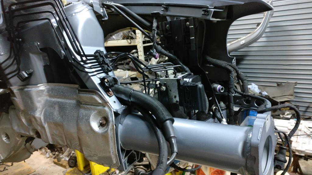

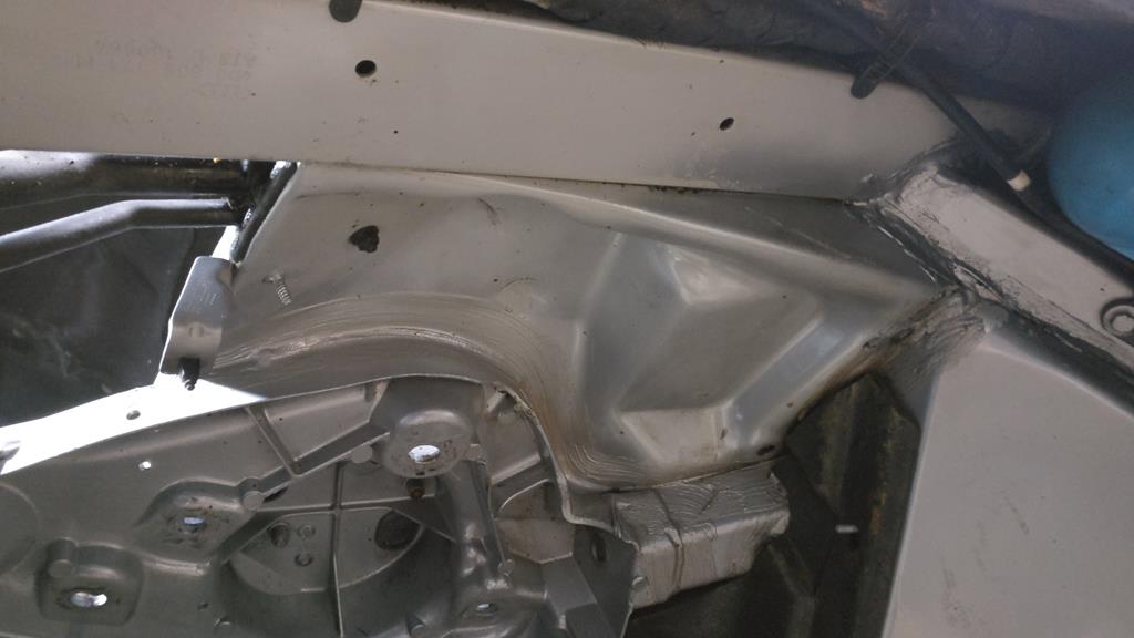

Engine bay all done and treated with sealant
