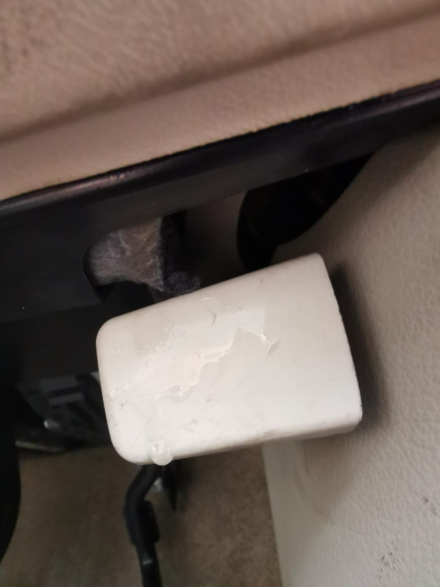

Had a rough week with the missus getting admitted nearly a week ago with a burst appendix, and shes had to have further surhery since and we've now missed a family holiday to corfu.
Anyhow went to get in the car this morning to be greeted by a swimming pool in the drivers footwell, didn't have time to investigate as i was on the way to the hospital so used another car.
Just got home so will have to have a look tomorrow, any advise as to which drains to check please

Originally Posted by Nognar View Post
HVAC orange drains by the transmission tunnel
I went to check the drain behind the footrest, but its bone dry there, it seems to be dripping from the dash as the bonnet release has water on it, any other ideas?
Old 26th September 2019, 09:39 AM
In that case could either be blocked sunroof drain, blocked scuttle drain or windscreen leak

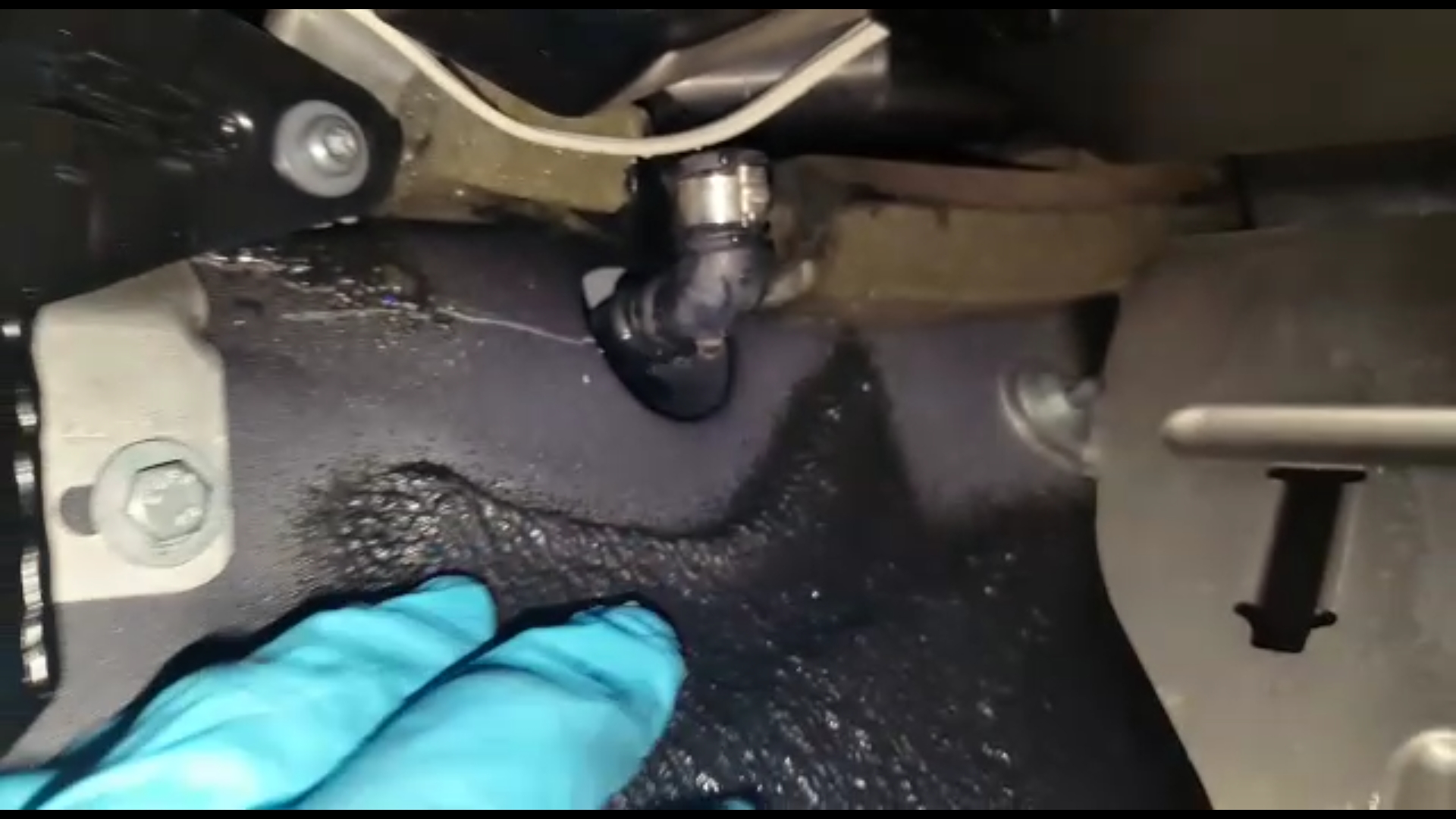

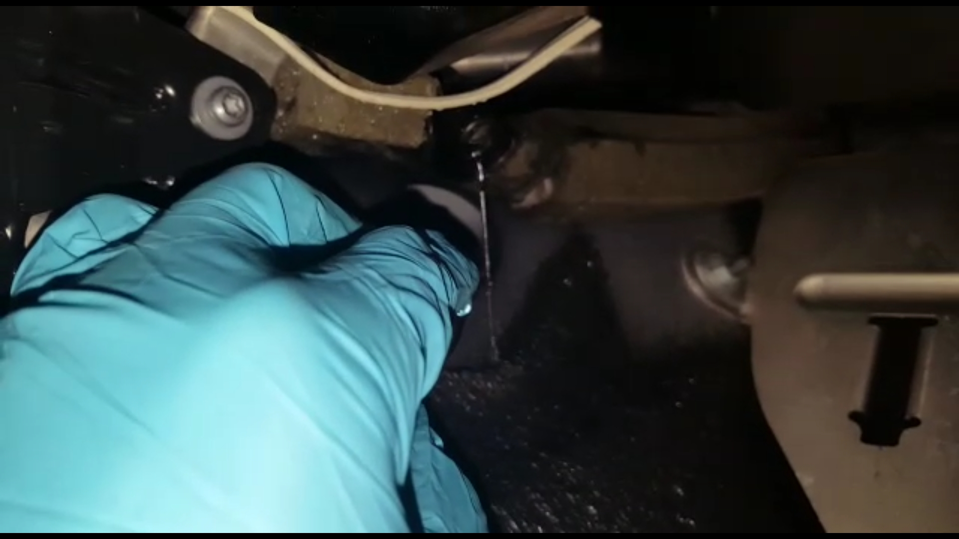

Old 26th September 2019, 11:35 AM
Mine was the aircon drains!!
ID:	22169   Click image for larger version
ID:	22170   Click image for larger version

Old 27th September 2019, 07:33 AM
Where are these located?
Either side of the tunnel up nearly as high as the top as the footrest but back towards the driver by about 9 inches as per pictures for drivers footwell. The other side is reflected on the other side of the transmission tunnel but same position
