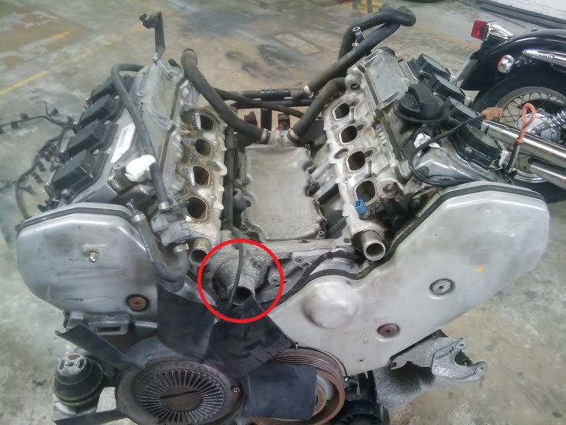

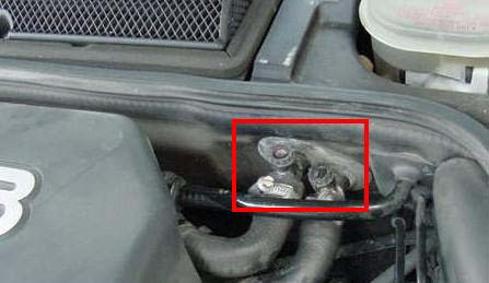

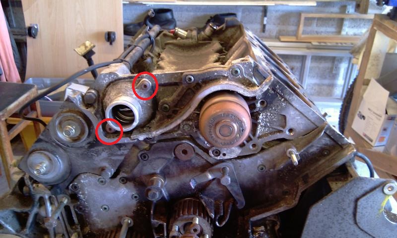

The pump is beside the thermostat so you can change it out without even removing a cam cover. Only 2 bolts too and not 3 as i eariler suggested
Conan kindly removed an engine so we could get a better look.
The system is fitted with bleed valves on the pipe at the bulkhead to make that bit esier for you and try that first i would.

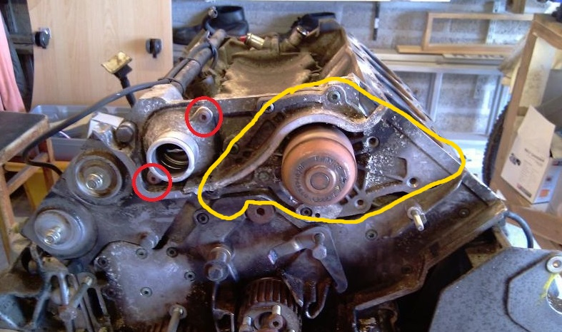

Yours is FL so thermostat will be behind cambelt. While it is possible to do it without front end removal it's a lot easier with it in service position. Dezzy's pictures show PF which is a lot easier to change thermostat but pump is belt off job on PF as well.
Just for reference if somebody else is looking circled in red in Dezzys pictures is thermostat, the water pump is in yellow below.
