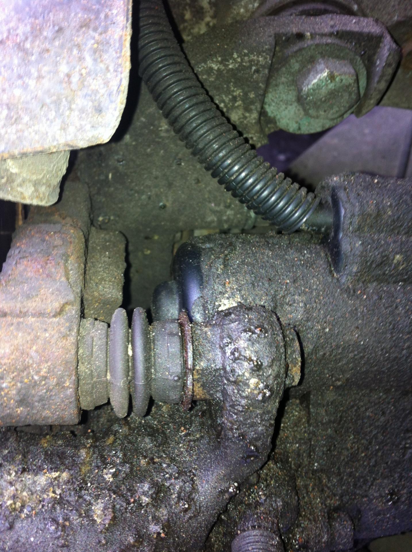

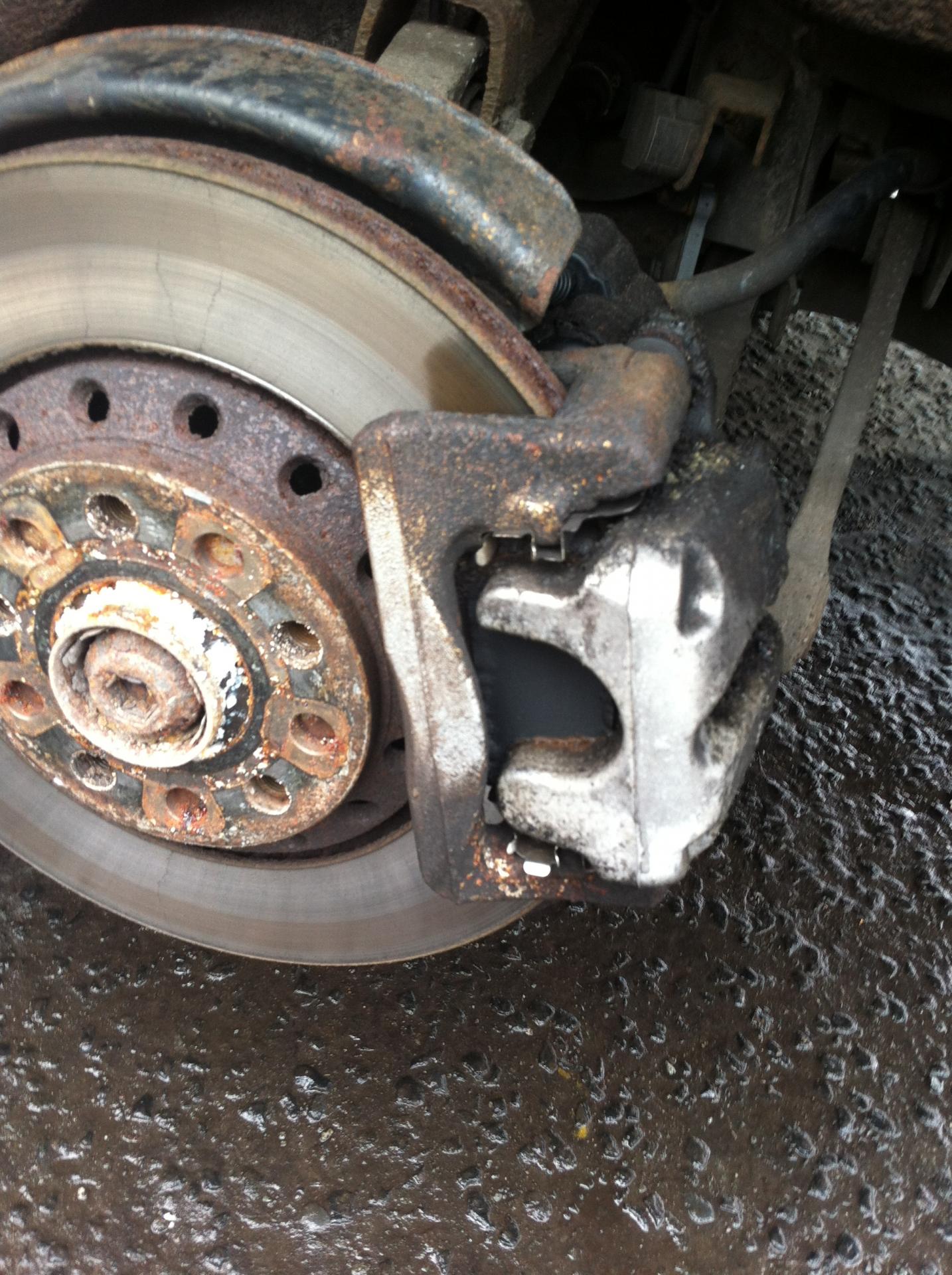

I have replaced the MMI with once off A8Parts and all is well. Well I have a working 'CAR' button and I can engage jacking mode etc. One thing I did notice is that I cant find the tyre pressure menu in the 'Car' menu.
Also when I finally got the wheel off there is a broken brake pipe which has leaked all over the back of the alloy and the disk thingy!! pics attached.
Is this an easy fix or is it easier to let a garage do it?
I need to concentrate on the parking brake now so tips and advice welcome
anyone need an MMI without working 'CAR' button? Im sure it can be repaired as mentioned earlier.
Not done a scan yet since replacing the MMI but will do tonight...

Not sure on the TMPS issue, but could be needing coded.
If that's the same side as you're getting the failures on, then that makes sense.. Possibly brake fluid in the EPB mechanism.
