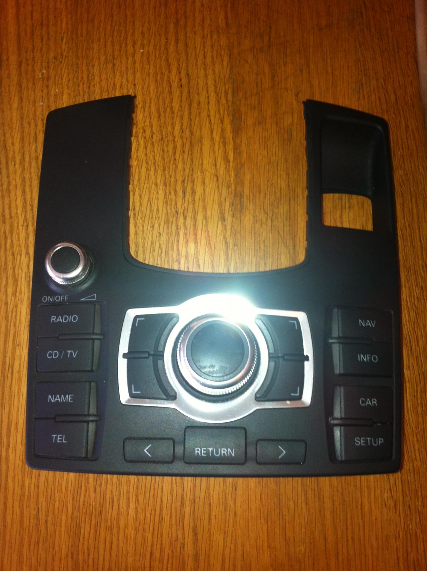

I am having a nightmare with my A8 at the moment. I have a flat tyre and went to get it replaced only to be told I need to put the car into 'Jacking Mode.' protects the air suspension
Well my 'Car' button isn't working and never has (since I've had it) so I cant get into jacking mode which means I cant change my tyre -
I have removed the MMI module with help off here - very simple and took 15 mins to have the unit indoors. I cleaned it all including connections, put it back together and its exactly the same - except the 'Setup' button is no longer sticky. I am guessing I need a new one??
The part number is 4E2 919 610 - I'll attach some pics too...

Really? - I'm scared now as the 'tyre man' said he has seen air suspensions burst when dropping the car back down. I believe they are quite expensive to replace! As well, it would be nice to have the Car menu working anyway!
I have an old OBDII connector which fits the car fine and I get a power light on the device however when I run the VCDS test I get Port OK, Interface not found so I am wondering if I need to get a specific Ross Tech cable!!
