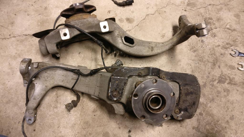

Is that suspension strut (or whatever it is called) aluminium on FL cars?

Yes, facelift with 17 or 18" wheels had aluminium uprights / knuckles / achsschenkel with bolt-in wheel bearings for either Brembo or HP2 brakes, save for the first 500 cars which had a unique steel one. Factory FL with 20" wheels all had steel uprights, again for Brembo or HP2, but with a larger bolt-in bearing.
All FL had aluminium rear uprights too.

That's interesting!
I had 20" wheels from D3 on my PF S8, and it was just horrible to drive. I thought maybe I had too much unsprung mass, because I had read that FL cars had more aluminium on the chassis. But strange to hear that factory 20" had steel uprights. Bigger bearings make sense. There's a reason for everything I guess.

Some edge-case where the original design calculations showed the alloy upright and / or 82mm bearing wasn't strong enough with the extra rotating mass / inertia of the 20" wheel I think, so they went for a steel upright and 92mm bearing, making the unsprung mass even worse!
The D2s with 20" wheels ride remarkably well though tbh.

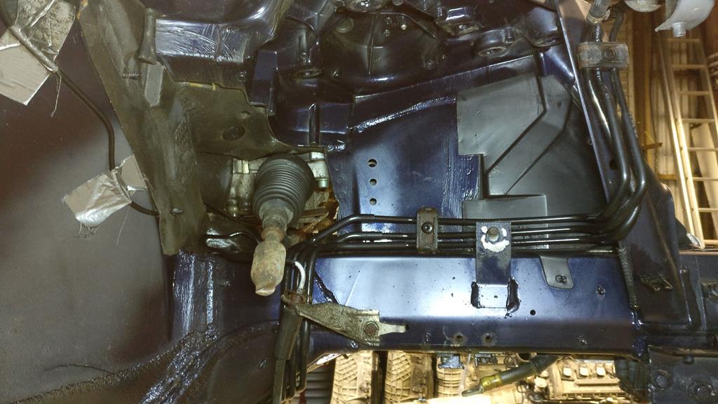

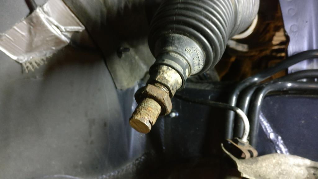

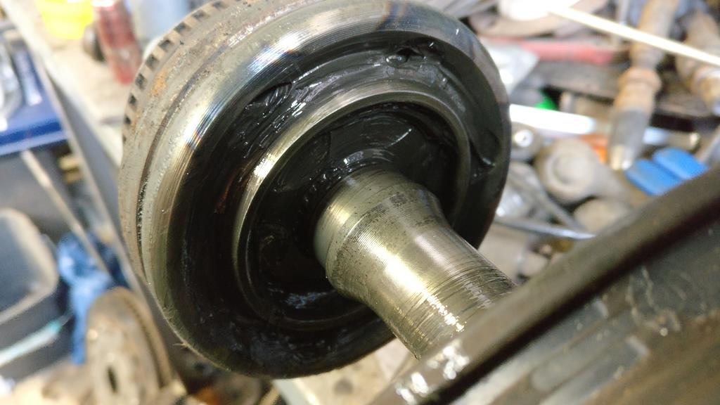

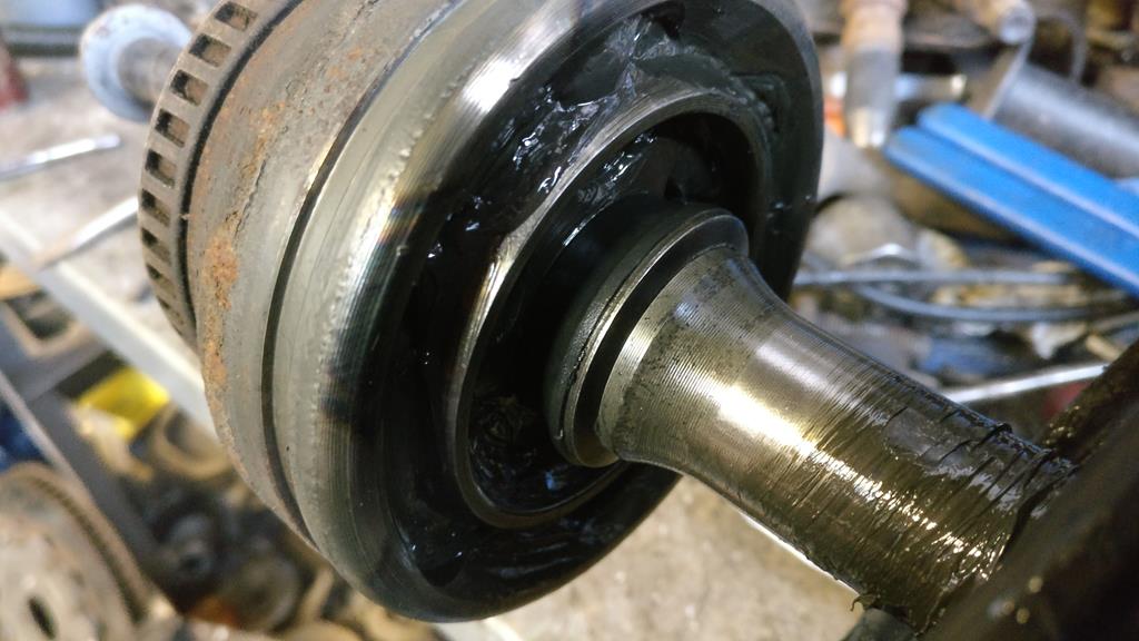

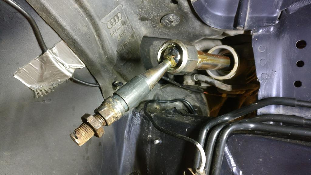

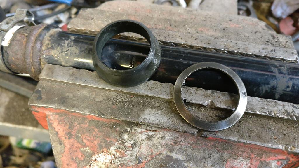

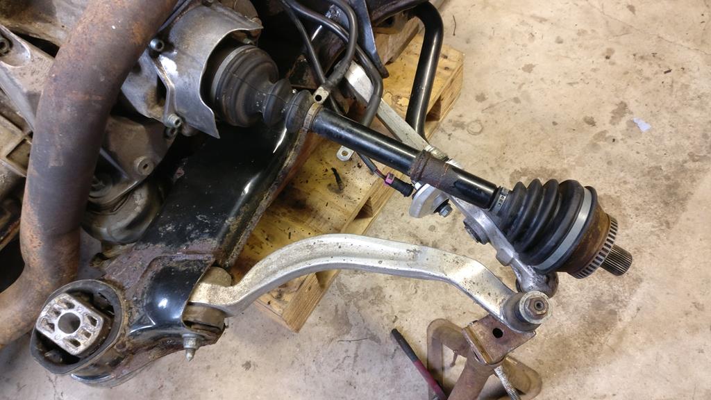

Did the other upright yesterday. The tie rod bolt came out with the nut method, as did the pinch bolt, so only two hours for this one.

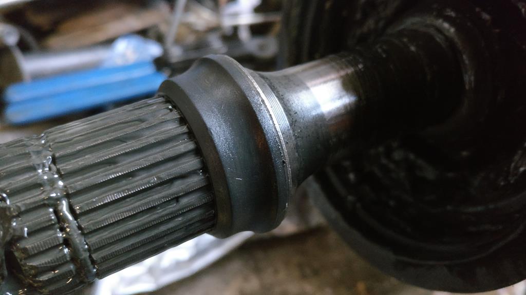

I replaced one of the CV boots (I've shown that before) but when I checked the other shaft I noticed the outer joint was loose. Its oddly common for people to reassemble the joints incorrectly when changing a boot. I have no idea why. As usual with this issue, the spring washer and spacer were missing
Luckily I had these two spare
Boot on first, then the spring washer, then the spacer
Should look like this:

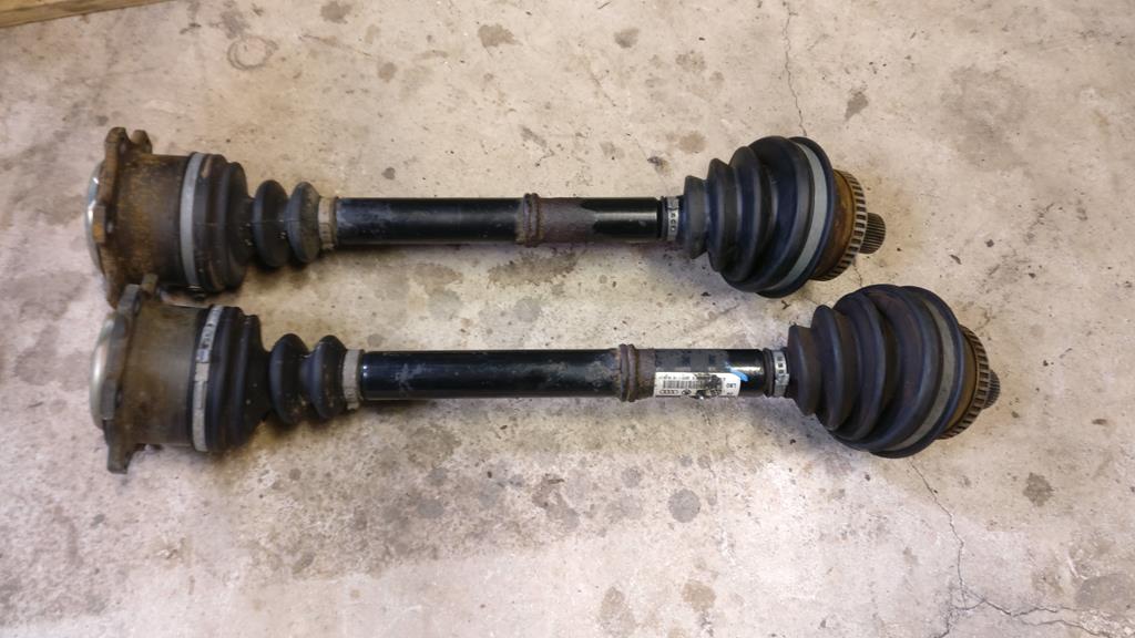

Both shafts ready to go back on
So I put them back on

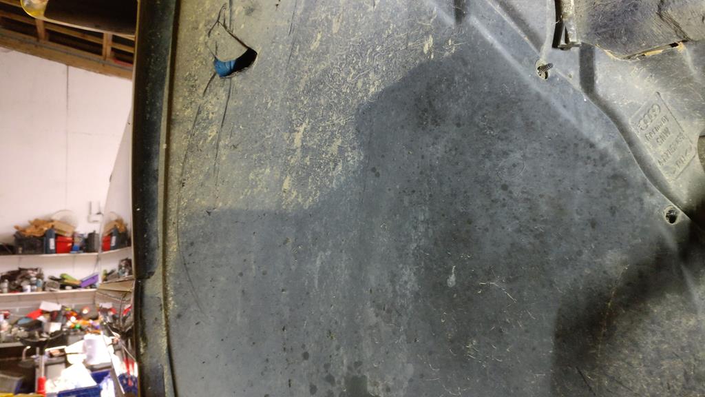

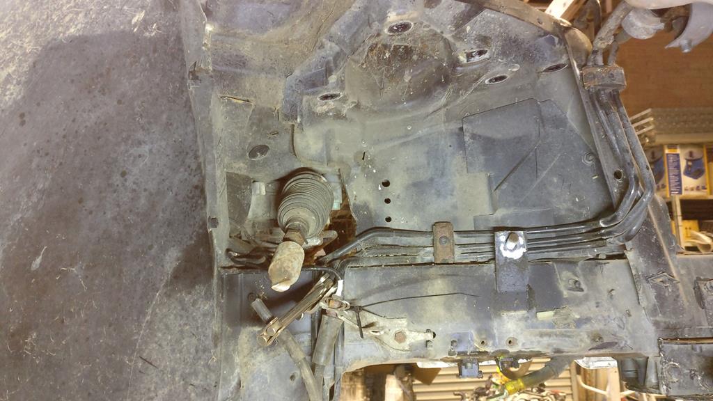

That's as far as I can go with the drivetrain now, so on to the car. This has been a city car so the arches are full of cobwebs rather than dirt
Both front and rear halves of the arch liner are damaged on this side. I think its run over some road debris like a traffic cone

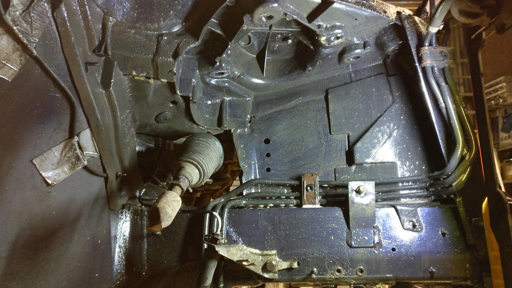

Clean with Gtechniq W5 all purpose cleaner
Much nicer to work in

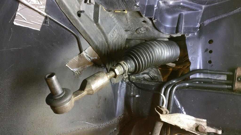

The tie rods are utterly seized and are never coming apart
Rescued the boots as they are just fine
Luckily I had some good original inners and low mileage Lemforder outers in the box of useful things so stuck those on. Same on the other side.
