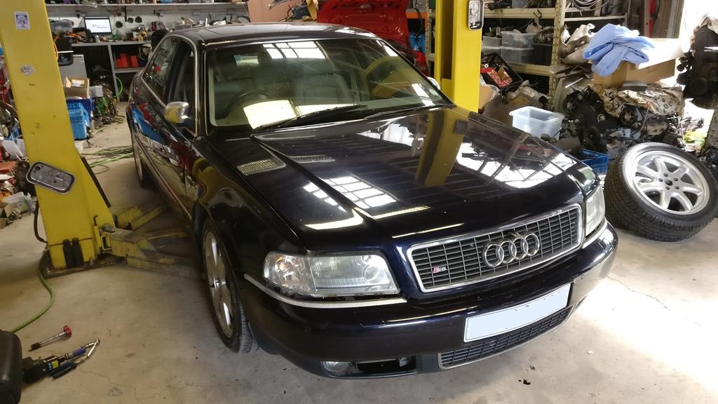

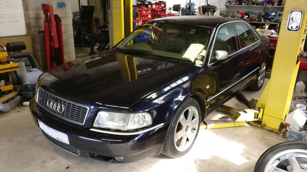

Miss September is Gareth's 2001 Ming Blue which he found under a tree, as introduced here Things have obviously been on hold in the workshop for most of the summer, but this one has been stood for so long it needs rescuing before the winter before it deteriorates even further. So, this isn't a restoration this time - that will come next year. Instead this is a basic recomission: get it running and MoT'd so it can be used.
It scrubs up reasonably well:
A little grubby under the bonnet:

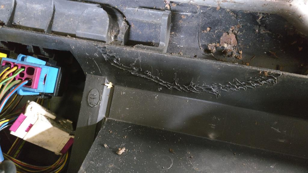

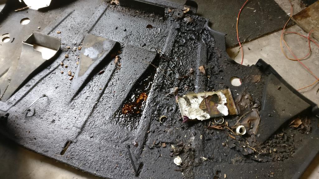

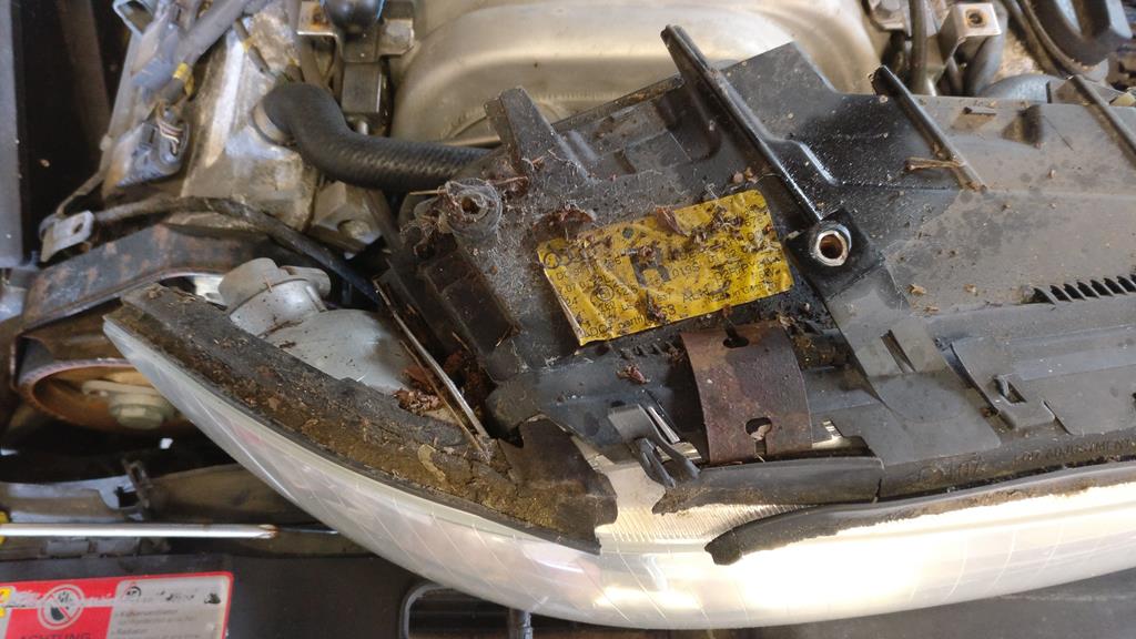

A bit of an oil leak, and also some squirrel signs
Some nibbling has happened!
There are nuts and seeds and detritus stashed all over the place!

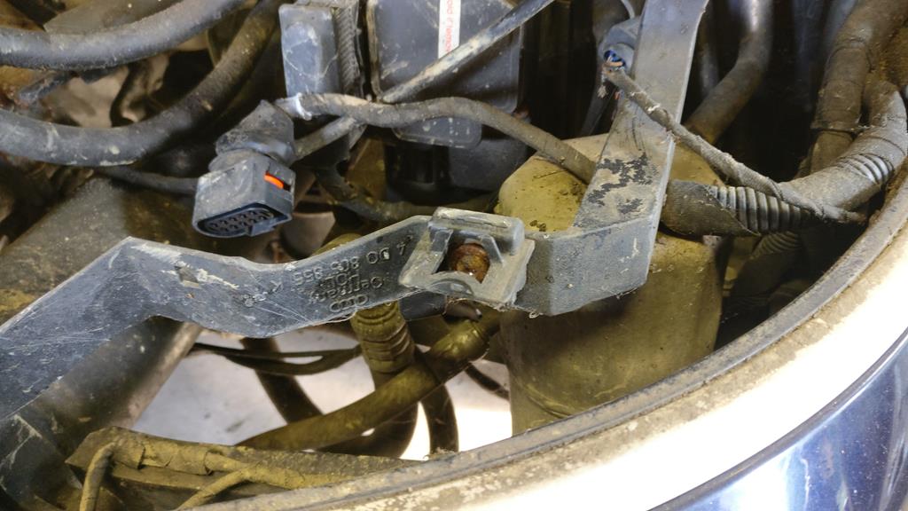

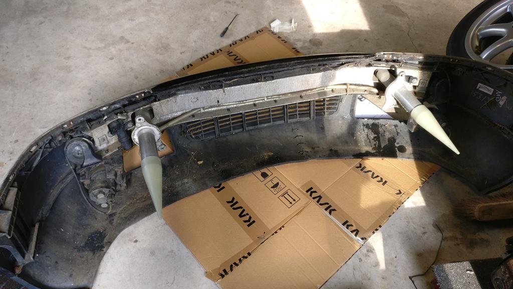

The bumper had to come off with both supports I will deal with that later

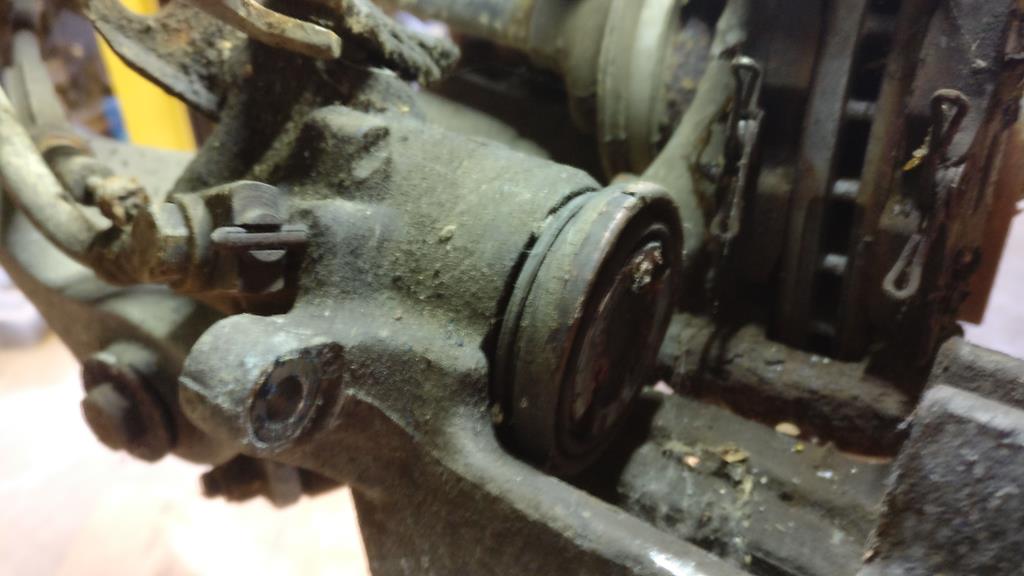

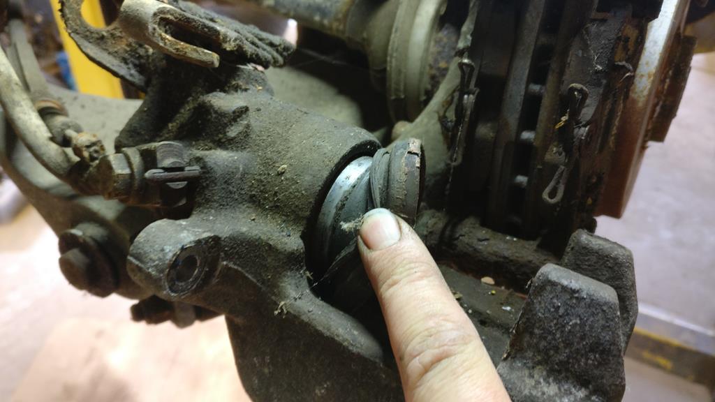

It was very difficult to push the car, and it turned out the rear right caliper was seized, due the usual fault:
I removed the pads and put this back on for now so I could roll it on and off the lift since I will need to get in to the interior to figure out the electronics issues.

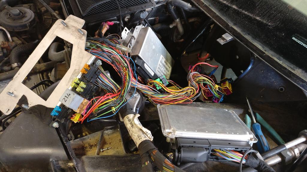

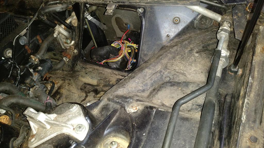

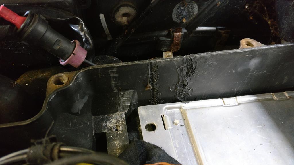

I had a better look at the electronics box. This is 'interesting'
Erm...

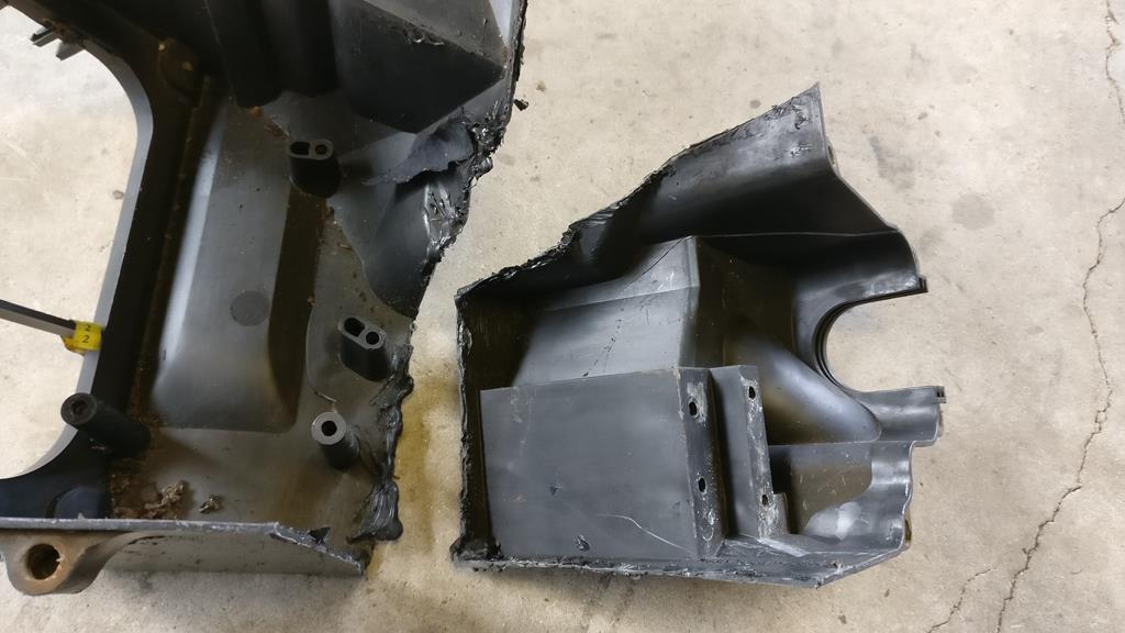

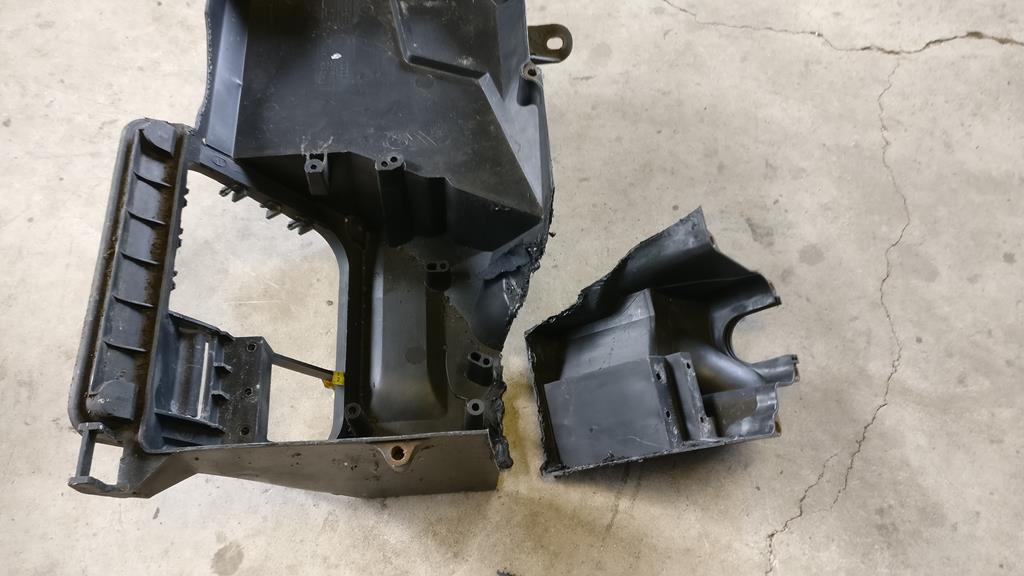

Time to remove it and see what's going on which reveals possibly the most heinous bodge I've seen so far on the D2 - someone has sawed the front off the electronics box, then glued it back on with silicone sealant
No wonder the poor car had issues with water ingress! I think this may have been done to change the heater valve block, considering where it was cut. There is evidence that someone attempted to remove the electronics box, failed, and broke it in the process, so just gave up and cut it apart I'll be replacing that then, after I've done Botang's hole.
How on earth did you manage to get that off? Do you have small magical elves in the workshop?
Take the headlights out to get to the upper bolts, then do the lower bolts through the foglight grilles It takes some wiggling to get it past the AC condenser pipework, but its possible. Not my preferred method of removal obviously, but necessary when one or both bumper bolts are seized!

Today was electrical shenanigans, which I want to sort before taking everything else apart.
It won't start on the key so I started with that - turns out the F125 is not sending the P/N signal to the interlock relay. That's easily bypassed for now using the same solution as for the manual swaps:
Based on Andrew's investigations, this should be the upper pair of the four large contacts in the F125 so I will sort that when I get underneath. I'm still undecided on whether the engine is coming out of this one.
So, now it'll spin over on the key but won't start. Attempring to start lights up almost every error light on the dash and the TCU instantly goes in to limp mode with canbus errors in the TCU, cluster and ESP. Interestingly, during this the ECU is quite happy to talk to VCDS, but isn't powering up anything on the engine.

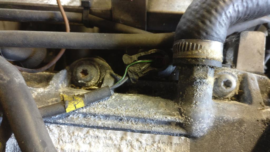

There is a loose connection or broken wire in here somewhere
I started off checking canbus connectivity - that's all good, so it must be a power supply problem. The ECU has a number of supplies - switched ignition (T15), permanent live (T30), and a switched live from the main ECU relay.
The start-up sequence is normally T15 from the ignition, then the ECU powers up the main relay (from which it has a feeback wire) then, if it doesn't immediately see an rpm signal from the crank sensor, it will do a self-test on the throttle body.
I started with T30 - all good there, 12V live. Then T15 - switch on the ignition and all good there too. So ECU relay then? No - that powers up fine, switches on the coils and injectors. Odd
So I turned the key and it started! Poking it yesterday broke it, and poking it more today fixed it, so while it was running I went round poking it some more I touched the main ECU fuse on the T30 supply and it shut down instantly. On investigation it turns out that the water ingress in the electronics box has caused corrosion on all of the fuse holder contacts and the fuse terminals. It seems that with switched ignition only, and not its permanent live, the ECU can power up enough for diagnostics but not enough to run. Motronic ME7 has a 'boot mode' which allows it to be bench-tested and flashed without throwing error codes. I suspect it was in a similar state to boot mode in this case.
With that sussed I cleaned up all the terminals and replaced and the fuses and now it fires up on the key, and stays running while poked Success! Someone has clearly been tinkering in there before and this is very likely why it was parked up.

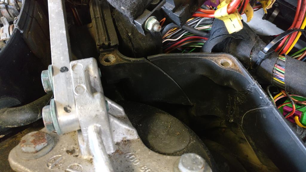

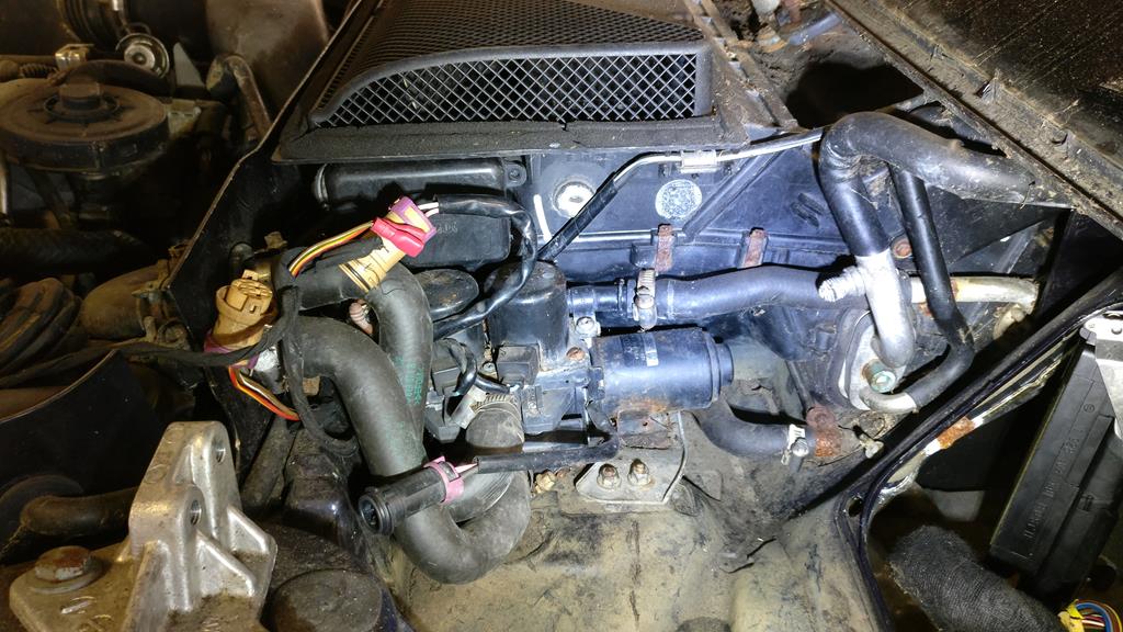

Looking at the heater valve block, it is clear that the perpetrator of the electronics box mangling did so in order to hack at the valve block. There are at least six things wrong in this picture
1, the air intake servo cover screws are missing
2, the valve block is a PF / FL1 unit with the wrong connector
3, the valve block is hanging off the hoses as said perpetrator hasn't attached it to the bracket
4, the FL2 connector has been cut off and replaced with spade terminals
5, the recirc servo wire is routed incorrectly
6, the hoses aren't even attached properly
With that all fixed properly I moved on to cleaning up in preparation for Botang's hole and replacing the electronics box.

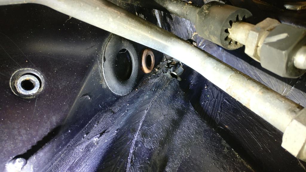

Botang's hole - as usual the tape just fell off while cleaning up.
I did the usual fix of filling the hole with a plastic rivet and then covering it up with seam sealer.

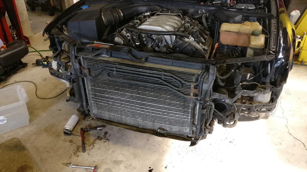

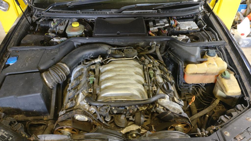

Ship-shape in the electronics box again, and the engine fires up and runs just fine now. No codes or chain rattle, so just the starter interlock in the F125 to sort.
After this though, it became clear that the drivetrain needed to come out as 75% of the fasteners are seized, the suspension and pinch bolts particularly so. Once the suspension struts are out, there's really only a handful of extra bolts to remove to drop the engine and gearbox, compared to what I already had to take out for the task list.

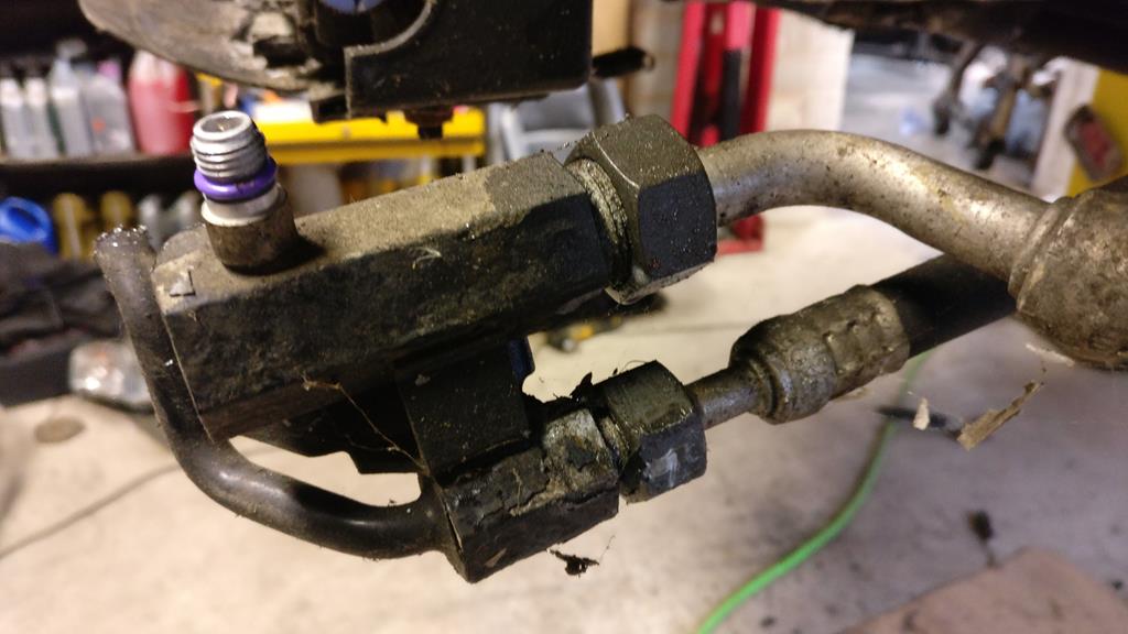

The AC condenser is toast, so I just cut off the fittings to save the hoses.
These go in the 'deal with it later' pile

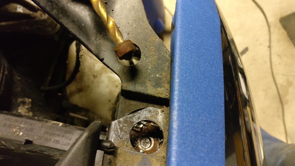

First time I have had to drill out one of the front panel bolts This one came pre-rounded and thoroughly seized. Later...
Top side of the engine all detatched, fighting all the way, everything seized
Exhaust, driveshafts, prop, then drop the drivetrain tomorrow. Luckily I have a lot of parts on the shelf to replace the many of the things which are broken or now have snapped or drilled out bolts stuck in them That being, of course, the reason the car is here and not anywhere else
