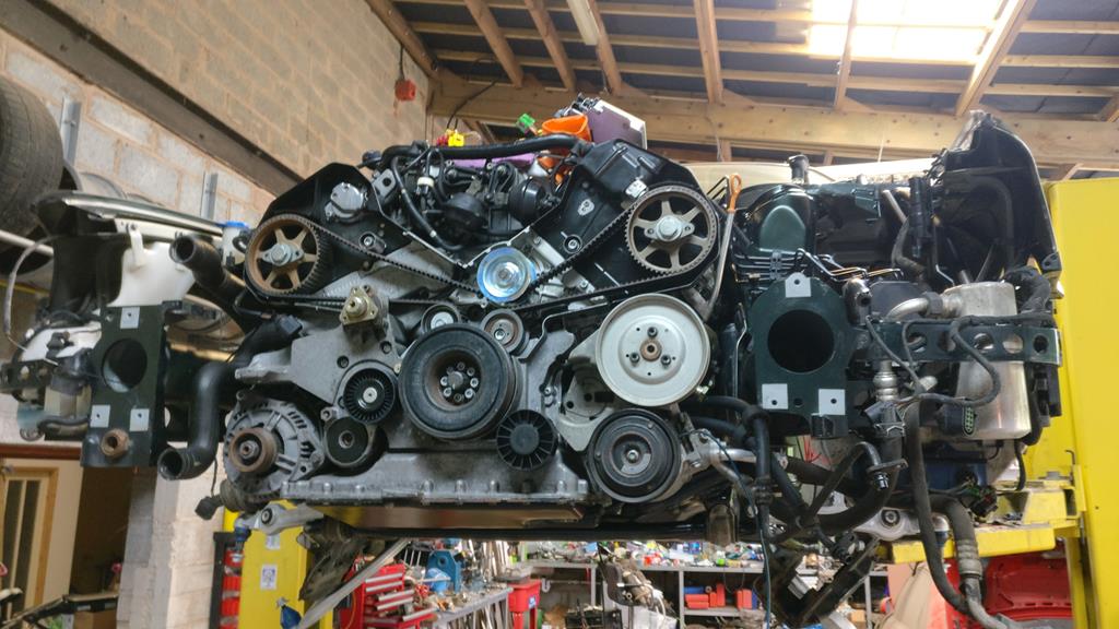

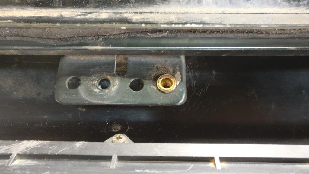

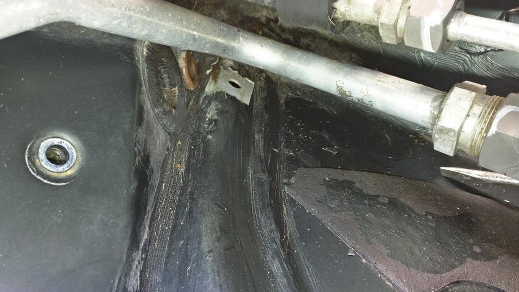

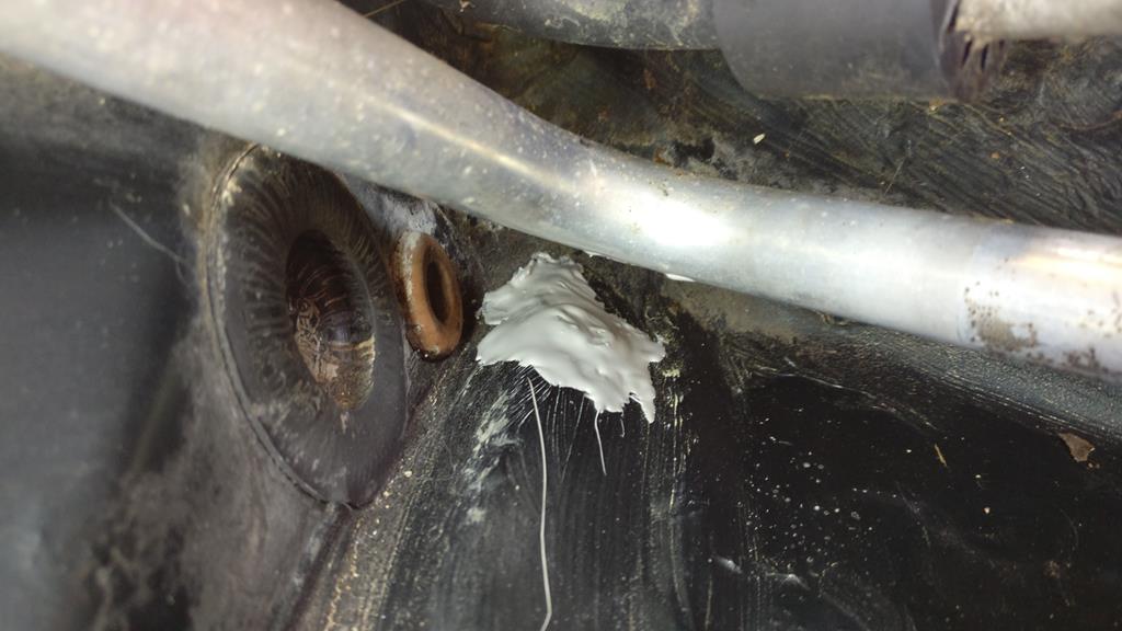

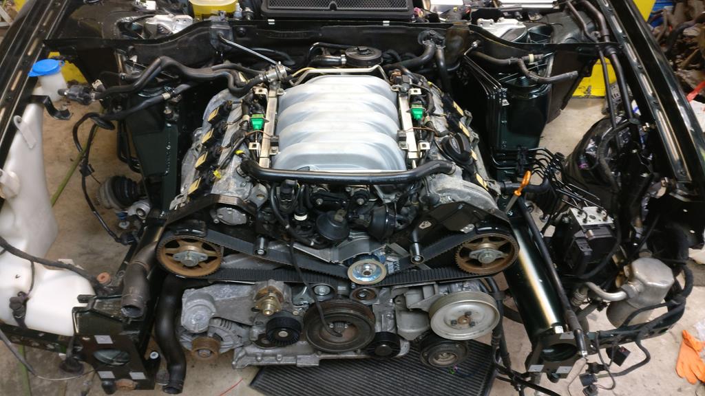

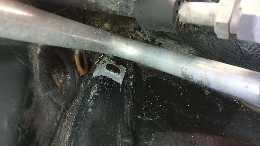

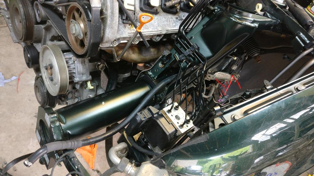

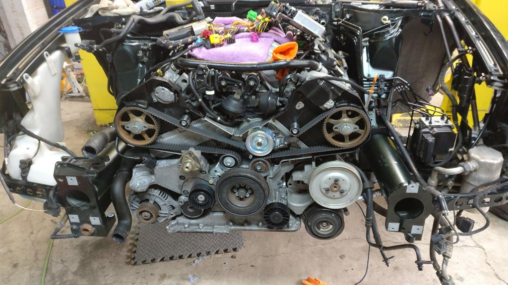

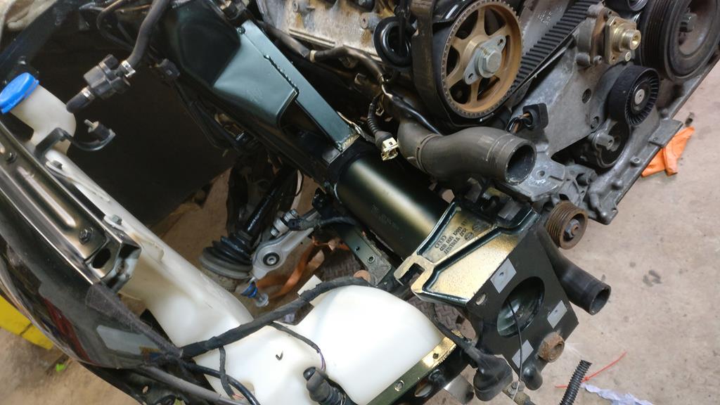

Another good day today thanks to Mike coming over to help
Got the fan finished off
Some trauma had happened with the centre scuttle trim bolt so I put a new rivnut in there
Botang's hole
MJ's grommet
Bedded down on seam sealer
and then covered completely
I completely forgot to get any pics of detailing the engine bay and fixing broken studs, and then we put the engine back in
Nice and clean and treated with sealant
Most of the top end back together
Pretty sure that was the windscreen fitters who replaced it before my ownership; they had no idea how to refit the scuttle cover and just drilled it out and bodged it.
Wrecked the scuttle cover as well with what they did.
This time the windscreen will be replaced under MJs eagle eyes and they won't touch any of the trim!

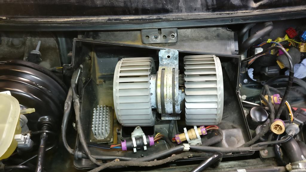

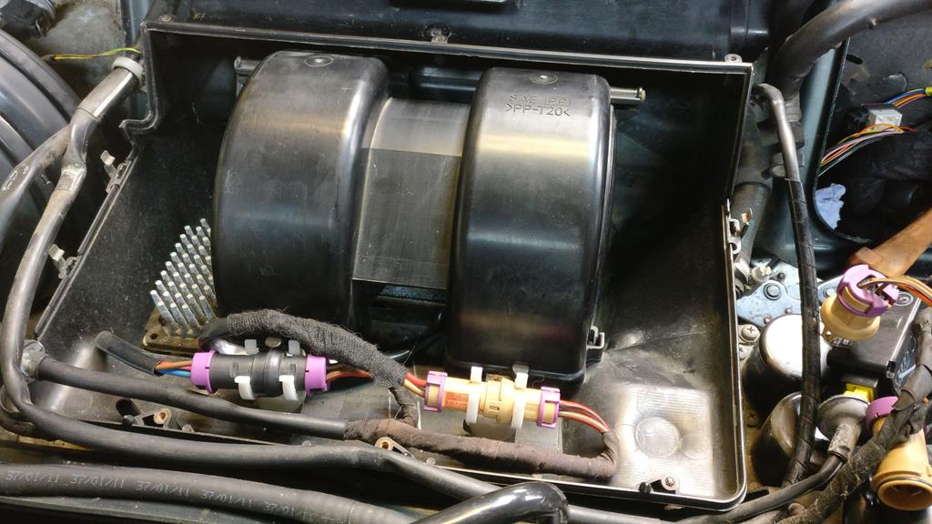

The blower motor is getting replaced with a D3 version which is made considerably easier with the ecu box out as well
What's the benefit of using the D3 version? Is it that the D2 is nla or is the D3 version better and quieter?
Cars...
  #69
Old 23rd May 2022, 11:05 AM
Ronin Ronin is offline
Join Date: Jul 2019
Location: Wales
Posts: 847
It's the same part with different connector that has reversed polarity. D2 part is NLA.
