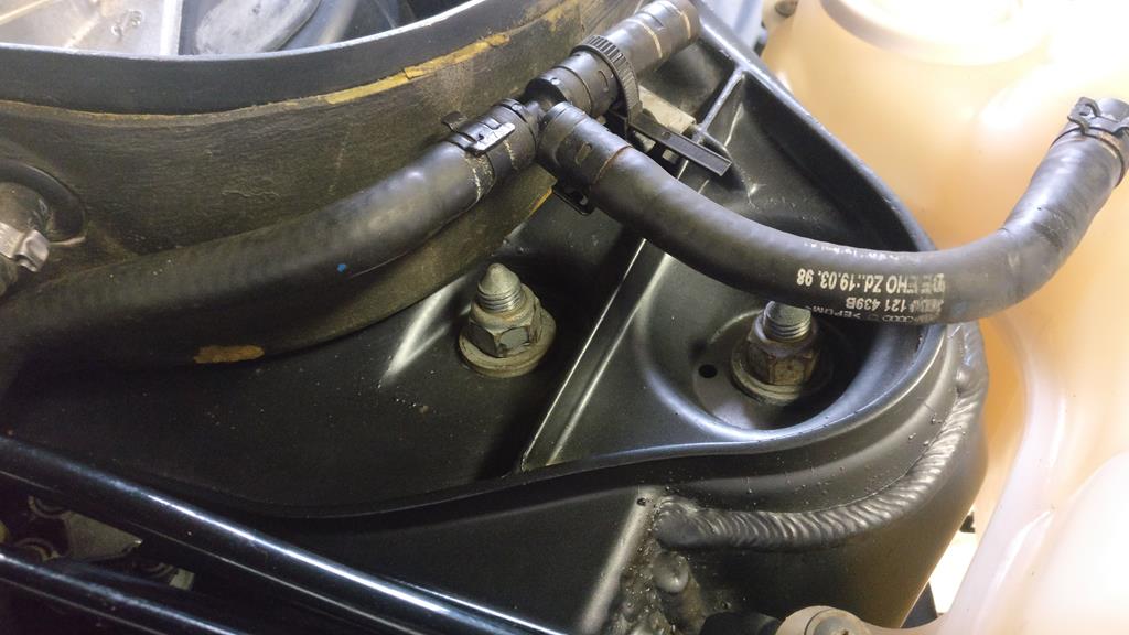

Why do you call it Botangs hole and does it eventually let rain water in from the road?

Because a forum user called Botang found it Yes, eventually (and already on most D2s) the tape dries up and peels away from the hole and lets rainwater in (running off the screen) which drips through the indicator relay in to the main relay box.

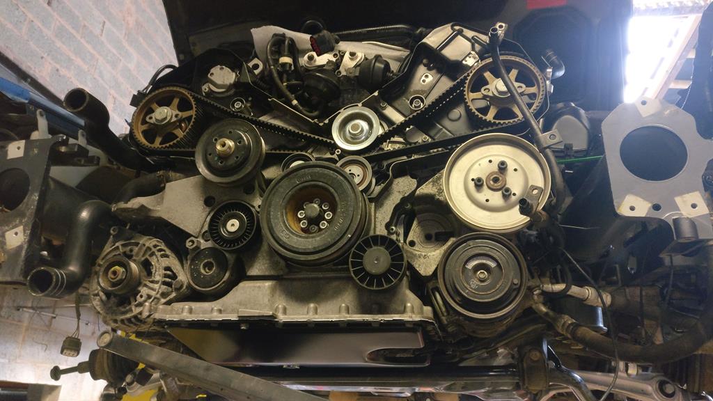

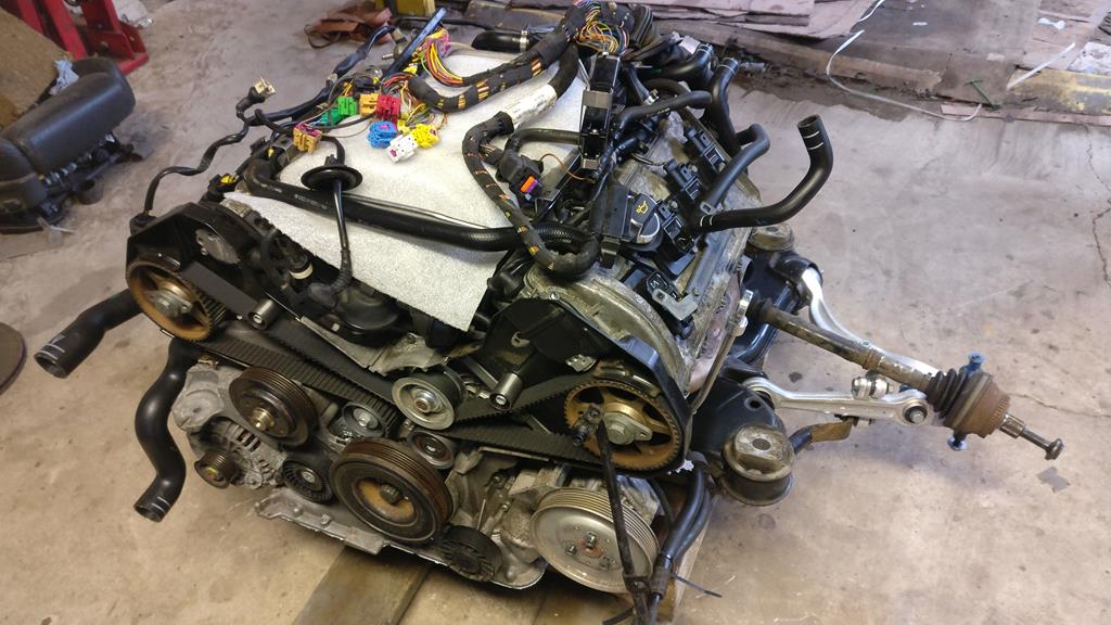

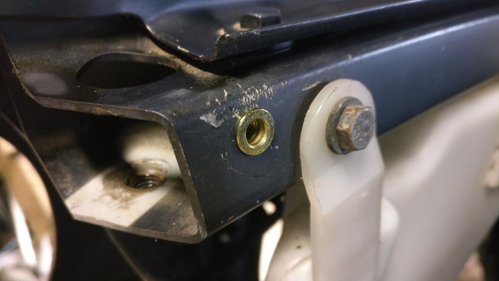

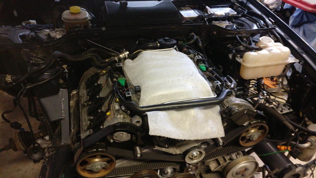

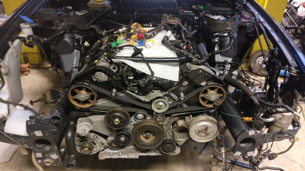

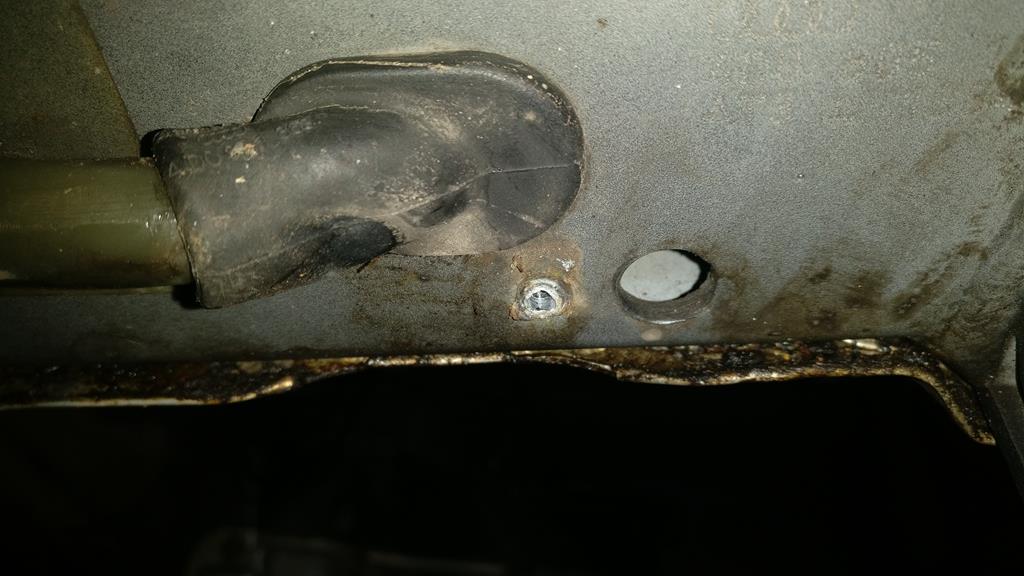

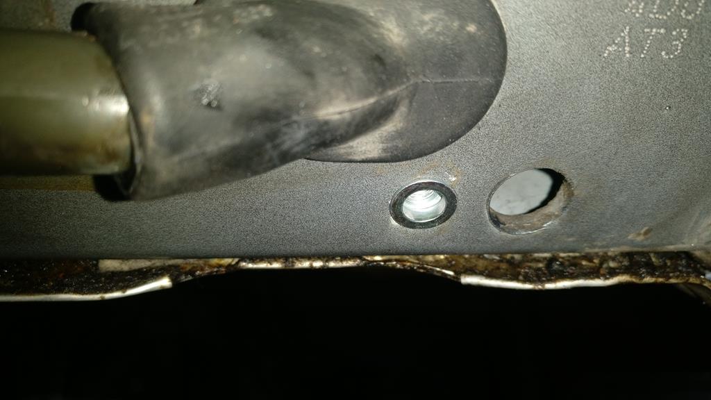

Finished off preparing the engine bay today. prior to putting the engine back in. I started by converting the stud by the starter junction to a rivnut. This always snaps because it has a steel nut on an M6 aluminium stud but I'm used to dealing with it now.
Pilot drill the stump
Drill to 9mm
Rivnut inserted
I also put rivnuts in the usual places in the bay
This stud is always snapped when the gearbox has been removed. I'm not sure why, but I managed to get a snap washer on the stump so it doesn't rattle

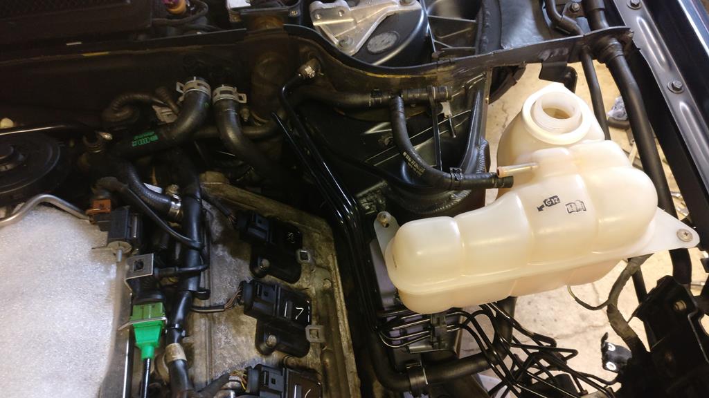

Engine ready to go back in:
and back in

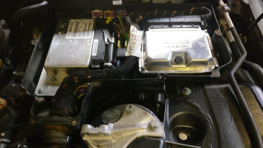

I got most of the gubbins underneath hooked up this evening, and I can work on the wiring and plumbing tomorrow

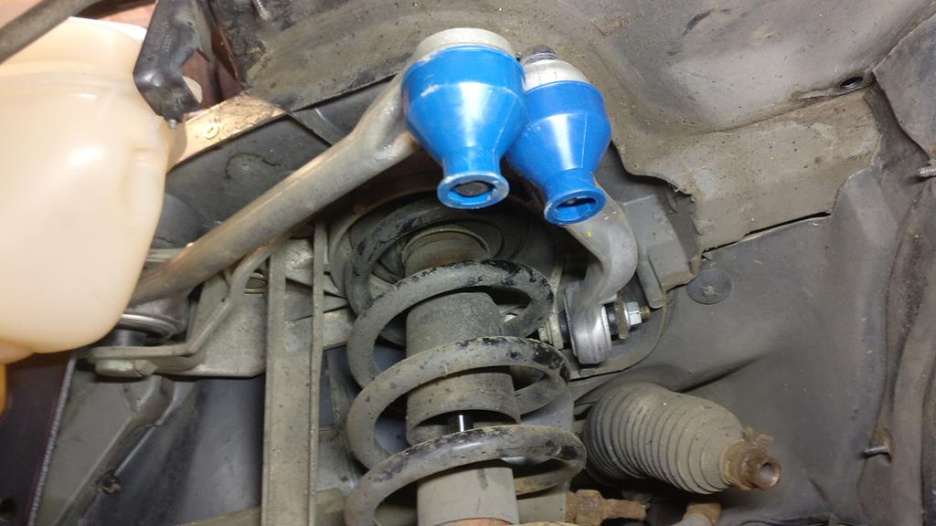

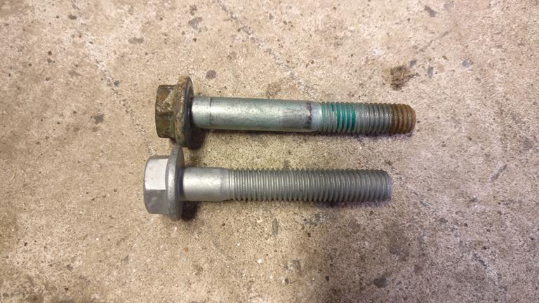

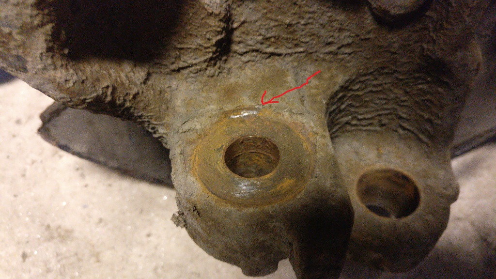

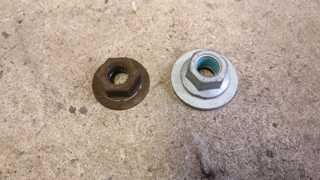

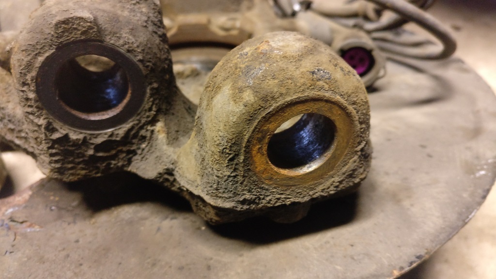

I finished off under the car so started on wiring and plumbing
I put the upper arms and struts back in so I didn't have to move the coolant pipes out of the way later
Worth noting that the Meyle arms come with the incorrect hardware in some locations, notably the bolt for the upper rear arm is too short and won't engage with the locking portion of the nut
and the lower front arm for steel uprights comes with a balljoint nut for aluminium uprights. I need to see if the proper nut is still available.

Old 8th June 2021, 03:37 PM
Ronin Ronin is offline
Join Date: Jul 2019
Location: Wales
Posts: 847
I have meyle on steel uprights. Is this just OCD or a proper safety issue?
  #79
Old 8th June 2021, 04:05 PM
Its actually not a big problem if the larger nut actually goes on the front lower arm as there is room for it underneath. I've been led astray by this one having the nuts in the wrong place!
You can see the shiny mark here where the wrong nut which came off had been interfering. It might just bend the washer when its torqued, but thats not right either
The steel uprights are supposed to have two of the small ones, but there is room for the larger one on the lower front so its not a problem if the surface is clean and flat and the nuts go on the arms with which they were supplied.
The proper ones are still available for £5 each so I will fit those anyway.

Default Nuts....
I had the same issue when tightening my nuts up
Was tempted to use the old ones, but then machined down the nut "flange". Think I may have to go back and re-visit this.
