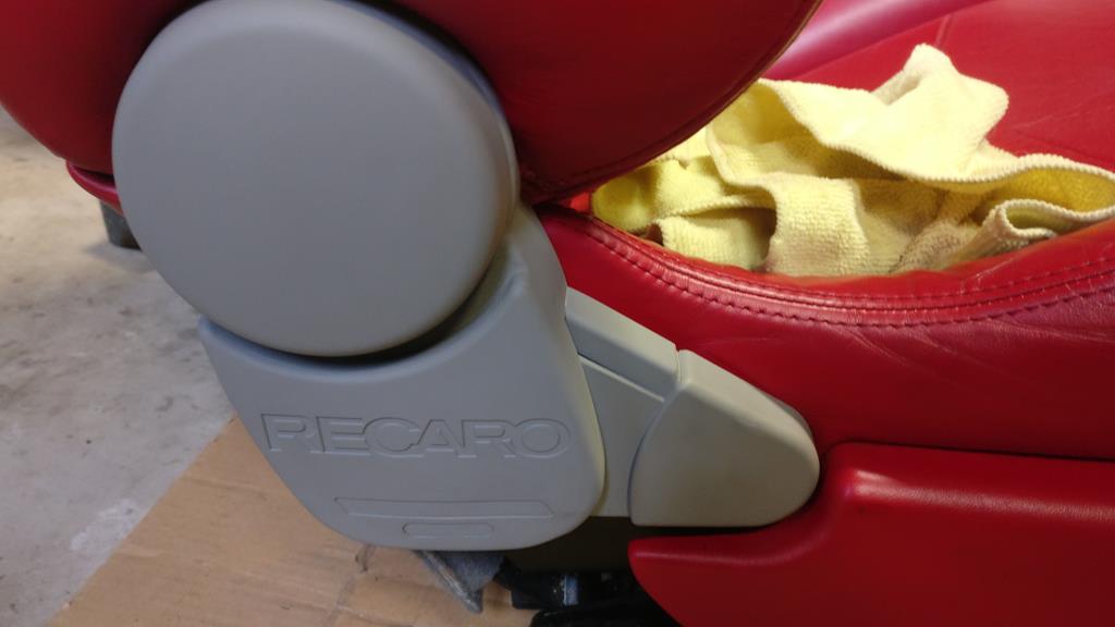

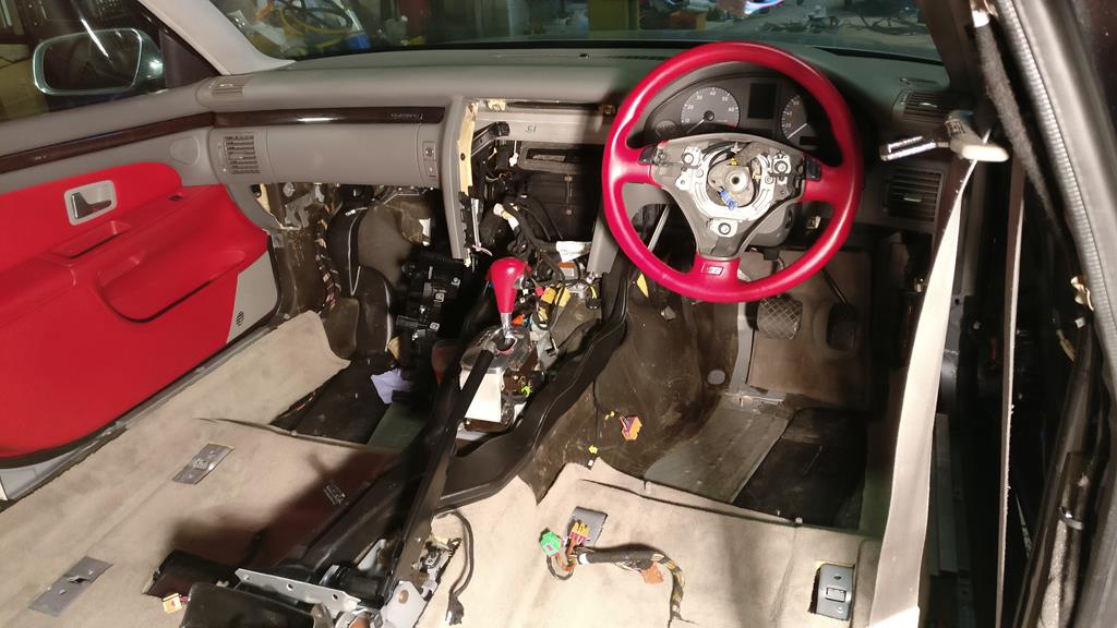

Finished off the seat with another quick clean, then treated with leather conditioner. The plastics cleaned up nicely too

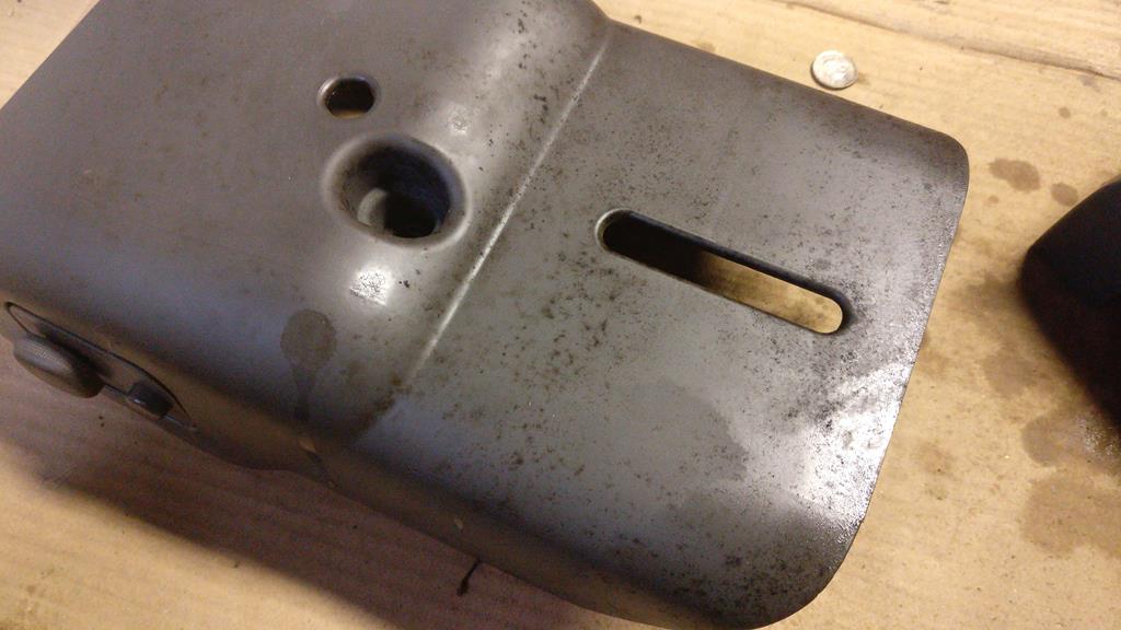

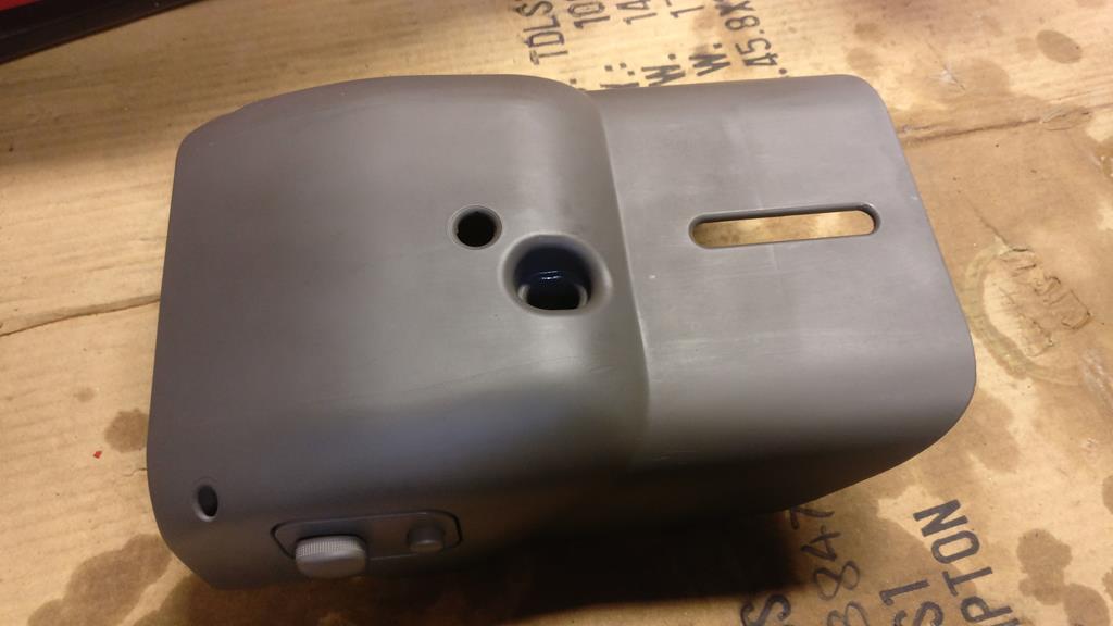

Continued cleaning the dashboard. The column cowling was also a bit grubby
Special sauce cleaned it up nicely

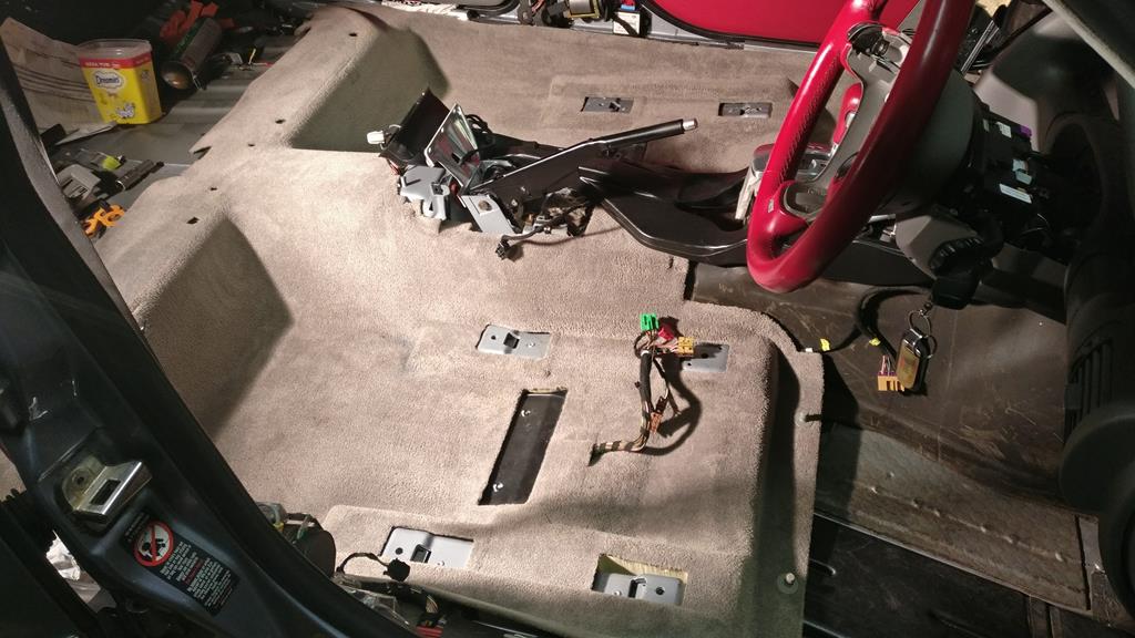

Put the carpet back in so I can put the dash back together tomorrow

So the dash needs to come out to get the carpet out?
Not the whole dash, but everything in the middle of it as far as the heater box. Radio, hvac panel, centre vent, the radio cage, then everything in the centre console. Of course to get that out, the glovebox, lower dash and tunnel sides also have to come out, so pretty much all that's left is the dash top, steering column, cluster and heater box.

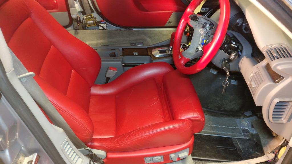

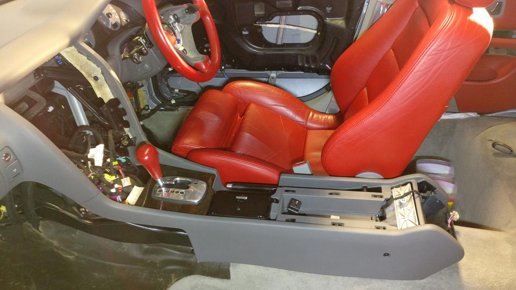

This is the extent to which one has to go to get the centre console and therefore the carpet out:
Only 1/4 through cleaning the seats but I put the console and driver's seat back in to clear some space, and also to feel like I'm making some progress
Centre console, with the wood trim for the shifter in place as that can only be fitted or removed properly with the console loose, and also the cubby for the menu button (without it's wood) as one screw of that is under the shifter trim
The rest of the wood will go on after polishing. Its slowly becoming a nice place to sit again though
