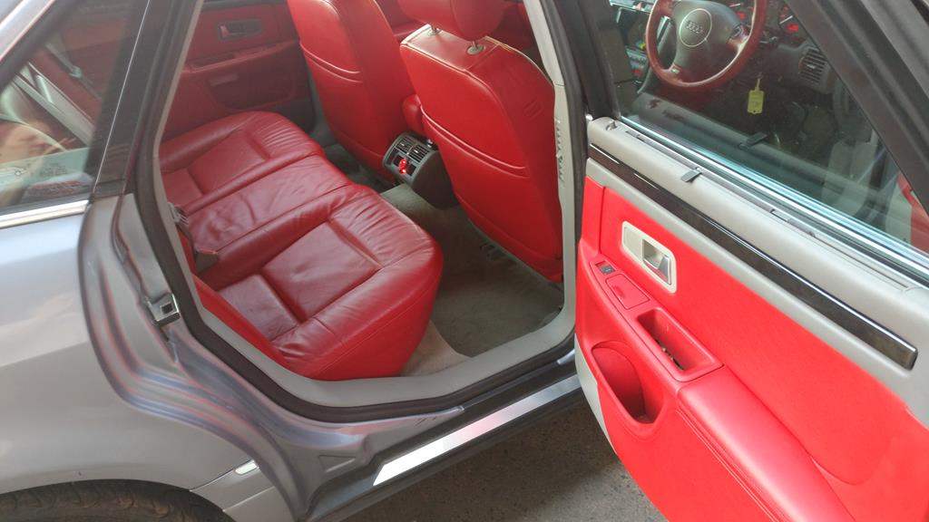

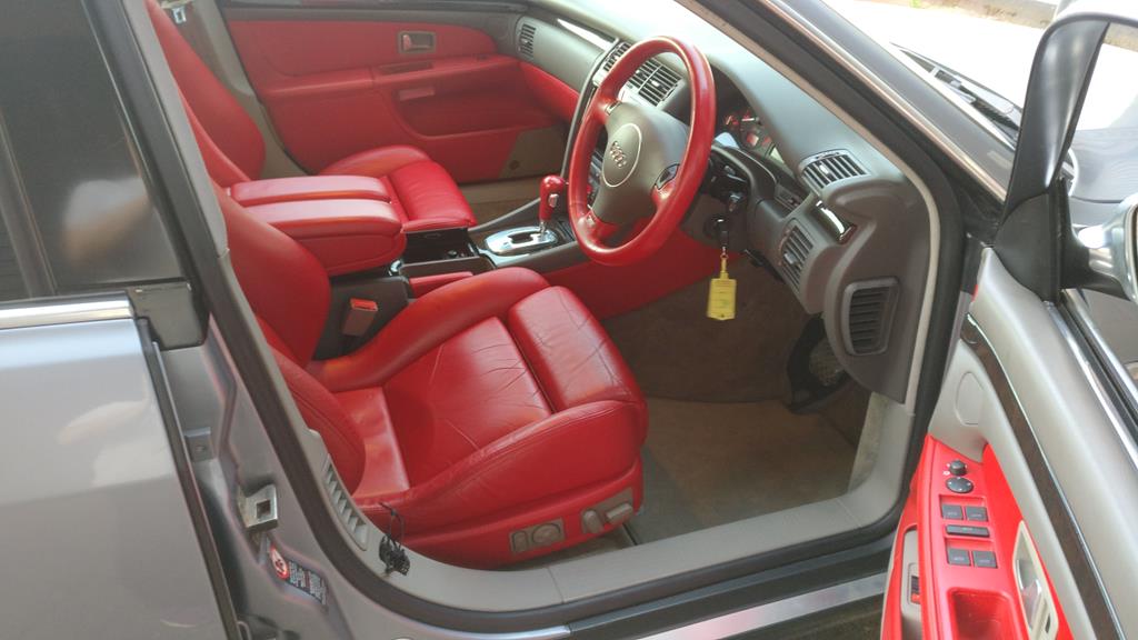

Sooo much cleaning...
But, after many hours and late nights and the interior is 99% back together

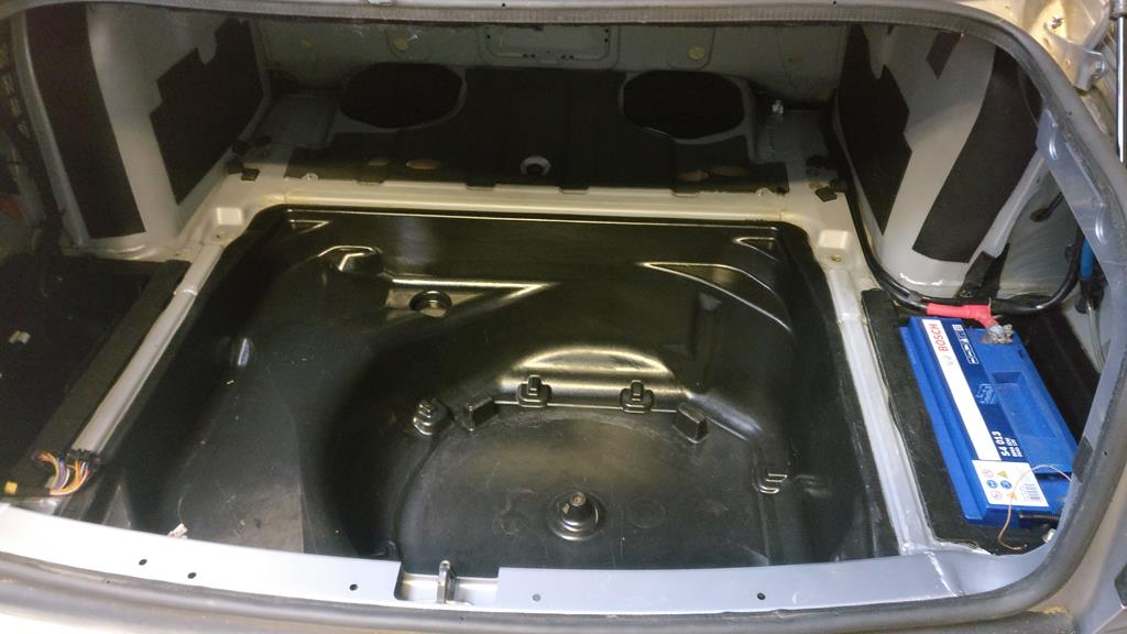

I deep-cleaned the boot as well because that was smelling rather musty. It has a water leak through the tail lights I think so they need to come out and be investigated.

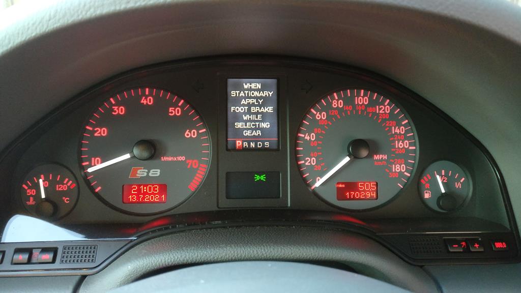

No error lights!!!
Ready for MoT tomorrow
142 hours
Parts used:
PS hoses (refurb, £200)
PS hose brackets (used)
NSF upper rear arm (used)
NSF lower rear arm (used)
NSF wheel bearing (used)
CV boot (£12)
Suspension brace (used)
Boot lid (£150)
FE wheels (£500)
Window motor (£50)
Headlight level arm joints (£15)
Radiator (£300)
Belt idlers (used)
Accessory belt & idlers (used)
Snub mount (£60)
Air filter (£6)
Wiper mechanism & motor (£120)
Air box trim (£10)
Intake duct (£10)
Bumper (£200)
F125 (£1)
Exhaust clamps (£30)
Boot grommets (£15)
Brake fluid (£20)
Wiper trim (£50)
Platinum carpet (£25)
Central locking pump (£60)
Lateral Acceleration Sensor (£20)
N/S seat belt (£18)
Potions and microfibres (£120)
Wiper blades (£30)
Bosch S3 019 battery (£85)
