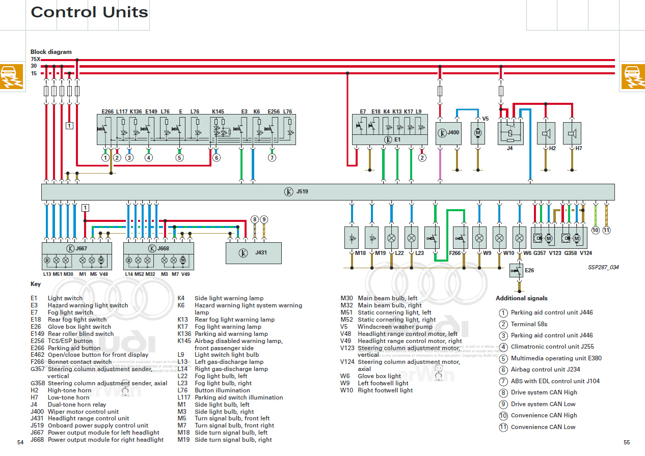

Default Is J519 control unit responsible for bulb warnings?
If so, could the firmware be modified so lower wattage lights can be used without issuing a bulb warning?
