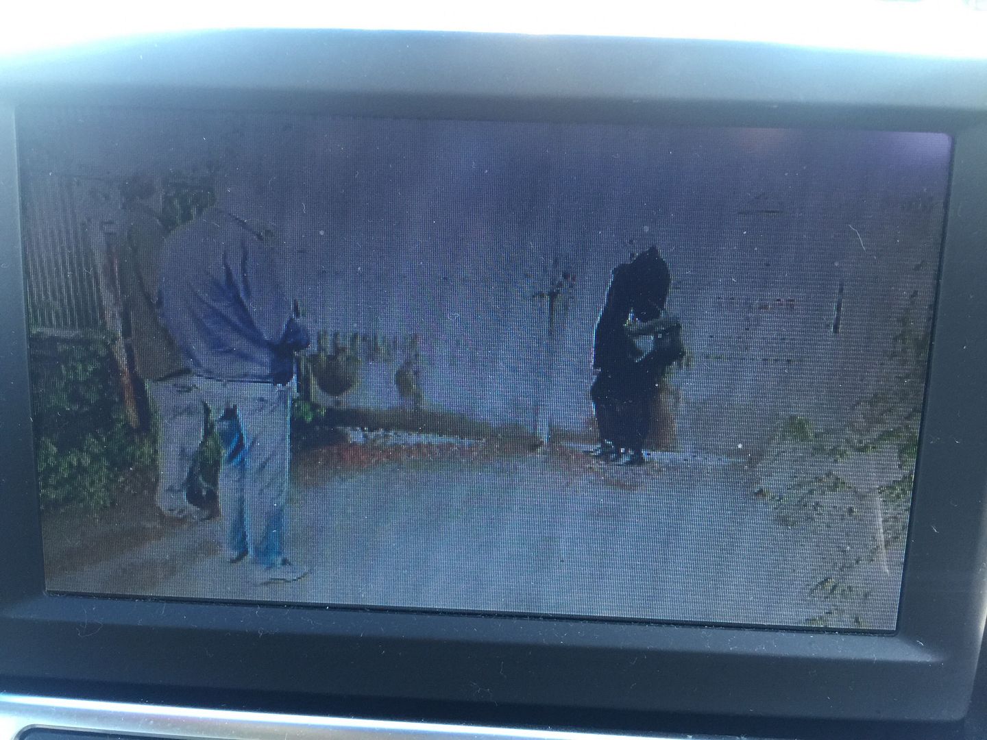

Can anyone shed some light on why my picture is very pale on the screen? I'm not sure yet if it's an aerial issue and as per my other thread I've a S/H replacement turning up for that, one other thing I can think of is maybe give the most connections a clean with some isopropanol and make sure their spotless, does anybody know what controls the picture? As normal the screen is vibrant, it's a bit hit and miss when on TV and this is what makes me believe it's a signal thing but then it's a digital signal so kind of scratching my head

The settings all seem to be fine, ive tried adjusting the picture but it makes naff all difference, I'll get a photo in a bit and post it.

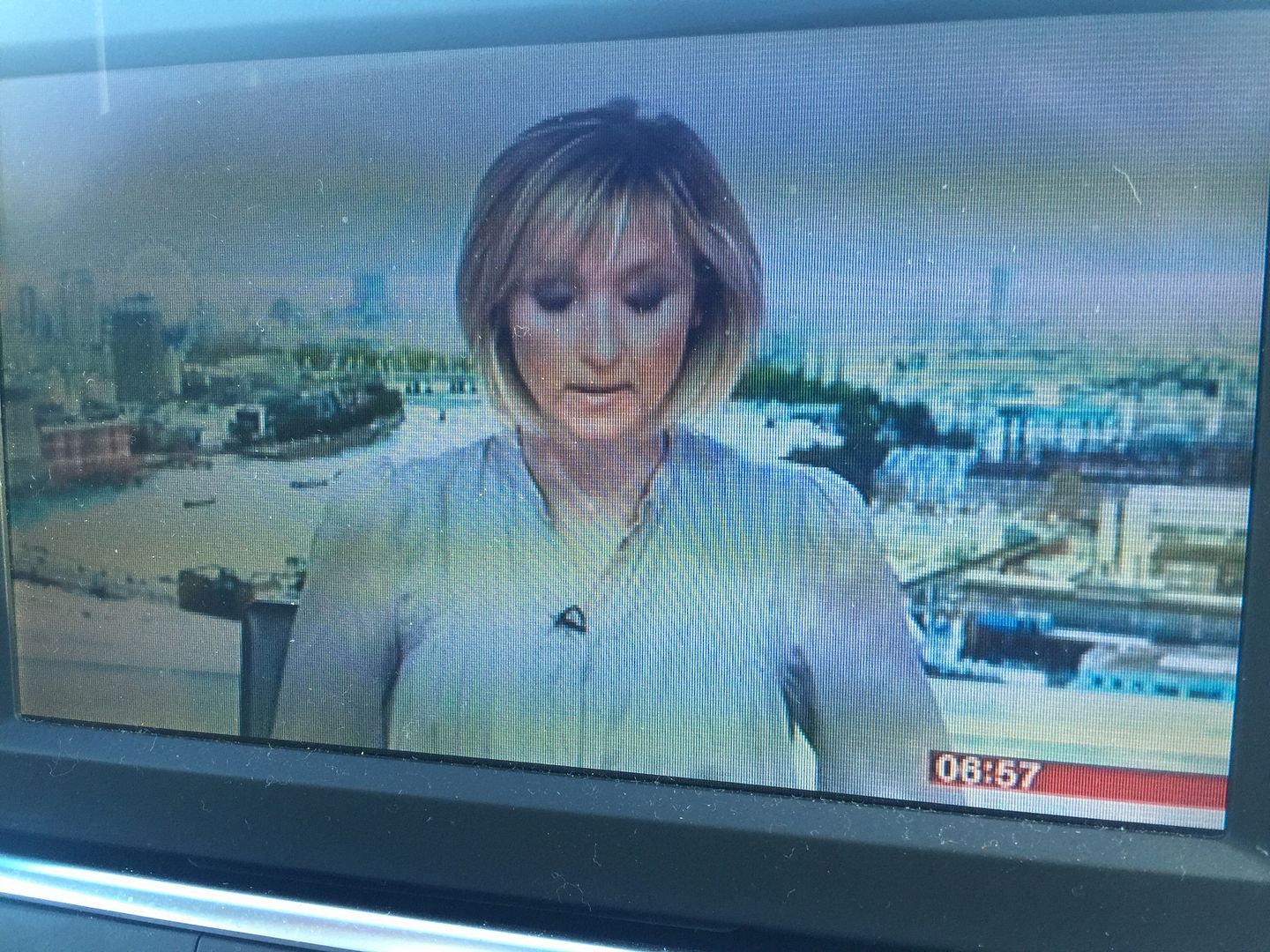

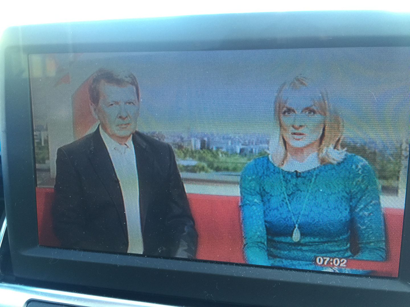

My own car is mugging me off out it on this morning and it looked fine, I took a picture and it was a lot better.
But as I type this it's as if there is a white balance issue, as bright parts of the screen get washed out, messing with picture settings is getting a bit better but still doesn't seem right, I might just be being really fussy

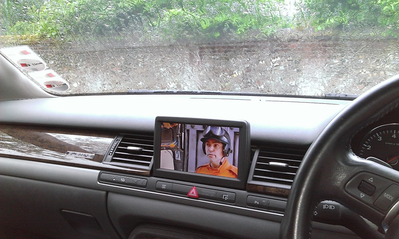

I also agree with Manny. If it were a reception issue the picture would break up and the TV would display an orange icon in the top right corner, I think with an black X. What is the picture quality like when you try to read EPG info? Still the same? Then it certainly is the FBAS (Farb-Bild-Austast-Synchron-Signal or in English CVBS, Colour-Video-Blanking-Sync) connection to the control head. However, do play with the contrast & colour settings etc, etc.
I've found the TV to give pretty good results. This was when it bucketed down so I took refuge watching Scrapheap Challenge
