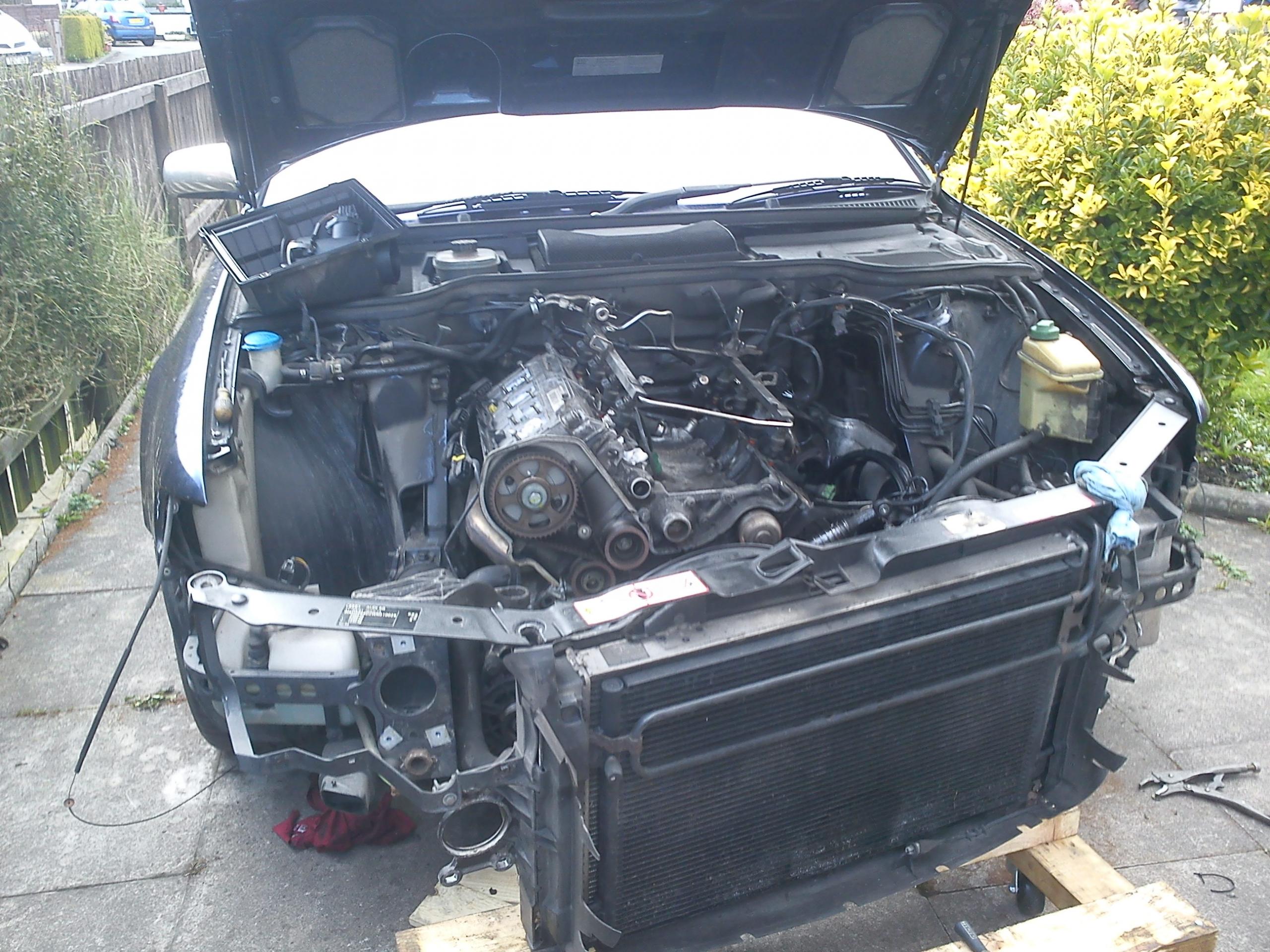

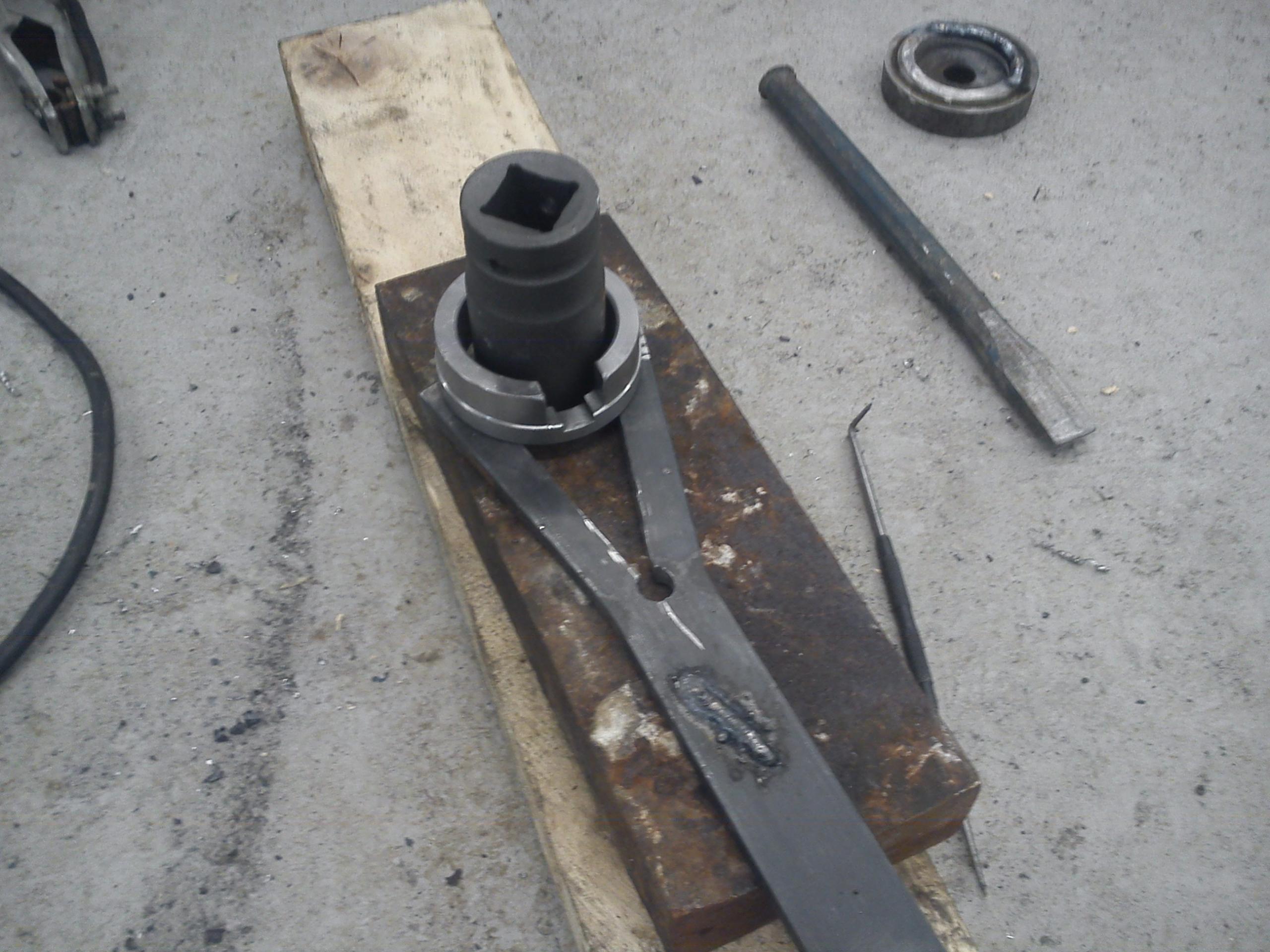

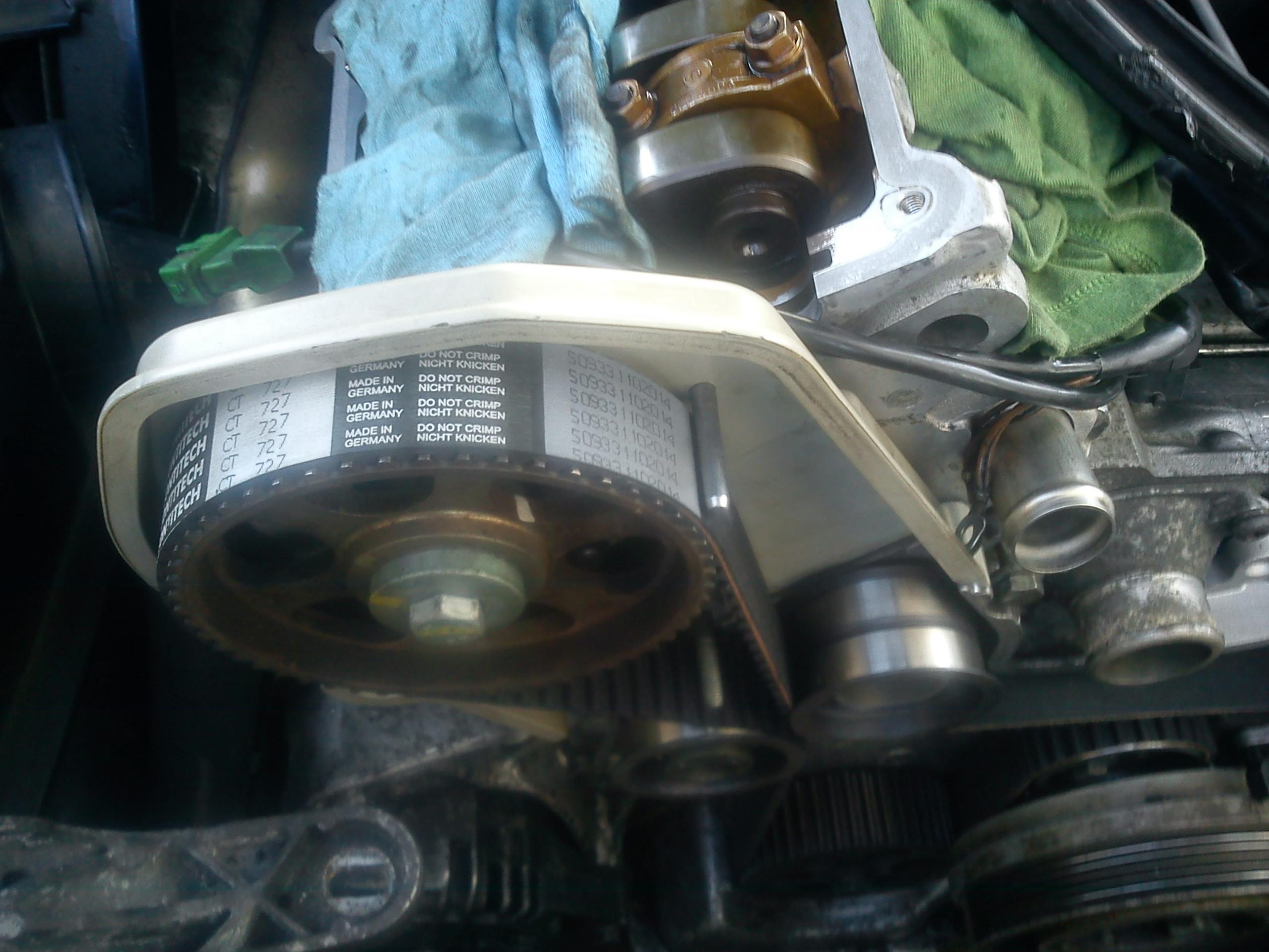

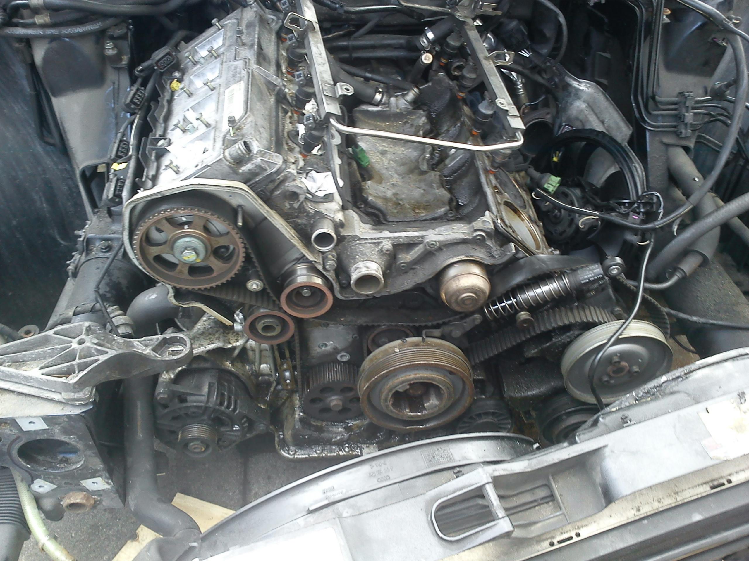

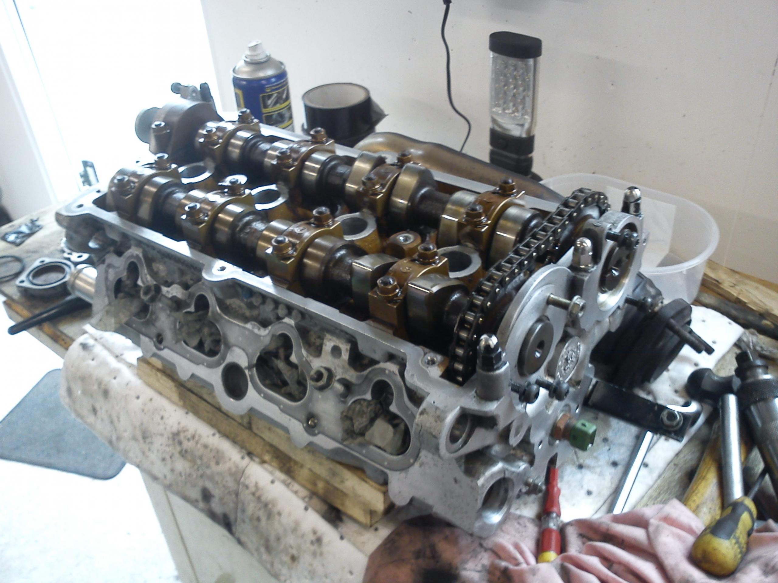

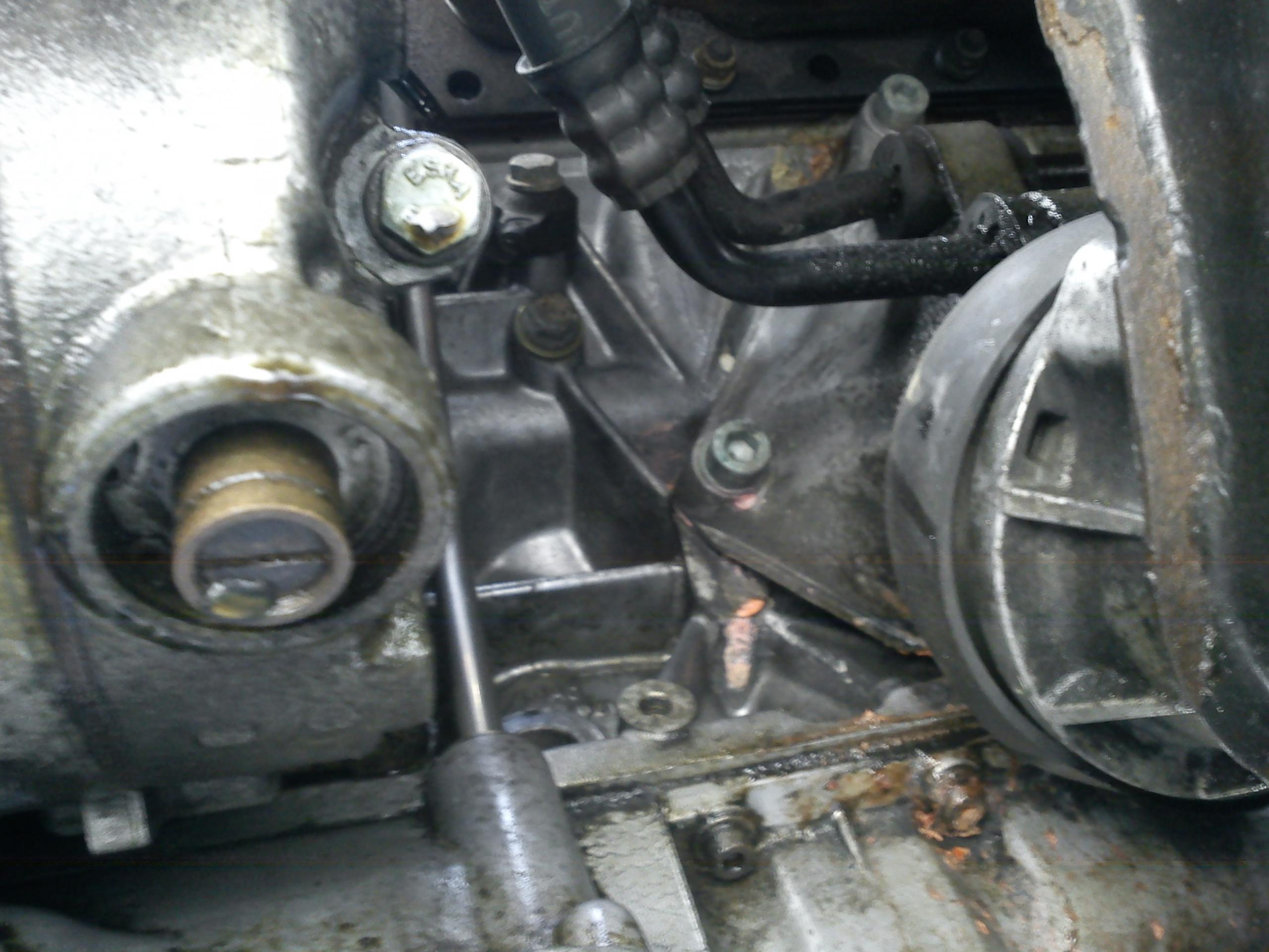

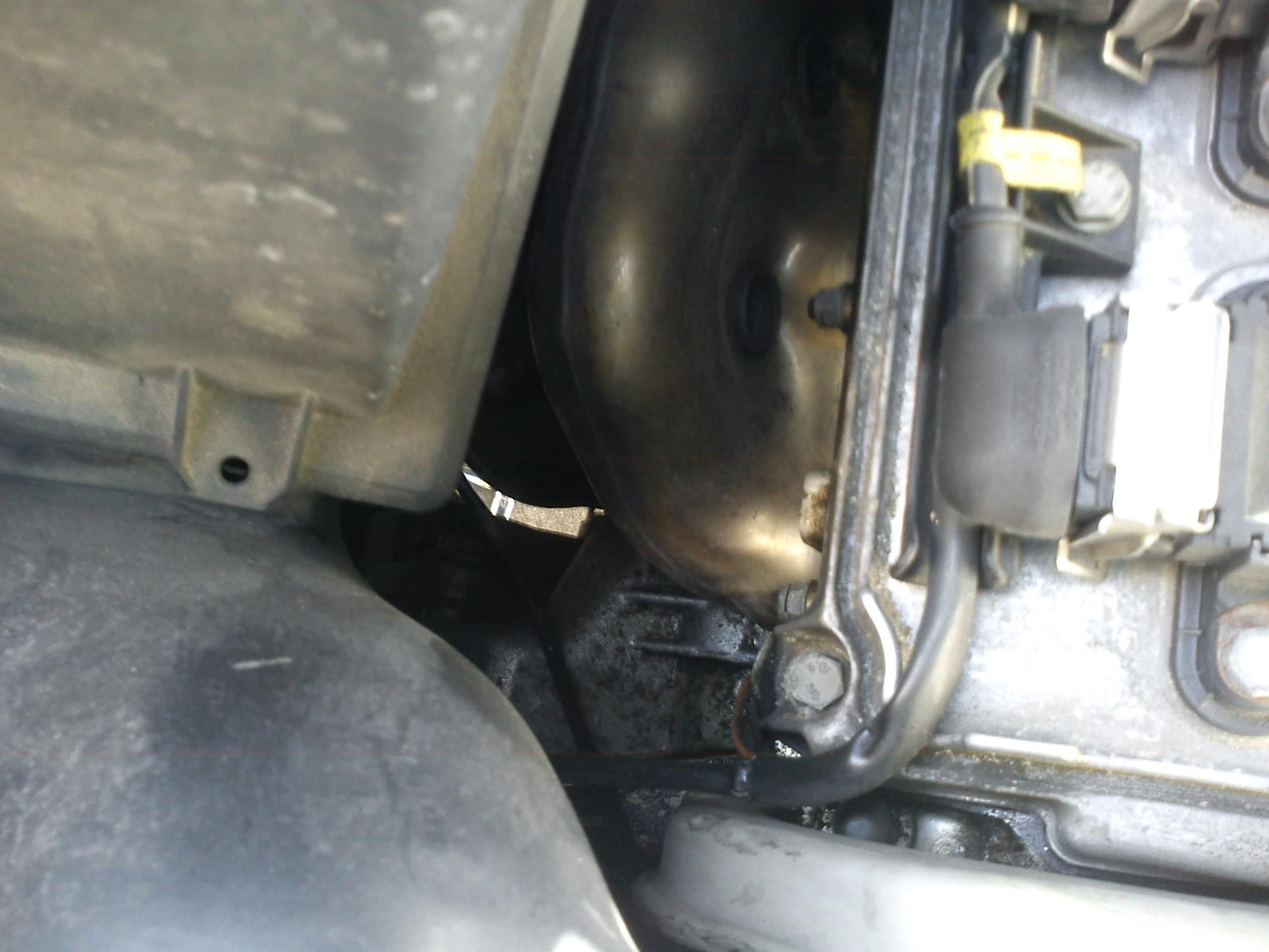

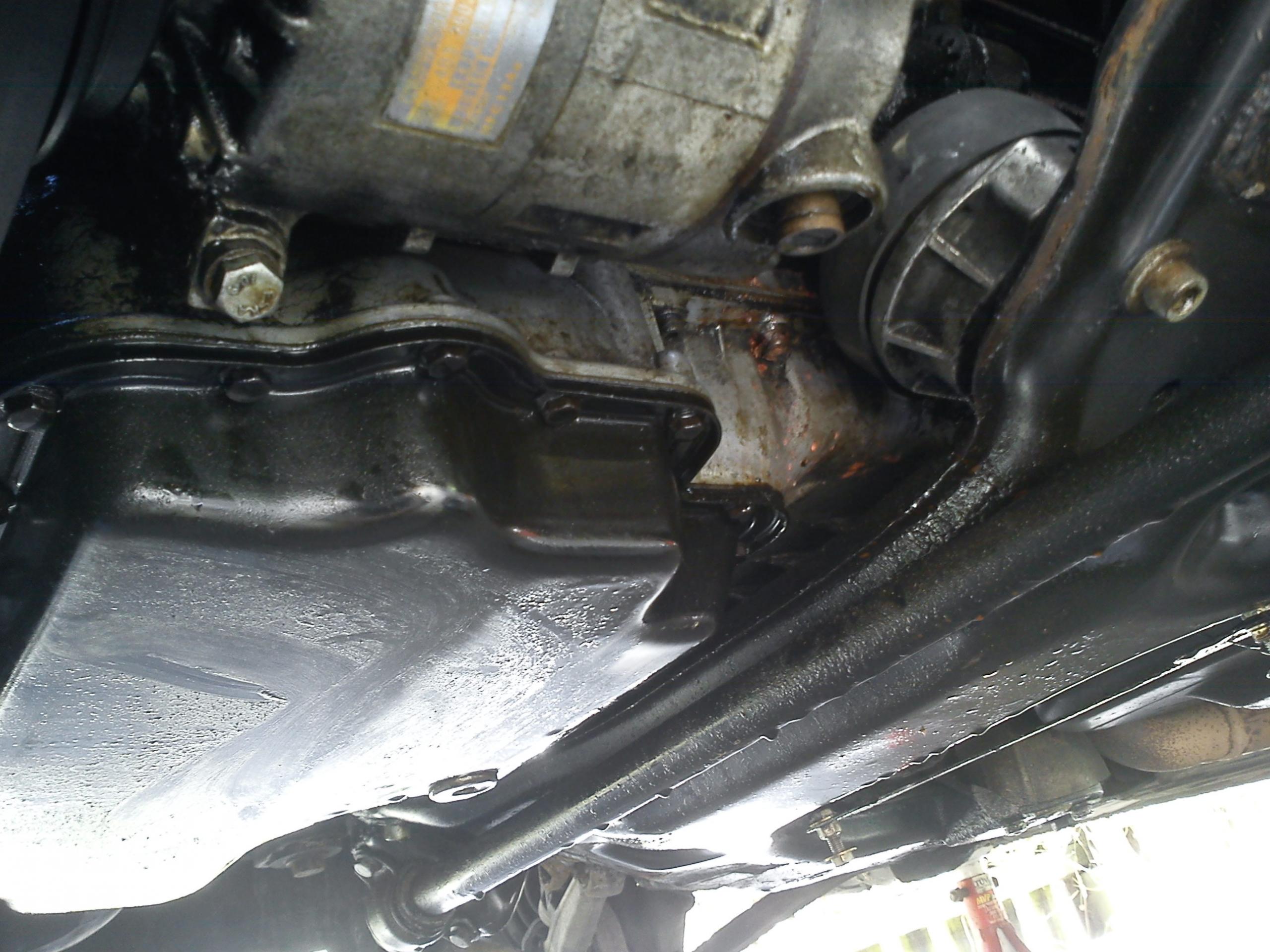

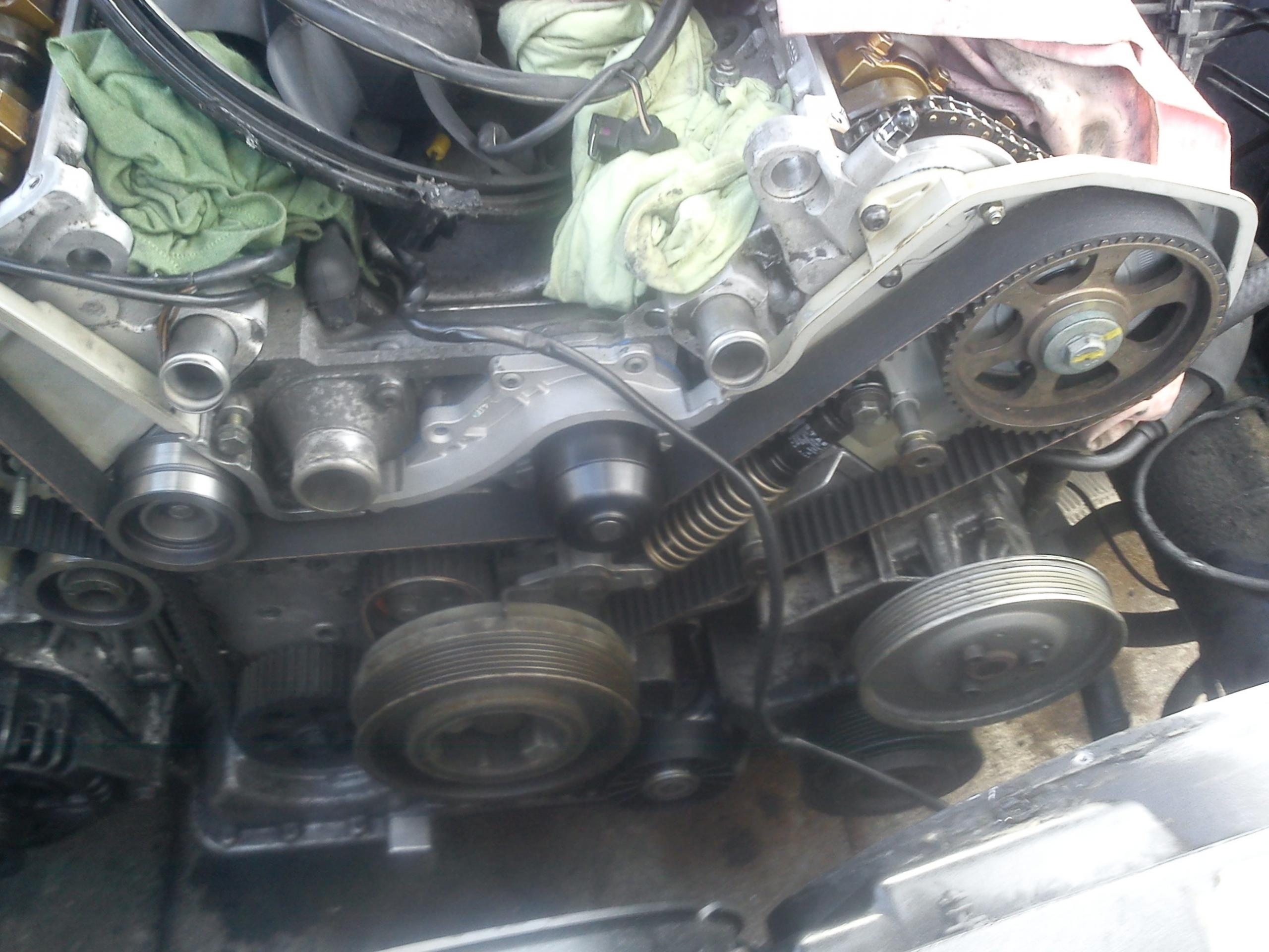

Having wrecked three driveways (mine, my parent's and my last house) I bit the bullet over the Easter break with the brief of sorting the oil leaks once and for all. The only gaskets I was unable to change were the transmission end crank seal, the secondary sump gasket - couldn't see any way to do this without lowering the sub-frame - and the oil pump shaft seal since I didn't have a replacement bearing. In the end, I think the primary culprit was the "slinger-ring" type seals between the cylinder head and the inboard timing belt covers just behind the camshaft pulleys, these regions were soaked with oil.
The rear camshaft seals on the 32v engine feature one radial shaft seal on the nearside serving the hall-effect sensor and two chocolate "slinger-ring" seals behind the aluminium covers on both sides. Hope you get to the bottom of it!
