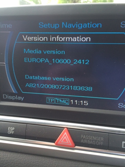

I've had a quote in from the dealer of €357 to upgrade the Sat Nav...eeek...
The map itself is pretty outdated tbh and i'd love to upgrade it...but I'm not 100% sure how to do it and if I'd need any discs to upgrade the MMI first? I've seen the packs on ebay but again i'm a bit nervous in case I screw something up...
I took a snap of the map version this morning if anybody has any thoughts, it would be great...cheers....

Hiya
That appears to be a 2009-10 map DVD you've got there?
Assuming you have MMI 2G, which is what it looks like, you just need to swap the nav disc and it will run a small update for the firmware on the nav part only. It doesn't mess with the rest of your MMI.
If you're handy burning media there are many places to download updates. If you're not then I or a number of others can supply in exchange for some beer tokens (and a hell of a lot less than the dealer!)

Thanks Adrian. From the box that came with the car it's a 2007 version.
How would I check if it's 2g?

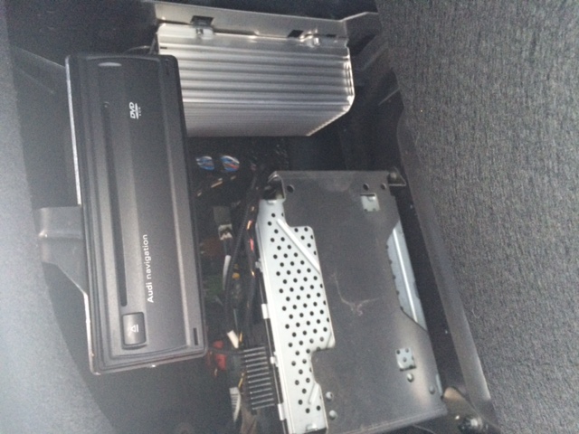

If you've got a nav drive that takes DVDs then it's 2G - later cars get HDD nav, eventually!
HI Adrian, took a snap of the unit..so I'm guessing this is a 2G.
Also, i saw the other unit and I think this is the TV tuner? Which is weird because whilst I can get TV audio, i can't get Video....Click image for larger version

Old 7th August 2015, 04:01 PM
That's the 2G Nav unit.. Backup copies of the discs are available on the internet, though obviously you would still need to buy the original from Audi to have the proper licences, and remain legal and all that stuff *ahem*
If you get TV audio, then sounds like you have a DVB tuner, have you tested it without the engine running, if I remember rightly, my PF had an issue where the speed limiter had been set to 0 initially, so it wouldn't show TV if the car was running. There are plenty of tools out there to turn on TV in Motion, though you need VCDS.

Im guessing you are in Southern Ireland as your dealer price was in Euro.
If so, the TV signal is now MPEG 4 since Saorview was launched. To my knowledge this makes your TV tuner obsolete which is why you can only pick up audio. This is a common problem on BMW's of this era also.
On the Nav Discs, I have previously used several backup copies from ebay without issue.
I wouldnt bother with the MMI update unless you are having issues.
