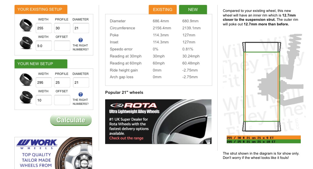

Hi Mark
As you have suggested you will need to ensure that the front and rear rolling radius's are as close as possible. I run 21" staggered wheels on my D2 and the fronts are 255 30 21 on 9" wheels but the rears are 295 25 21 on 10.5 wheels and I think your rears will need to be 25 profile rather than 30 to give the same close rolling circumference. Size wise the 21's will fit ok under D3 arches but you need to check the offset to see how the wheels sit in the arches and how far they come out towards the arch
Old 25th October 2015, 04:37 AM
As you can see the front to rear difference is 0.81% and you are Looking for the difference to be less than 1% to make sure that you don't get quattro issues due to differing rolling circumference you would therefore need to change the back tyres to 25 profile instead of 30 to achieve this.

This graphic shows the difference if you don't change the rear tyres to 25 profile - over 3.3% difference which would throw up quattro faults where the car is thinking that the rear and front wheels are rotating at different speeds and assume that they are slipping etc.
If you can tell me the ET on the existing wheels you have and then the ET on each of the front and rear new wheels then it will be possible to see how changing them affects how the new wheels line up in or out towards the arch

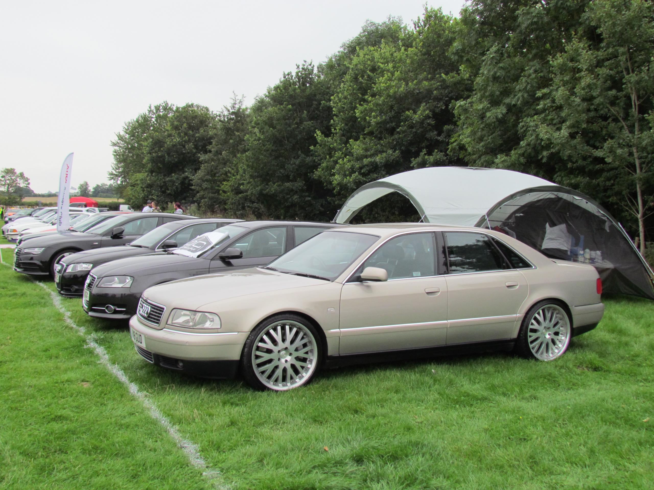

heres a side view - and as others have said, its a percentage of the width so thats why it doesnt look odd. my car also has coilovers at the front so the front is much more lowered to try and get rid of the huge arch gap you often get at the front with D2's
