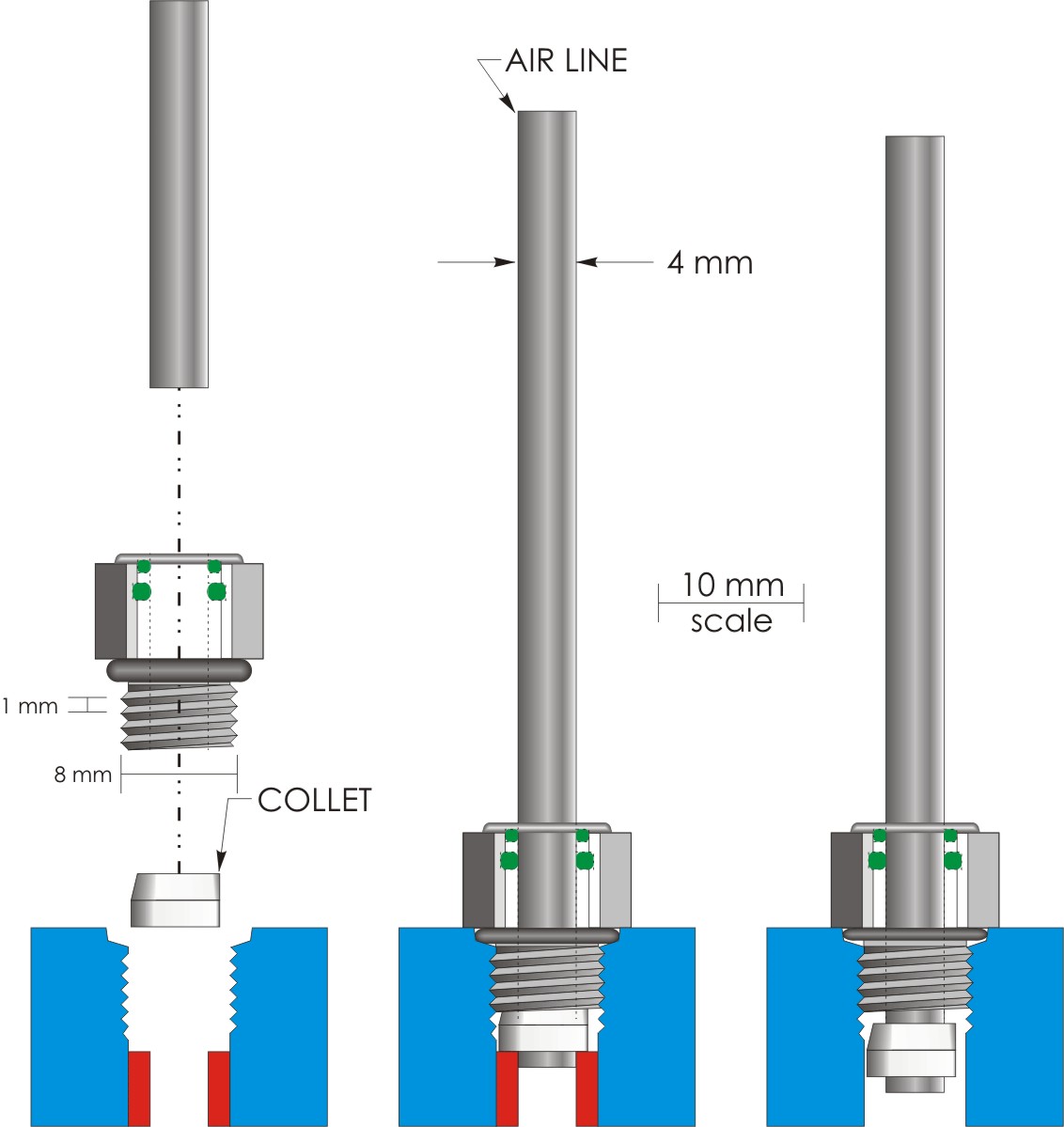

Good to know. I found this diagram of the above photo.
Also the writing on the Air Line is "Voss DIN 73378 4x1 PA12 PHL A1 A5381 EPM 559 R2"

So can assume then that when the connection is tightened in, that the "collet" does in fact open a valve allowing air to flow?
