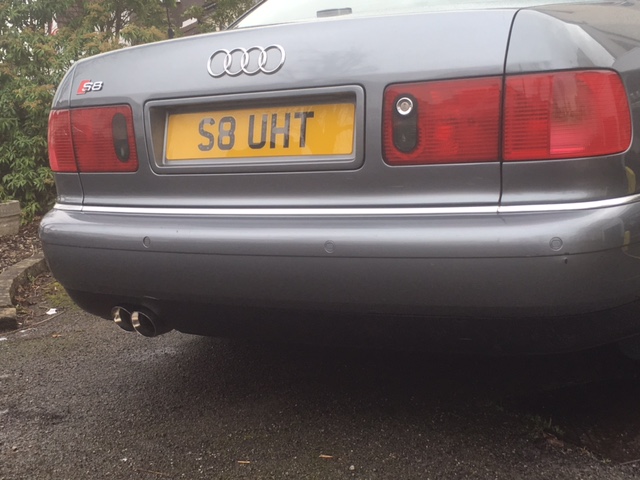

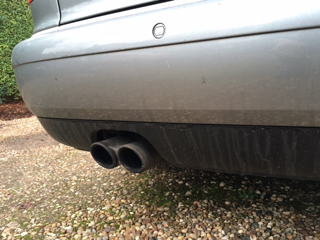

So here's the before for comparison. Bit small in my opinion too for a car of the D2's size...

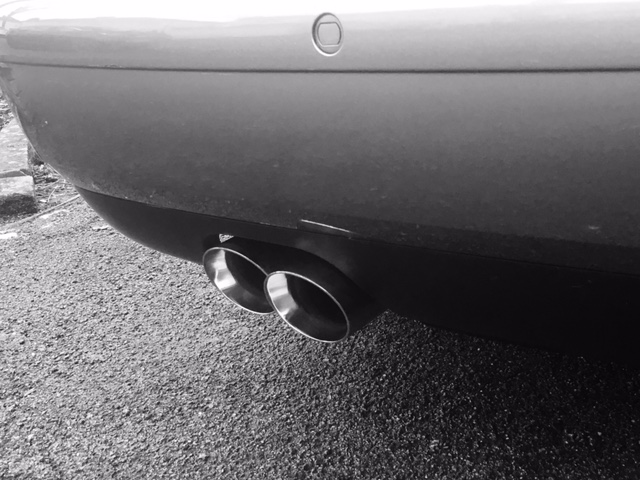

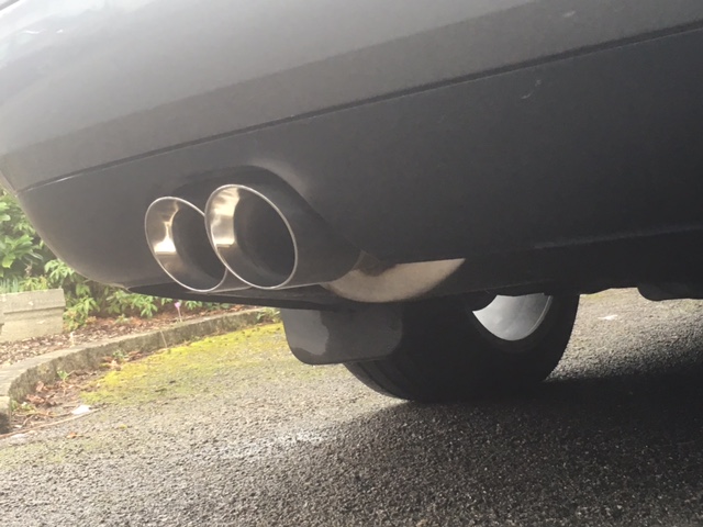

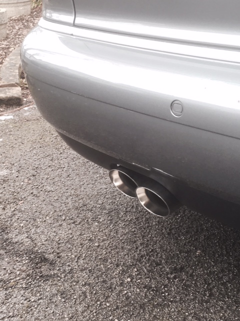

And here's the afters. In terms of sound it's noticeably deeper. A nice burble, especially on full throttle. I do quite a few longer trips for work and I specifcally didn't want it to drone on the motorway, which it doesn't. Just a nice meaty sound, as it should have sounded out the factory in my opinion...

Looks nice and shiny Are the tips of differing lengths to follow the curve of te bumper? or is that a trcik of perspective ?

They are yes, to follow the curve of the bumper as you say. Reality is, the bumper isn't as curved as the offset in the tailpipe is, so one does protrude further than the other but it still looks good. Wouldn't look right if both the same length!
Wasn't so shiny before I cleaned them today although they've polished up very easily!
